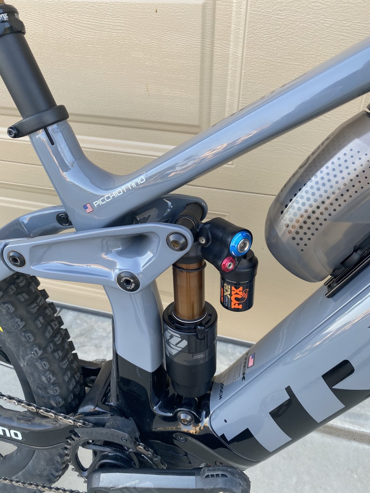

what amount of travel do 60 and 65mm stroke shocks give, and what shocks are available in these sizes?
I may swap out the deluxe on my '21 9.7 XL.
Does the stock deluxe 57.5mm able to become a 60mm by removing an internal spacer?

So the stock deluxe that comes on the lower model rails, can an internal spacer be removed on it to bring it to 60/62.5/65mm?
I’m debating between adding a meg meg and longshocking the deluxe or swapping it out for something else.

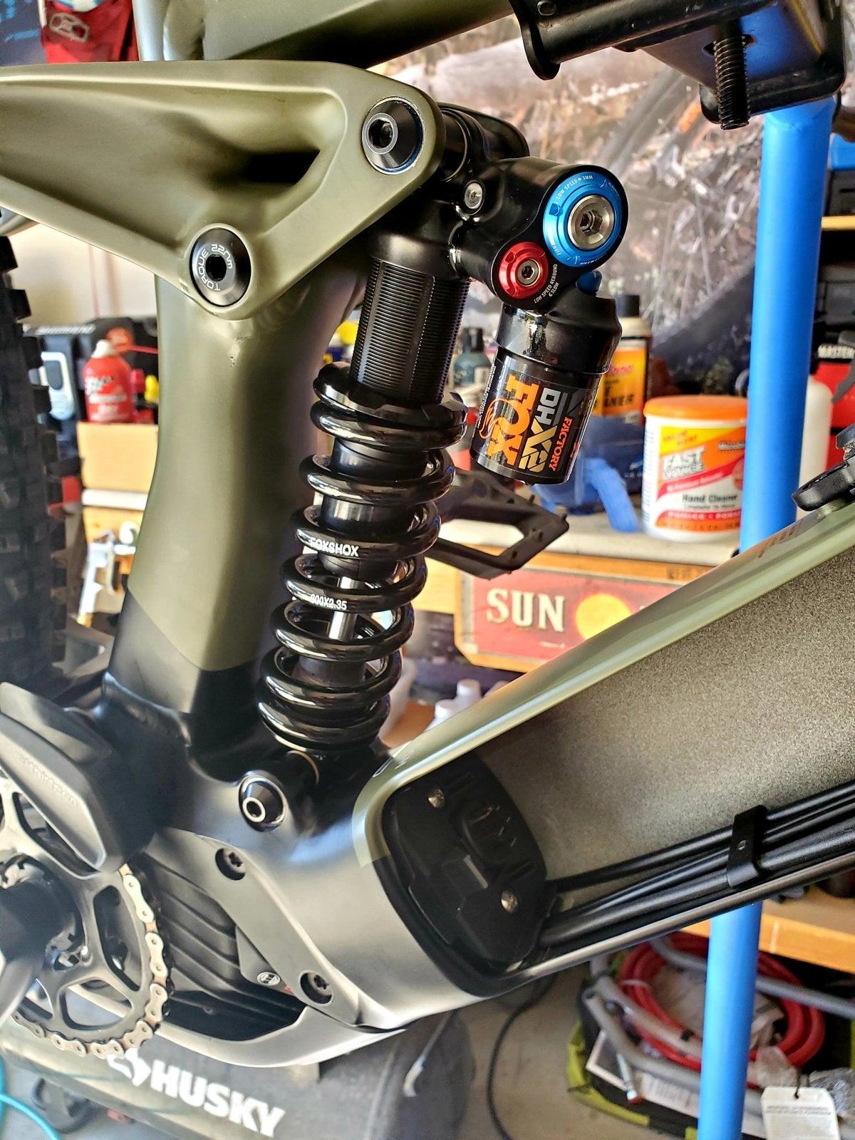

Got finally the mounting hw for my coil shock. Two alternatives to install DHX2, either use 10 x 40 and 10 x 54 Fox mounting kits or press 12,7mm du bushings and use the stock shocks mounting hw. Both will work. View attachment 24335

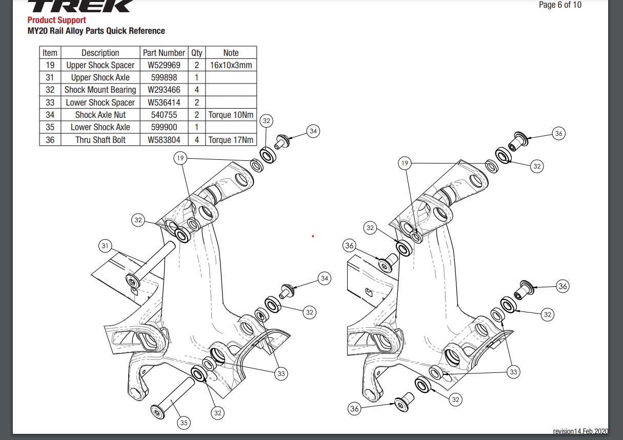

Hi,
Would you happen to notice if the upper and lower shock thru bolts are the same length? One shop told me the bolts are the same, trek says they are different... Im ready to change out my reaktiv shock for a coil but having trouble to find the shock thru bolts...
