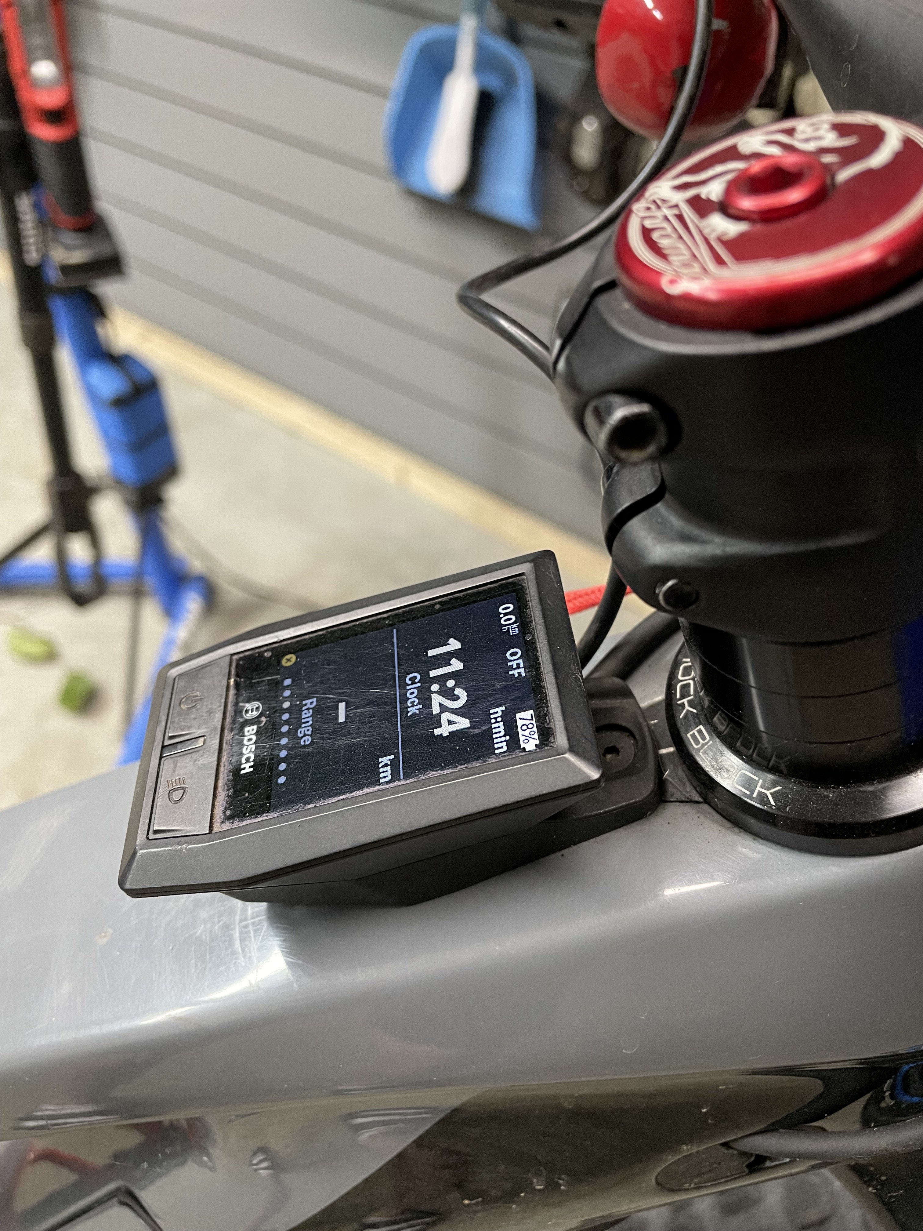

The Kiox upgrade was the first thing I did when I received my 2020 Rail. The display unit (computer) was magnetically mounted to the stem. I eventually moved it to the upper tube (different mounting) and tethered it to some cabling.

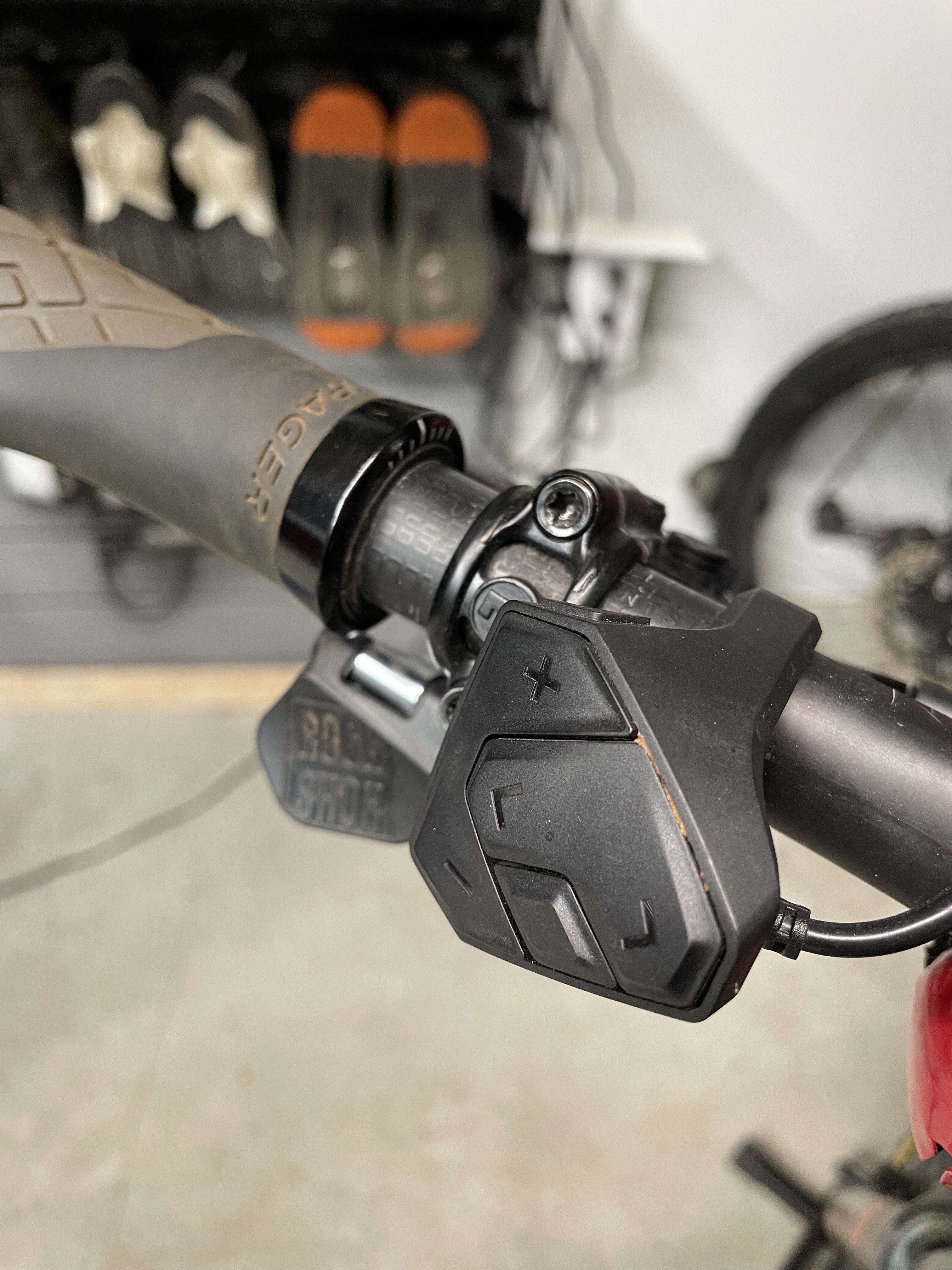

I also fixed the controller to a lower position on the bar to protect it…when I go OTB. The new Gen Kiox position seems a little better. You’ll like the upgrade …but my main Kiox page is the clock. (Tic Toc). ⏱️

This is the Kiox I’ve had for almost 4 years. It was mounted to the stem but I changed that to the top tube after it got knocked off a few times. I also use a short tether. IMG_6351.jpeg
I liked that it can be knocked off , but now I tether it so it just falls next to the frame.

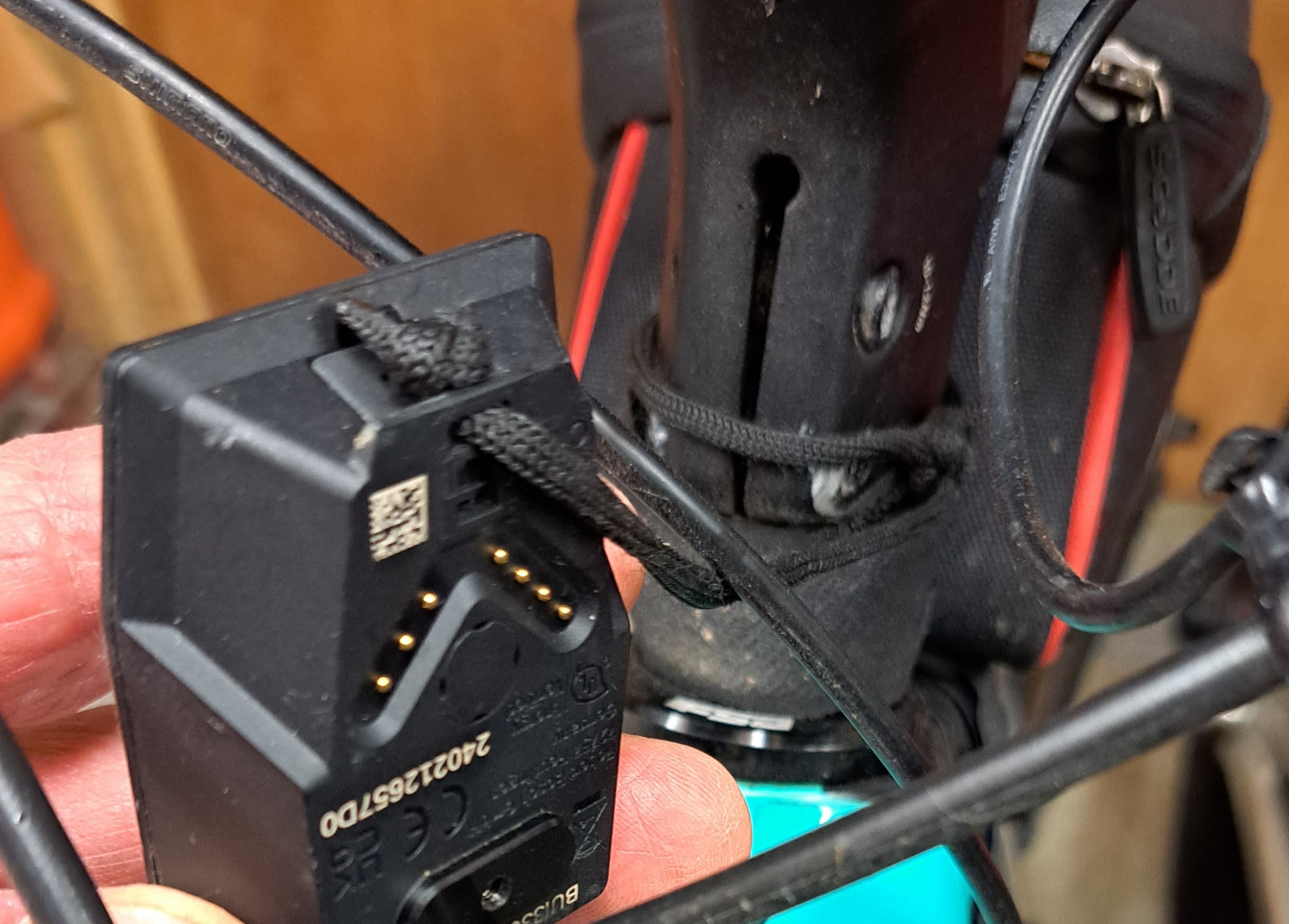

I've crashed and the Kiox display came off, so I threaded some thin cord though the slot at the bottom of the display and tied the cord to the stem. In your picture the obvious place to secure a cord is probably to the handlebars.
