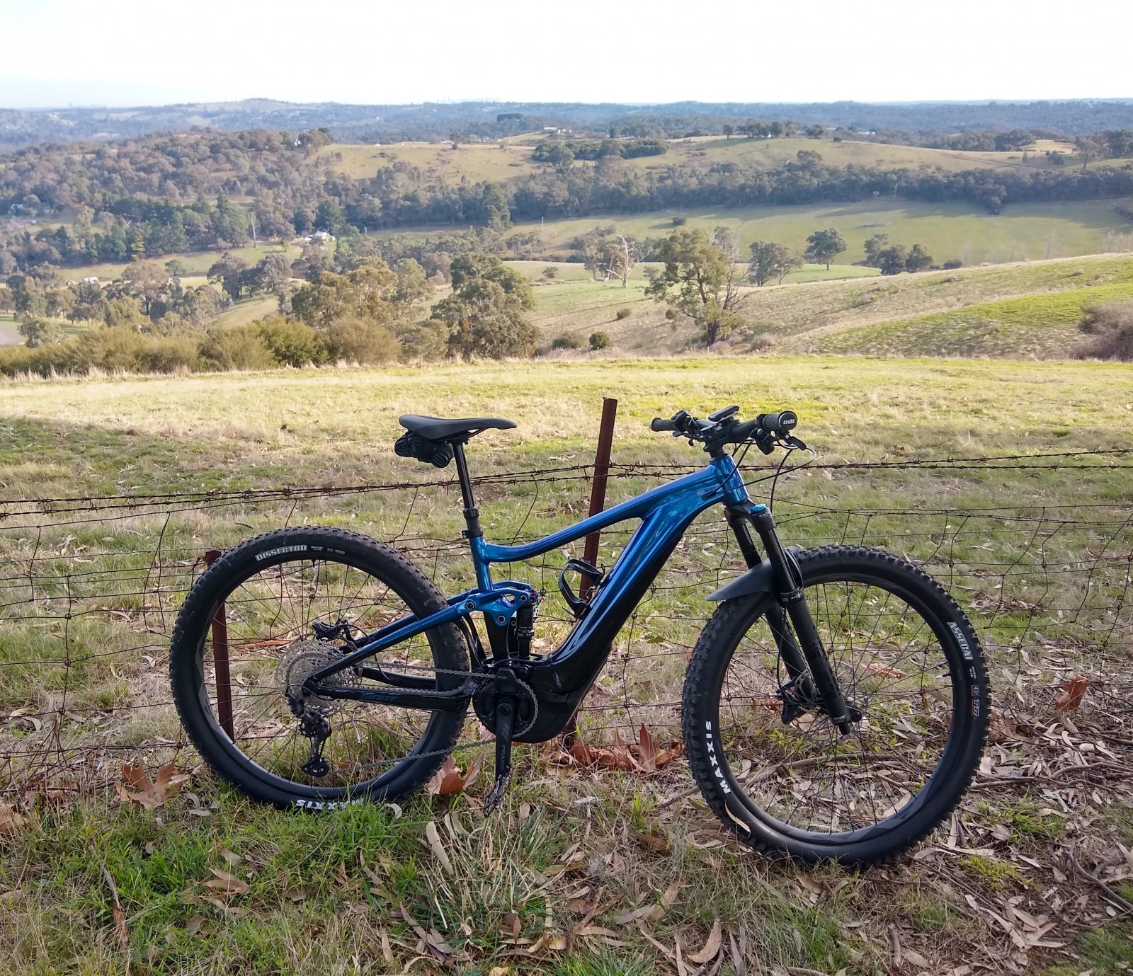

Picked up the 2 this month, it was going for AU$7 300 in my LBS, the 1 had some nice features but not enough to justify the extra cost for me and the blue colour really impressed. I've put XT levers on but am finding the 4-piston MT520 calipers staggeringly good, easily beating 2-piston XTs (and Codes), so I plan to leave them alone. They take icetech pads, too. The 2 is nicely specced with Deore, SLX and XT parts and the 3 would also be a great buy and far beat a Levo for value. The exception is Giant has a 2 year warranty and Specialized has 4.
So far I'm loving it and it generally does better all round than my 2018 Kenevo Expert, which has been an excellent bike, with the exception of the app, which only works if I have wifi and wireless turned off. I only use it to see the exact battery percentage, so this doesn't bother me.

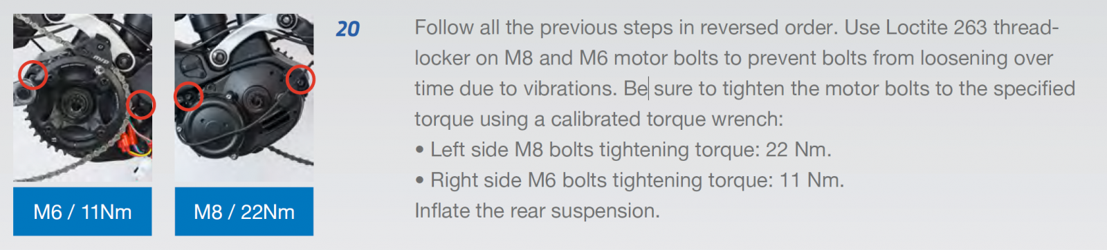

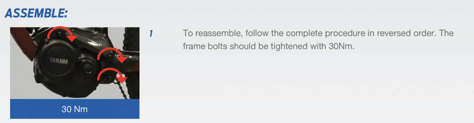

Does anyone know torque specs on the motor mount bolts....I had some creaking I could feel through the pedals and realized some of the motor mounts had come loose

There is a manual in this thread. It has a procedure for battery adjustment though using a special tool. The basic operation can be done through trial and error until you like the fit.

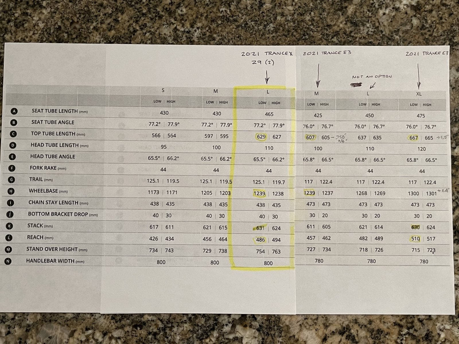

Hello, I just sold my 2021 Trance X 29 (2) size L.
I originally wanted the 2021 Trance E+ Pro 1 due to the component specs and color, but I can't get one locally.
Last weekend, I rode a 2021 Trance E+ Pro 3 in (M), the cockpit seemed cramped, but I didn't have my riser bars on it and
it was shifting poorly, so I wasn't completely focused on the test ride. I also have an (XL) as an option (didn't ride it though).
(note, I had trouble seeing the white lights that indicate what power level I was in).
I also had the chance to ride a (L) 2022 TRANCE X ADVANCED E+ 2, which was shifting bad as well. I kept feeling this lag
between shifts in all modes, so the sales guy pulled the app out and put all the settings in all modes to 100% and it fixed it (weird huh).
Honestly, I don't need Carbon, if available I would simply get the Aluminum 2022 TRANCE X E+ 3, but the regional rep
has no idea when I could get my hands on one.
So my question to you guys in this thread that own 2021 versions, knowing what you know now, would it be worth the extra
$1500 (new motor, new ride controller display and carbon) on the 2022 TRANCE X ADVANCED E+ 2?
Thanks in advance..
here's the geo numbers from the bike I just sold and the medium and x-large options for 2021 version,

It sounds a bit confusing, you talk about med and xl i will give my opinion on that.
The shorter the better. It is easy to put a longuer stem for a few $.
Thanks in advance..
here's the geo numbers from the bike I just sold and the medium and x-large options for 2021 version, View attachment 86526
Hi, I have had 2021 trance x e pro 3 for over a year now, I was so impressed with it I bought the Advanced version 2022 last month.
I found the motor performance was weaker than the 2021 even after app tuning and also a screeching noise from the motor That I couldn't put up with, so sadly I returned it. Apart from the motor issues the bike was very good, much more lively than the 2021, I did find the controller a little fiddly after the big one on the 21 version which I find quite handy being big as when I get myself in trouble I can just spam the power button to get out, which I found awkward on the new one. Is it worth the upgrade ? for me no, because of the motor noise, incidentally, I tested 3 other models in the shop, all with the 2022 motor and they were all the same so its a feature of the new motor. The advanced is deffo a step up from the 2021 but the difference is not night and day. I think if your happy with alloy then go for that and spend the £1500 on juicy upgrades t make it your perfect bike. I did axs dropper and shifter on mine, job done.
Just a note, The stand over height figures are printed back to front, ie 715 should be small and 734 large etc

No matter which bike, if you are a size Large, I wouldn't get a Medium or XL... The LBS can normally chase one down by offering a trade (Medium for Large) with another LBS, at least that's what my local shop did to get me the right size bike, Large for Medium in my case 😊
Good luck!
