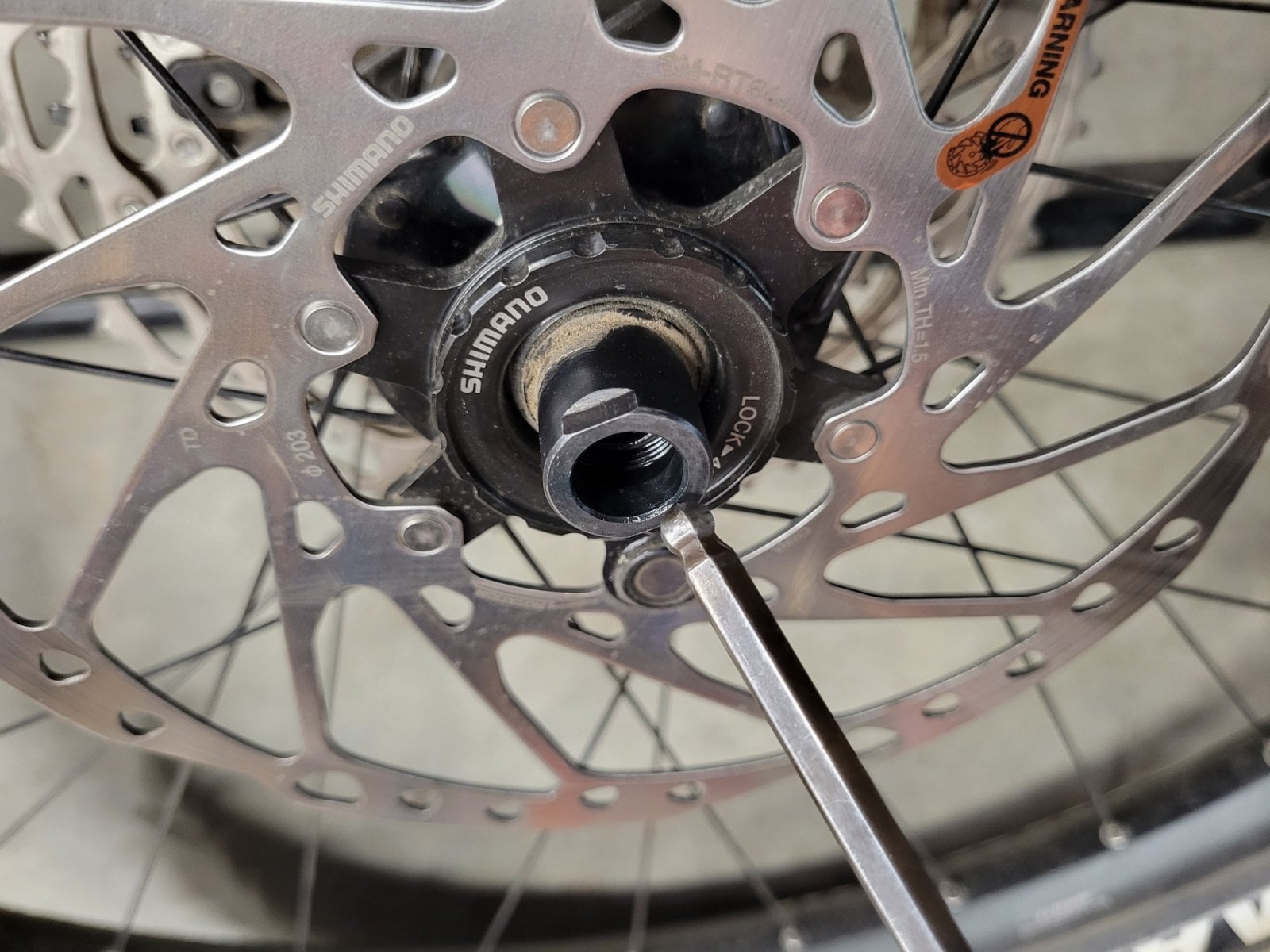

I ran into a small issue with my Trance. An issue with the Shimano rear hub to be specific. I was having issues with the rear brake caliper alignment. It turned out that the brake side hub spacer threads into the hub. That spacer got loose, effectively making the hub wider. Easy fix once I figured it out.

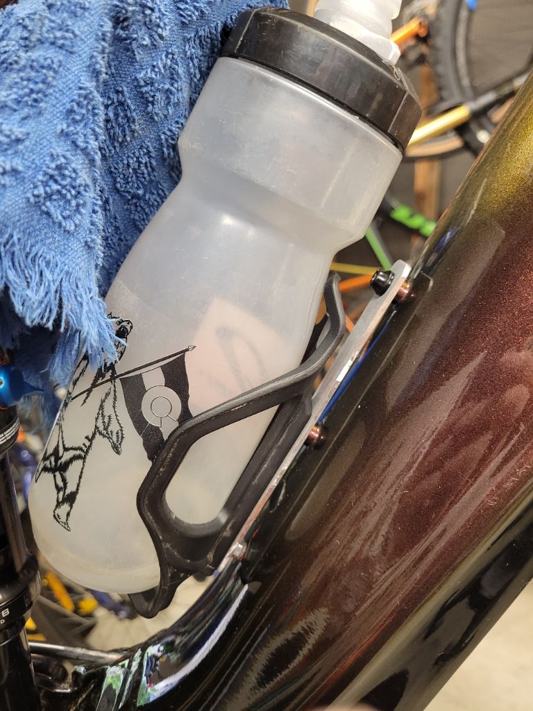

Some things I have found to watch out for on my bike. Suspension bolts coming loose. I check mine pretty frequently, and they seem stable after several retorques. The lower shock mount bolt kept coming loose. I was having to retorque it almost every ride. I put some red lactate on it and it seems good now.
Here's a picture from yesterday's ride.
I also made a water bottle relocation bracket today so I can fit a full size bottle.

Nice upgrades, I put the fox factory dps shock on mine, big improvement over the standard unit, worth a look and cheaper. Although I like the look of the dpx2 it was overkill for my type of riding and I couldn’t fit a full size water bottle in if I fitted one.
