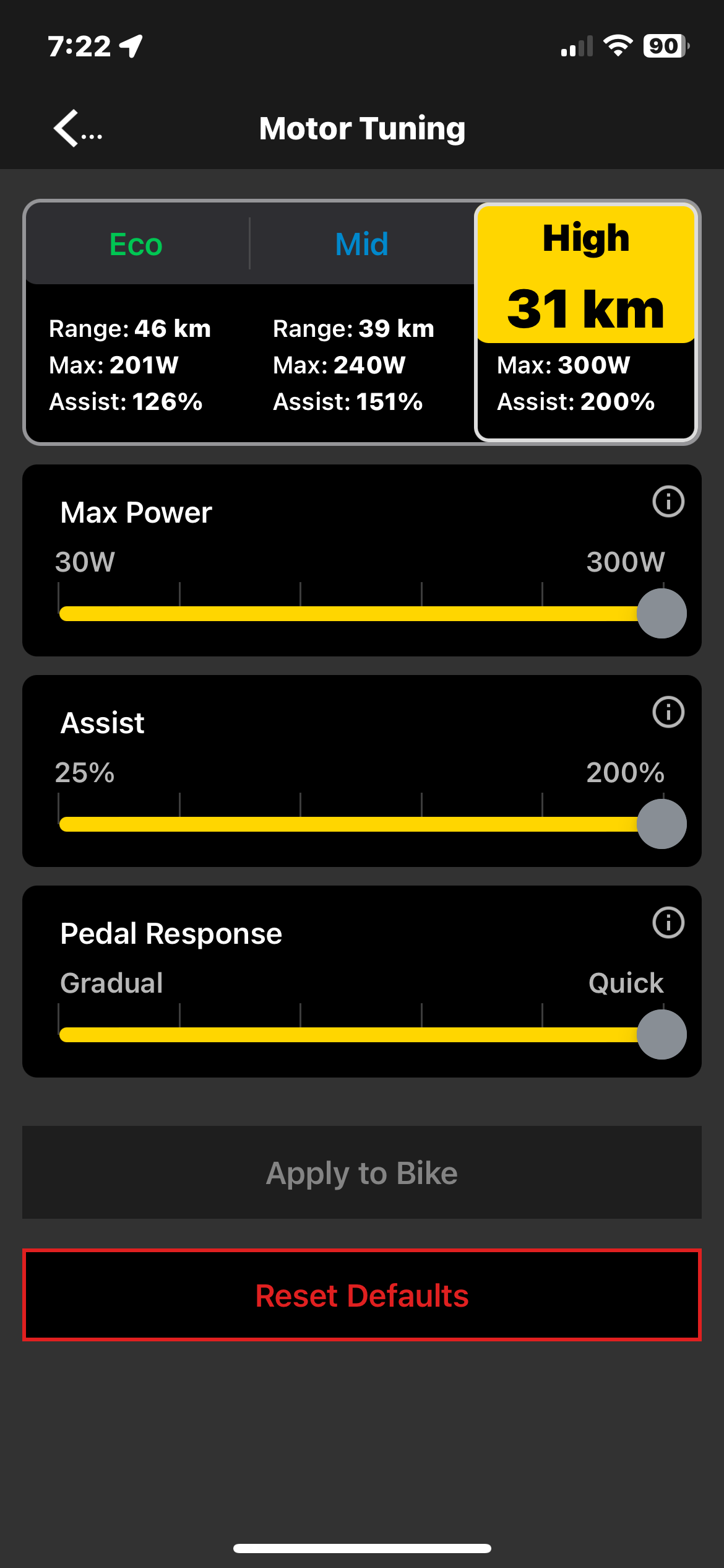

The assist percentage, or level, seems to be fine in each different mode for my type of riding. It’s the assist response time that has me a little puzzled. I’m set to a “quick” response, but I still must travel a few meters before any assist kicks in.
My Rail behaves differently, but it doesn’t lurch when I’m in eMTB mode. It’s fast but gradual …or maybe I’m just use to this behaviour. I would like the TQ motor to respond a little faster …but I’m maxed out, in the app, for response time/delay.

My understanding is that the motor delivers power at the assistance % you have set; ie if you are inputting 150 watts and you have the assistance at 50% the motor will deliver 75 watts. If the assistance was set at 200% the motor would deliver 300 watts (provided that is the power level you’ve set)
My bike overheads the rider wattage which isn’t a problem as I can dial back the assistance level. The issue comes when the rider power level under reads as is the case on my wife’s bike. With the assistance % at 200 she has to register 150 watts in order to get the full 300 watts of motor assistance.
