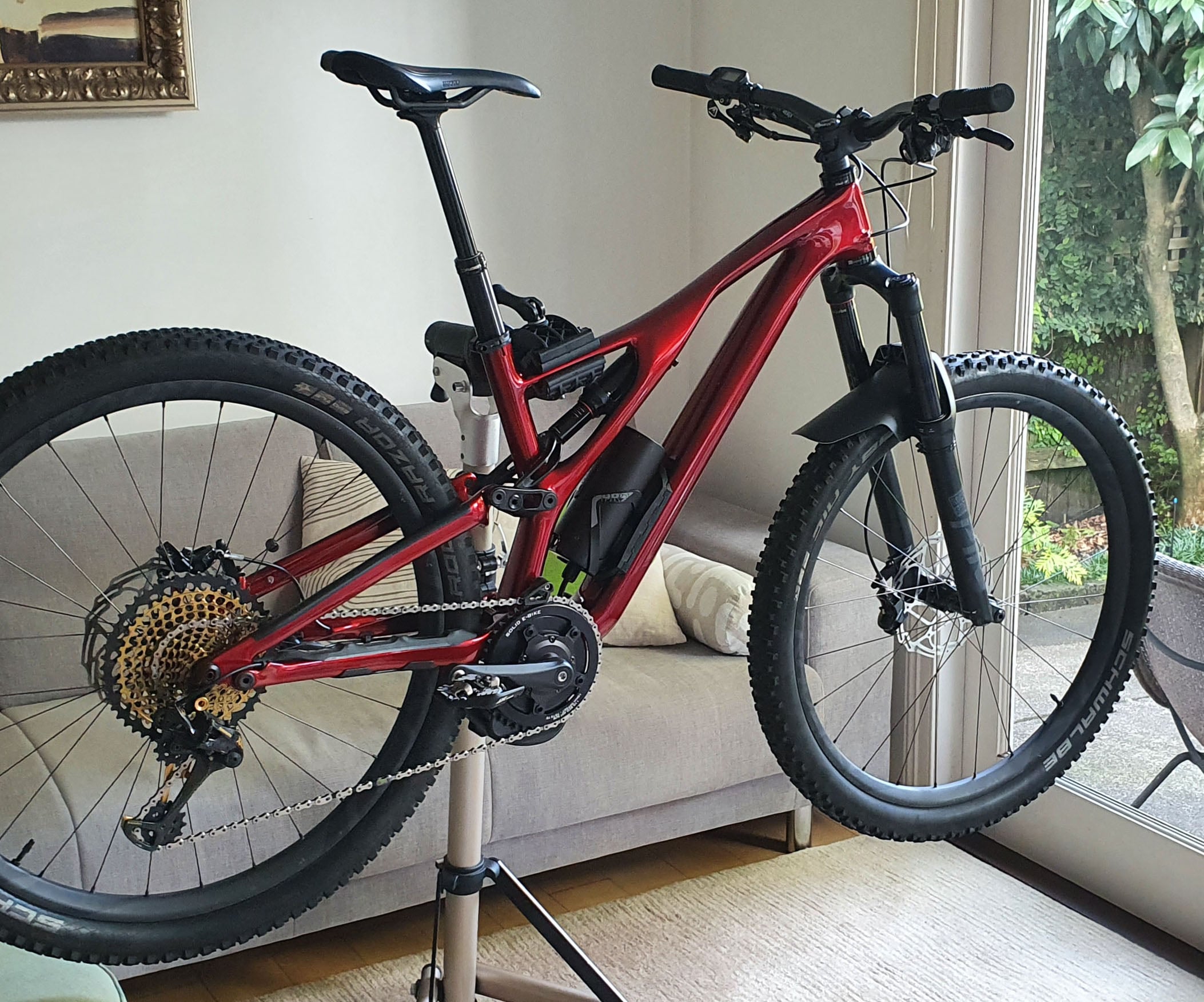

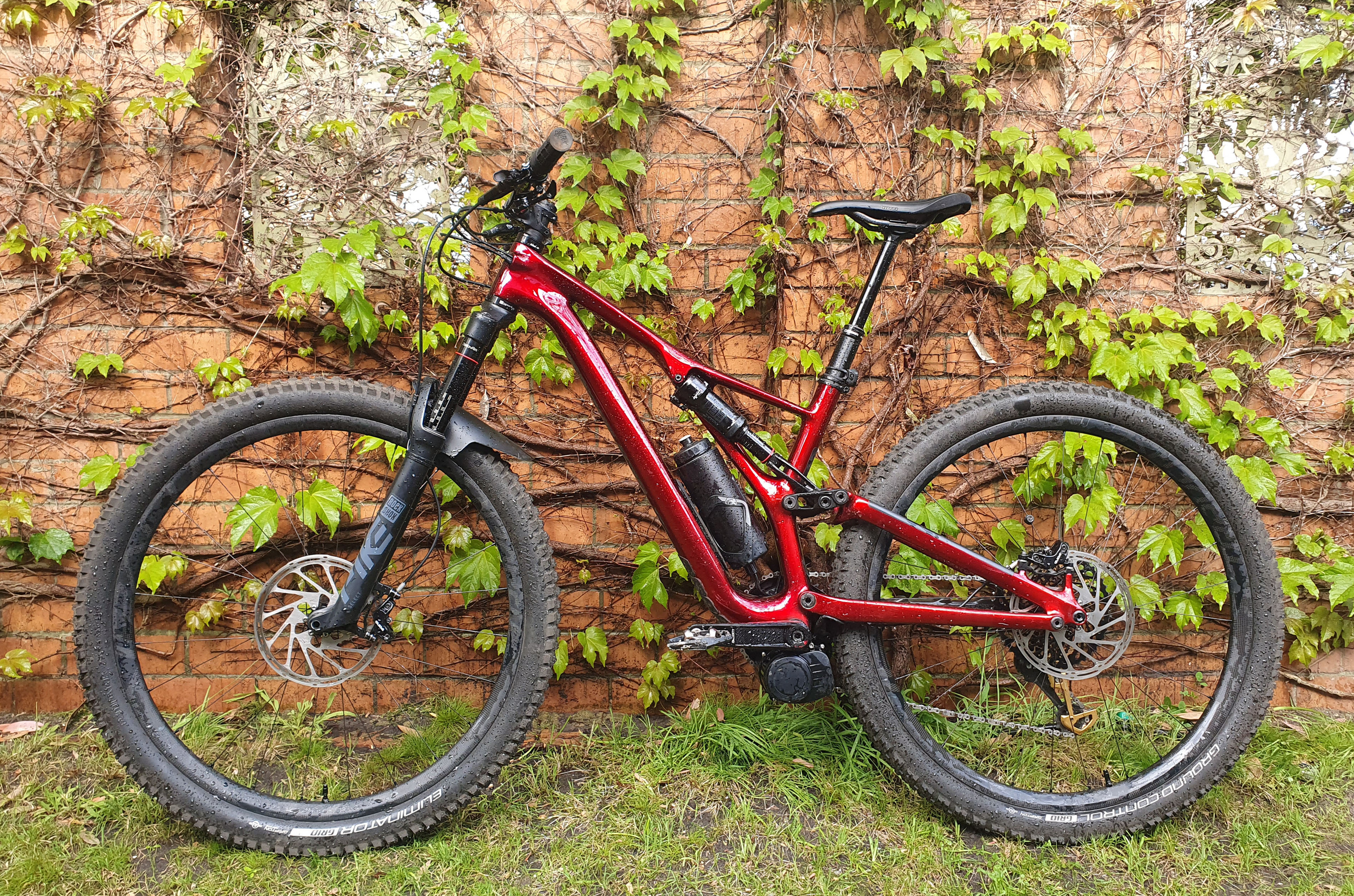

I built this during Lockdown to see whether a 16.5kg eMTB was a good idea - and it is.

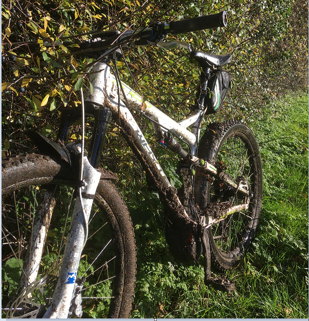

So I've had a TSDZ2 On a 2009 Kona Stinky for over a year now with all the usual mods. Brass gear. Open source firmware temp sensor and cooling mods and have it blasting out 500W all day long. Such a great motor. Being a full suspension bike I was sending it everywhere especially as I seek out gravity riding. Only now am I concerned about the square taper spindle not holding up as I just converted to the 100mm BB extension for my new build with a 2017 Giant reign 1. I didn't realise the spindle was a weak point untill I was researching the conversion for the Reign. I've riden the bike a couple times hitting every jump and drop I can find, so fingers crossed it holds up as the motor is excellent. I did cram in a few more bearings to help with supporting the spindle .Having owned (for a brief time) a 2020 Giant Reign E+2 pro I'd have to say that I much prefer my current setup. The Motor as very similar performance to a commercial motor and in my current setup the bike weighs in 5kg lighter! Also batteries are a fraction of the cost to have a spare / replace. The Chain line is crazy though with the 11sp cassette but it does work. I have ordered a Shimano cassette to drop 3 gears as mentioned above. This info is greatly appreciated by the way. Hopefully the drivetrain will wear better as a result. I'm surprised that they didnt become as popular as the Bafang mid drives. But I guess the banfang BBSHD in particular is quite over engineed in comparison but the torque sensor with the TSDZ2 is what makes it great for actual off-road moutian biking. I hope all the info helps others with modern bikes as the bike is so my fun to ride with all the benifits of Carbon tubeless 650b wheels, big travel air suspension and modern geometry! Also a huge shout out to Sgarth42 for all the info provided on his trance build as the PF BB is the same on the Reign and alot of giant dual suspension bikes around that year.
View attachment 108142 View attachment 108143
hiya bud, is that bottle a battery?? do you have a link??
