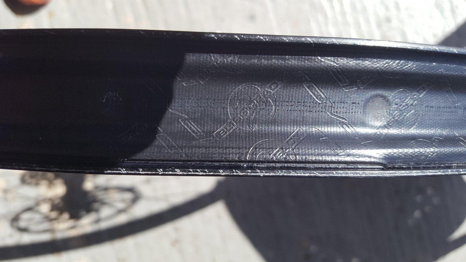

Eureka
babarnicle
Nov 9, 2019
36
72
Usa
Rim tape was folded under at the bead across the length of part of the rim where the Roval decal is. Undid that fold under and refitted the tyre tubeless.
Silence is Golden.
Glad you found the tick. For tubeless, I have found it much more reliable to use a tubeless rim Tape like Stans rather than the plastic rim strips that come with the rims. The tape seals much better for keeping overall pressure consistent. Cheers.

This is the tape put on by Spesh as standard to make the rims tubeless ready. Im not sure if it has always been like that (with that fold) or whether it got pushed like that when mounting the tire when I went tubeless. A lengthy search for a solution but everything I did to the bike was useful maintenance so not wasted....it also absorbed a lot of "lockdown" hours. Grateful to evrryone for their suggestions and help.
