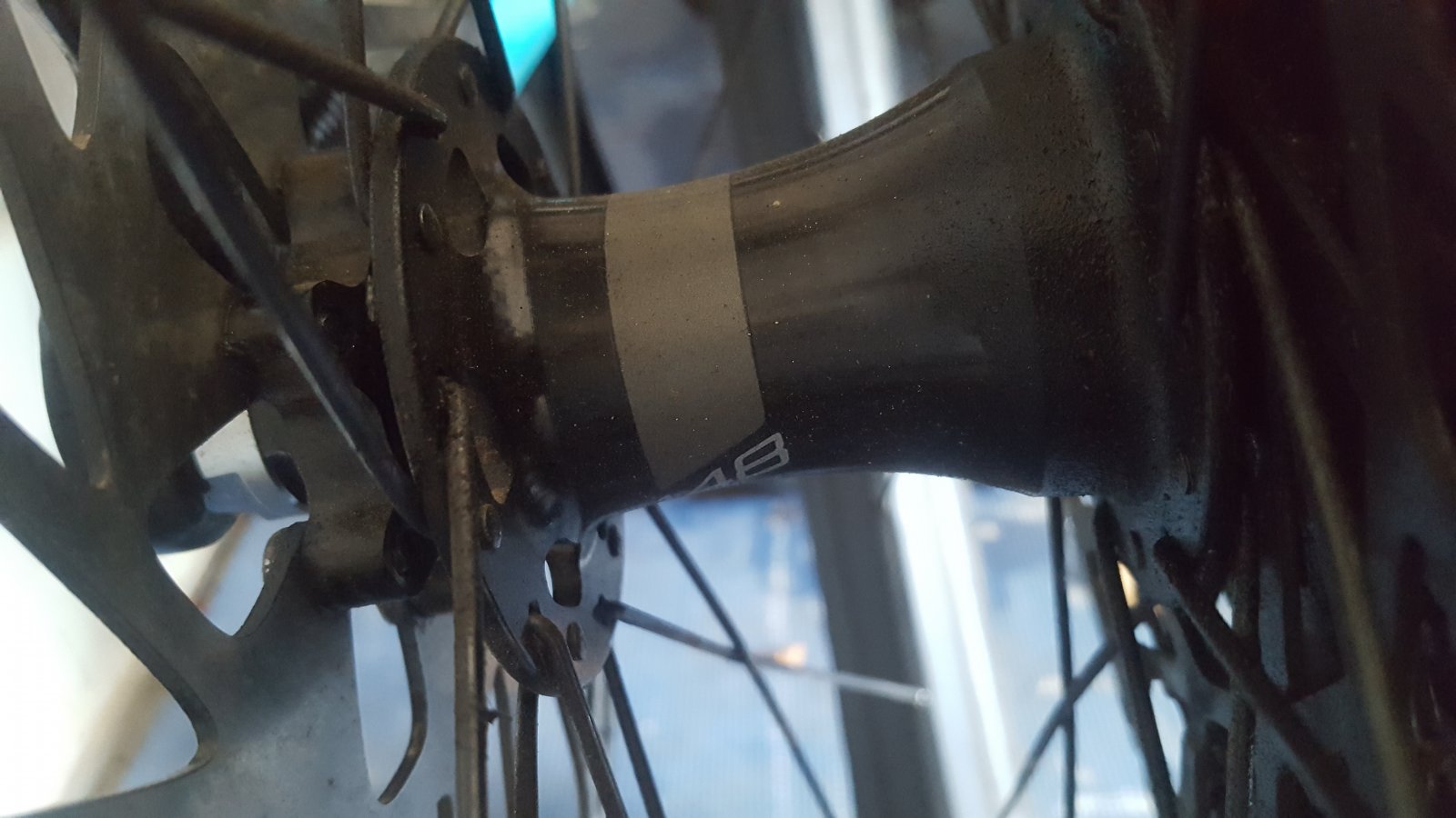

Where is the magnet. In relation to the sensor at this point?
On the Levo the magnet is bolted onto the disc and the sensor is on the chain stay. Think the noise is due to spoke tension Gary. Yesterday I did some spoke checking and thought the noise had gone...but it came back. Maybe I failed to squeeze the spokes after adding a bit of tension?
I know that. My unanswered question still stands.
Spoke tension (after checking it) is unlikely to make a ticking sound. More of a ping or creak. The ping is more often than not from sopke wind-up. The creak from uneven tension. Some thin gauge butted spokes are just too weedy for use and the stretch/give in them means they cause noise under load. E13 are dicks for this for example. DT way less so.
You haven't said (or maybe I missed it) but are your spokes j bend or straight pull?

Ah...I thought you would! I did check that the magnet was not touching but it stays a constant few mm from the chainstay. The spokes are I assume J pull?
See photo

Pic of hub
you're still not answering the question.
where exactly is the magnet in relation to the sensor at the point you hear the tick?
Just starting to pass behind the upper chain stay......mmmm

and you know magnets can "tick" when passing other metals, wiring and sensors?
You could well be right Gary although something has changed because the noise only started a few weeks ago. The area of the upper chainstay the magnet passes has what I assume to a rubber or plastic cover and there is no wiring there. It is difficult to be precise about the position of the magnet when the noise occurs but it is certainly in the region of the sensor which is slung below the lower chainstay. Thanks for the suggestion.
