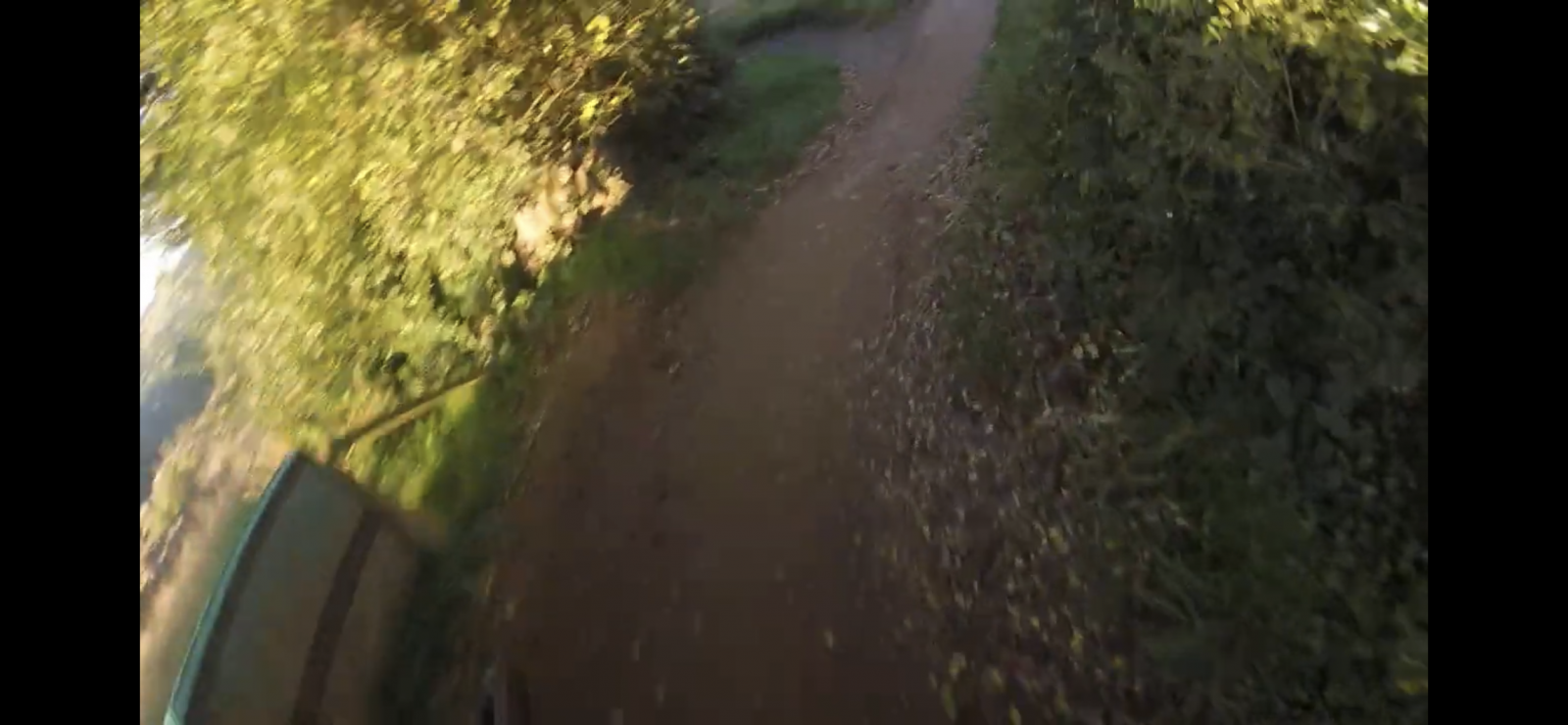

The bike is super fast and my front end just washed out
Video:

I can’t make out what happened thanks to the lighting of the video but I sympathise. I had problems with the KSL front end on my test ride. Adding some compression helped but it never felt super secure. My Rail with a 1700 (at least!) mile old Magic Mary had more grip in the same corner later in the day.

This isn’t a criticism just a genuine query, but it looks like just before it let go you was right at the top of the berm, possible you rolled over top or ran out of bern as it does lip off at the end….???
You can just about see your tyre at the bottom. Wasn’t much left?
Either way, hope you’re on the mend soon. Shame looked like you was enjoying it till that point 👍🏻🤙🏻

I was going to say the same thing, looks like he may have high-sided the berm. But it's hard to say for sure. Either way, if the front tire washed out or it was a momentary lapse in judgement, when it's your time to pay up weird shit will happen.

Yeah I did go high but when I tried to bring it back in it washed out. On my other bikes I'd get traction and correct that, these tyres don't fill me with faith under high loads apparently the walls are weak

Was a mixture of both, I did go high but when I tried to bring it back in it's just give out

I guess if you post the video you can expect some critique?? From what I can see that berm is pretty shallow at best and ceases to be a berm at all just beyond the apex of the turn. If you ride it like a berm ....ie you and bike lean over to the inside of the turn.........and the berm becomes too shallow or not a berm at all.........you are likely to push out any tyre. I think if I was riding that trail I would rate that berm as too shallow and incomplete and ride it as a flat turn.

Watching that video it looks like you got out of shape a little before the crash and entered the turn off line with no confidence. Nothing to do with the tyre.

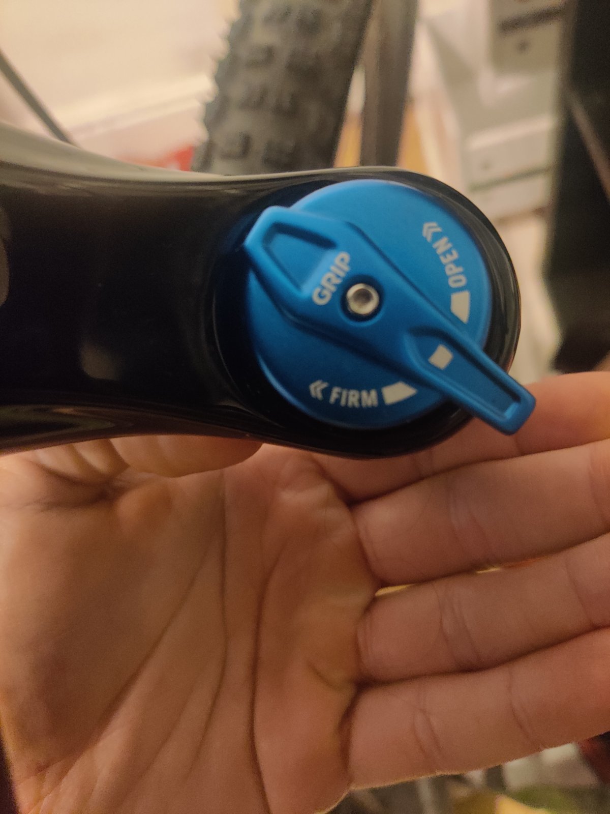

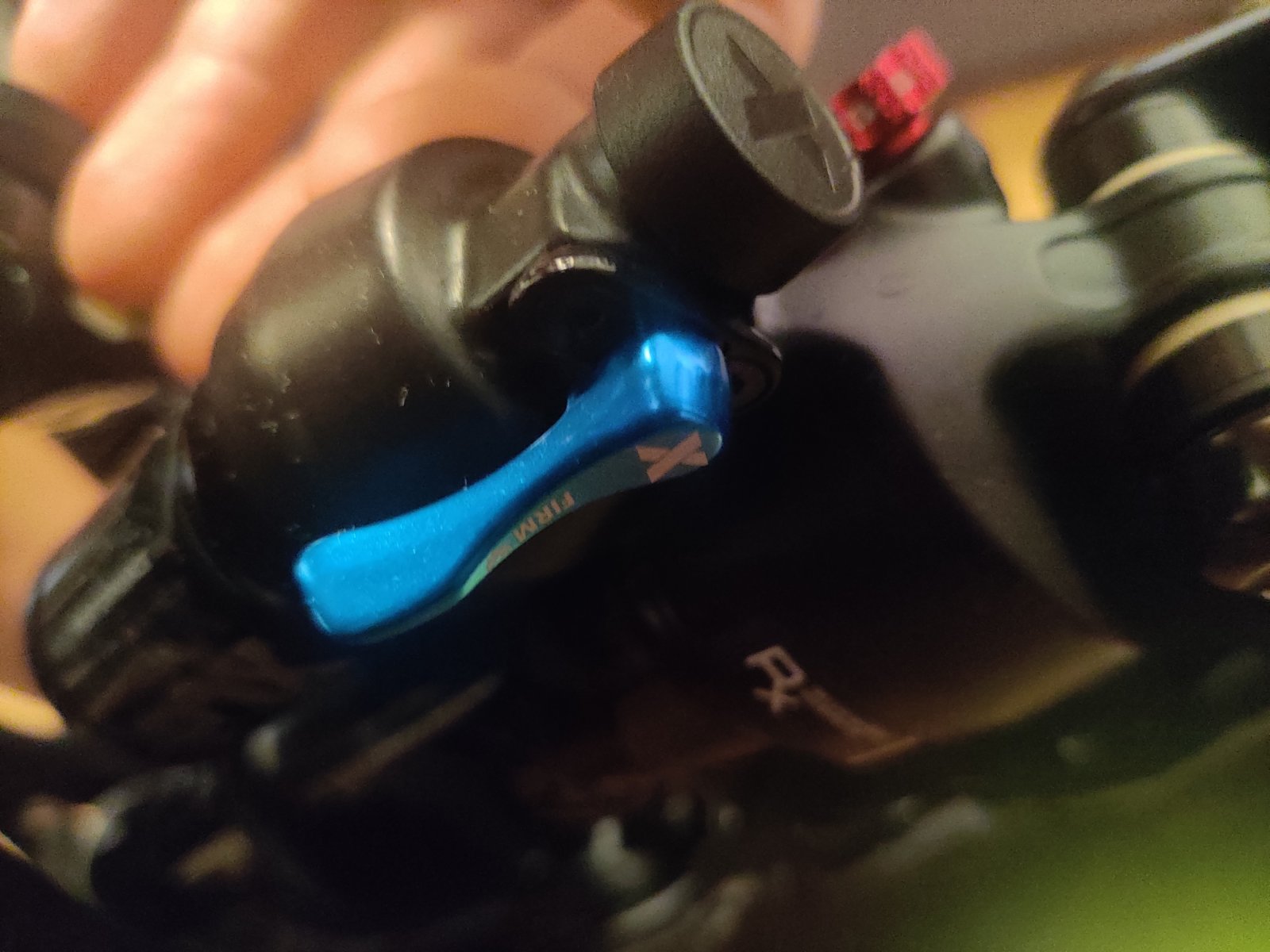

Same thing happened to me on a ‘21 Levo Comp on non-T9 Butchers. And we have the same fork, just at different travels. From what I can see in that video… unless your Kenevo SL’s rear has much less traction than my Levo’s… you’ve dialed in way too much compression damping on those 36 Rhythms, and are giving up way too much front traction.
As it stands the traction balance between front and rear on the Fox-Rhythm-equipped Levo Comp at wide-open compression setting all-around is rear-biased, causing the front to wash-out first. I can get a nicely-neutral cornering balance by keeping the front wide open, while having the rear in its middle setting. And it needs to be noted that the front compression knob is terribly sensitive. You may (or may not) need as little front compression damping as I do, but given the response of the 36 Rhythm’s compression adjustment… I honestly can’t imagine how much you would need to dial-down the rear traction (by dialing up the rear compression) for it to balance well with the front setting you have in that video.

I don't know how to set suspension up in all honesty. I had it quite firm that day. Ill attach pics of how I had it set up

Re-watching it on a PC rather than a phone on a beach in Cyprus it certainly looks to me like you ran out of berm.
