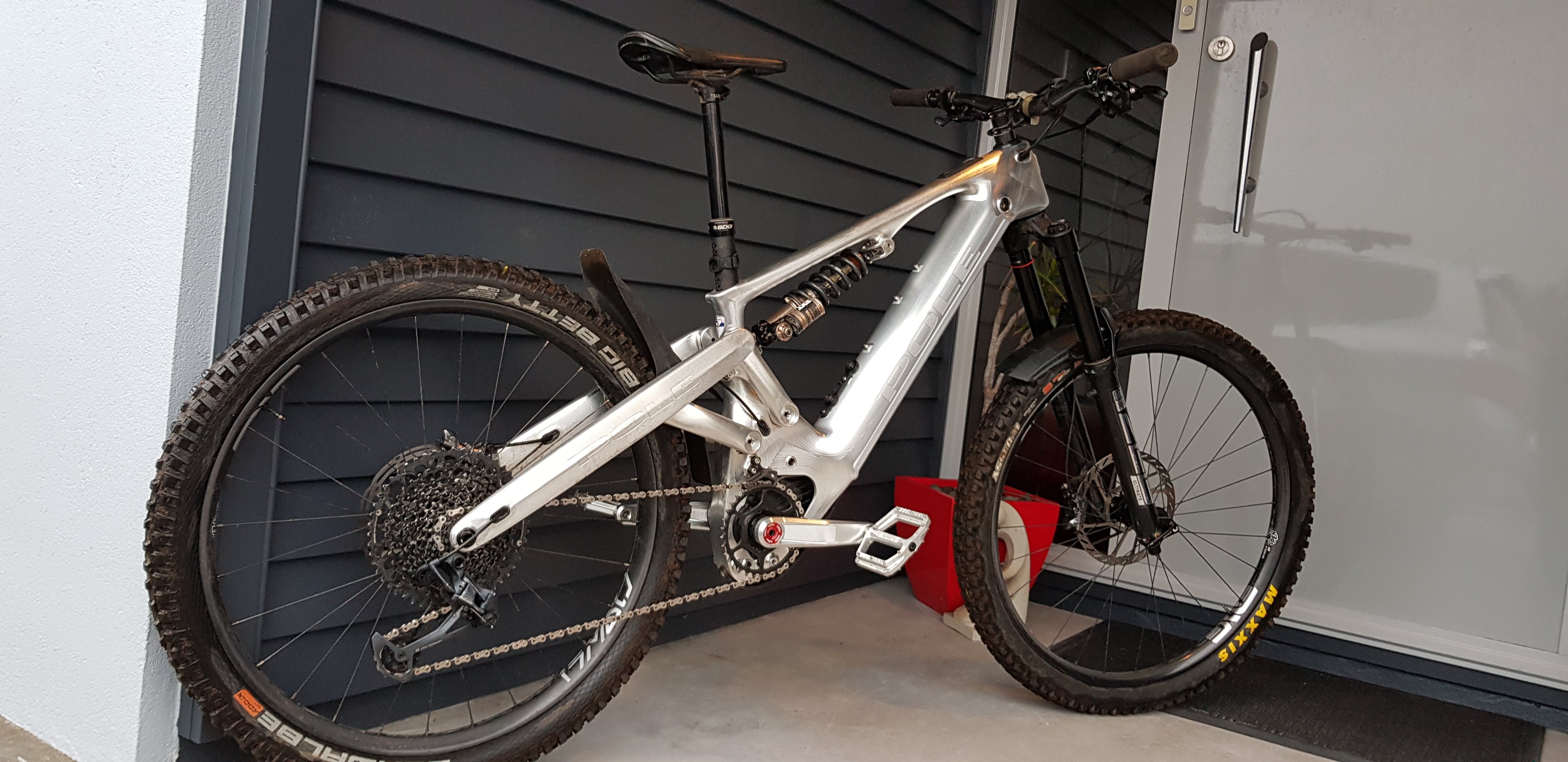

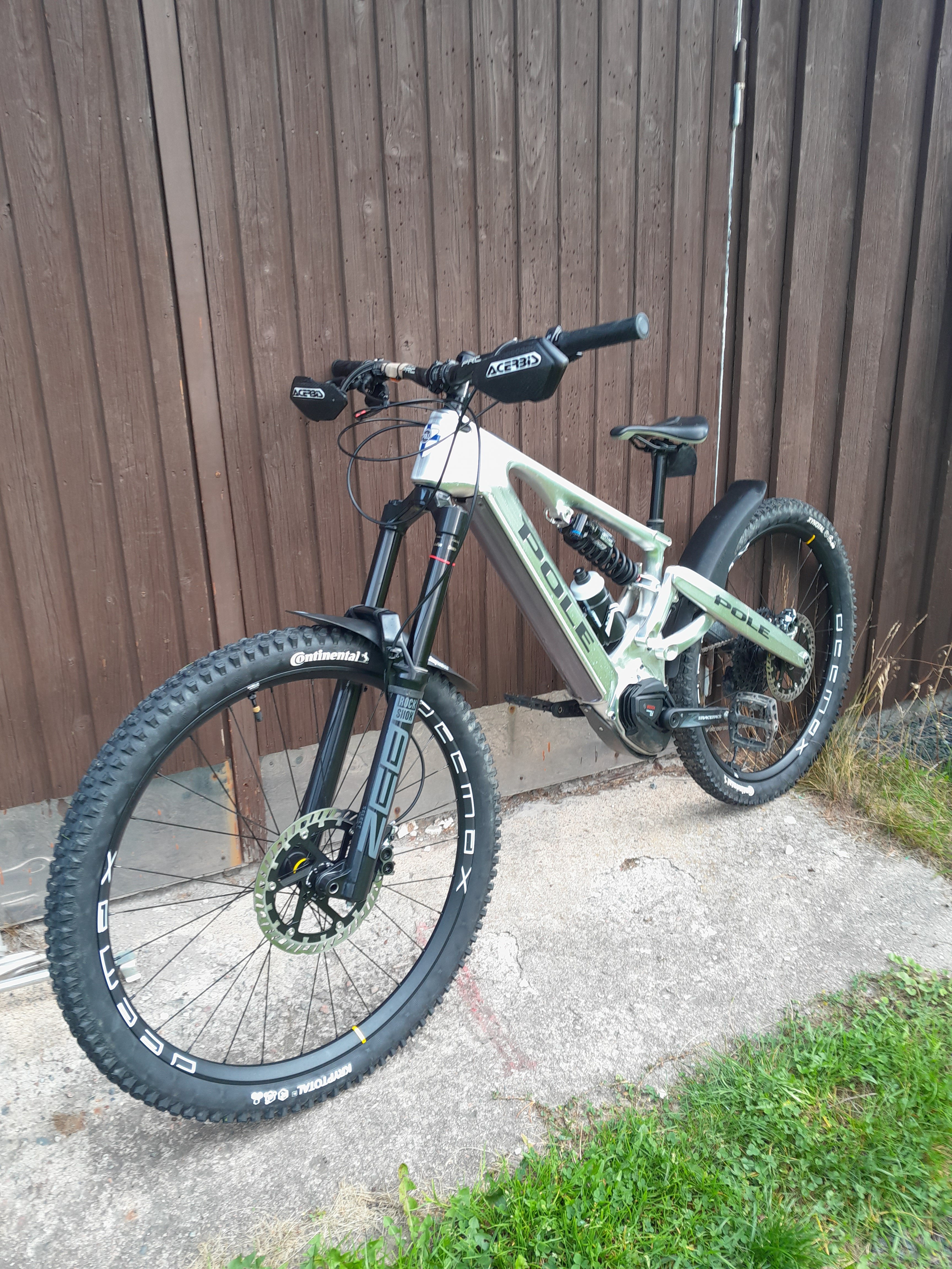

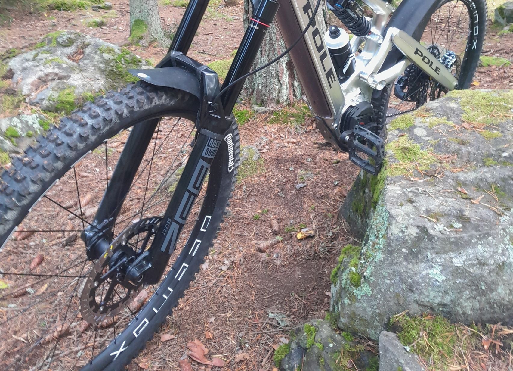

I think Pole Voima K0 is the smallest bike pole ever made. Probably the smallest long travel eMtb on the markets. This is loooong bike, but the geometry makes it plausable to someone like me, although some shrinking process was necessary...
I finally got everything together:
- 35 mm Stem
- 720 mm handlebar
- Cube saddle, very much in front
- RockShox Super Deluxe Ultimate Coil DH with 250 lbs/in coil
- 190 mm Zeb with 30 lbs/in coil
- Magura MT7 brakes
- Shimano trigger
- OneUp 120 mm (OEM)
- Mullet with Deemax wheels (OEM)
- Pepi's inserts and 0,8 bar pressures

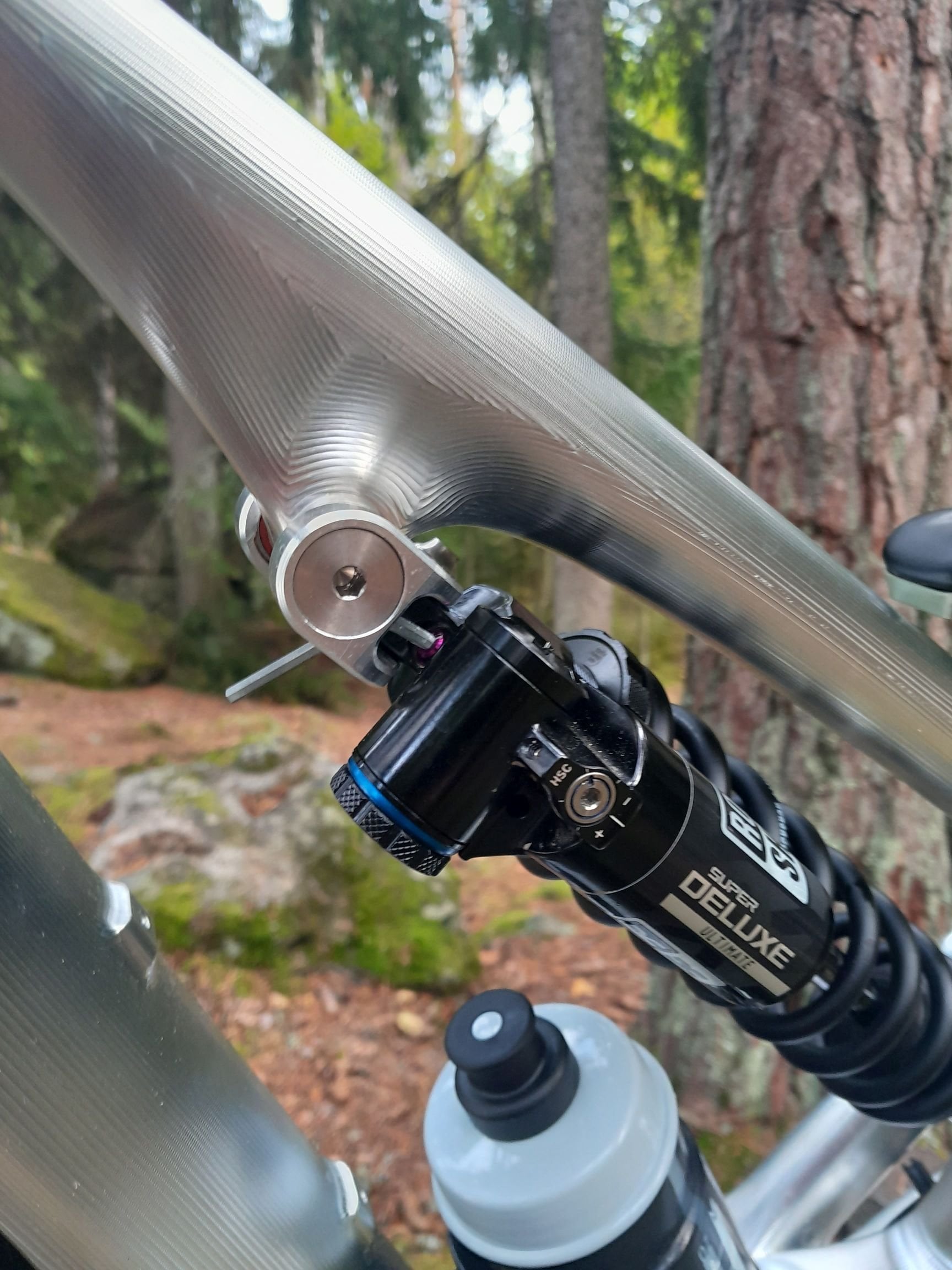

With Voima there just wasn't any need for lock-up, so I chose DH shock. HBO adjustment needed customized allen key ;)

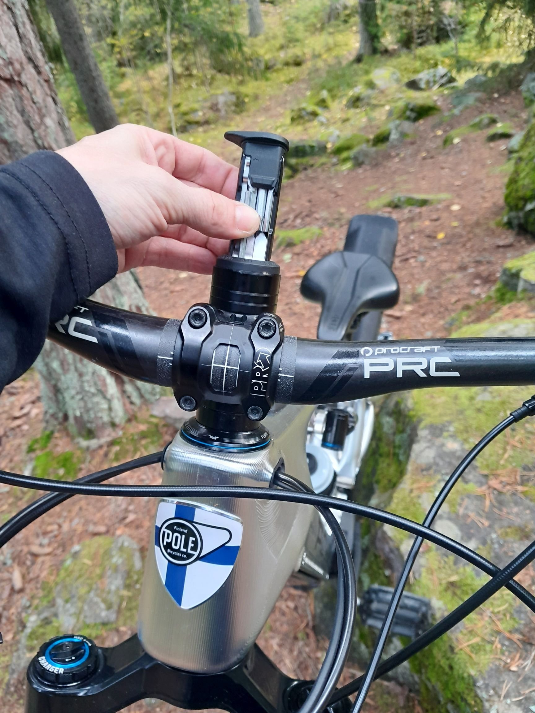

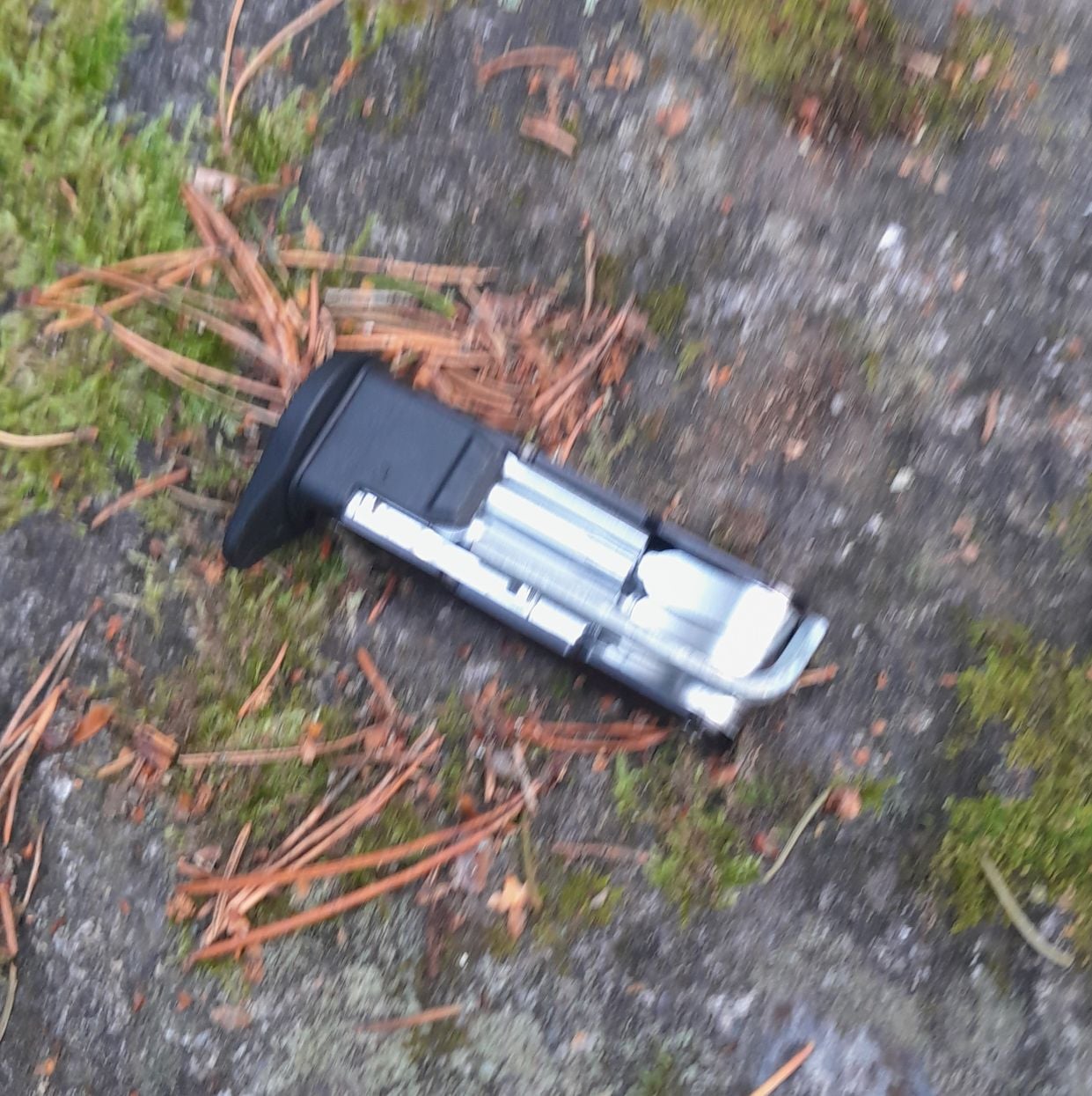

Now it fits to OneUp EDC mini's tool holder :D
And how this beast behaves in trails? This in incredible!

Nice.

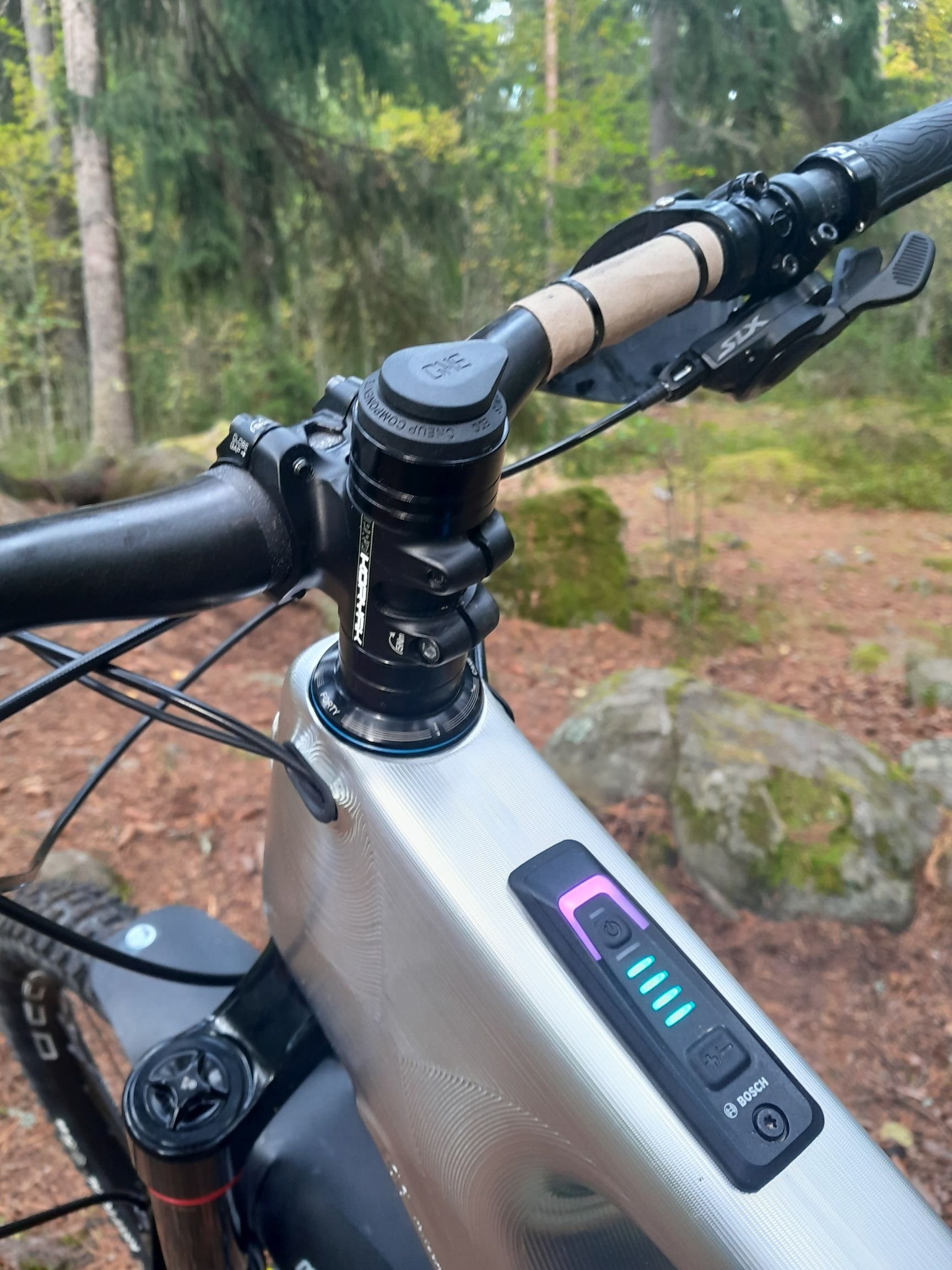

I'd council you to cut the steerer down. That looks like a knee smasher if you crash.
The stupid long rear chainstay is bound to be limiting for shorter people. At 5,11 on a k1, I find it too long. I cant help but think the K0 bike will be a bit unbalanced because the haven't shortened the chainstay to match the reduce size of the rest of the bike.

My knee barely reaches 10 cm behind the +/- button :D I normally keep my phone sideways below that and this far (198 km) I never hit the phone :D
But I understand Your point. I'm just not yet ready to cut the steerer, still looking for the optimal setup. Now when I have set up the fork lenght-wise, I can start narrowing down best height for the stack. At the moment handlebar lies too low even with 29er and my other front wheel is 275.
About chainstay I disagree. It's actually shortish for as long as 190 mm travel. You guess You might mix chainstay and virtual pivot point. Latter makes Voima "swallow everything" - among other Sensei features. Something I love in this bike. When I try to manual (suck on any ebike), I get the front end about 0,5 m up - best this far on the category. But technique is somewhat different: with Voima You need focus more on pushing the bike forward (that's just I have figured this out).
I've lost rear end in uphill sections on every ride at least once. Then I tell myself "stop leaning forward You stupid - this isn't gonna throw You on Your back" - and try again -> fantastic grip, front wheel "planted", yippee :D
I'm 1,5 m and You're like 1,77 correct? I don't think K0 would be Your choice, even with very long stem and saddle.

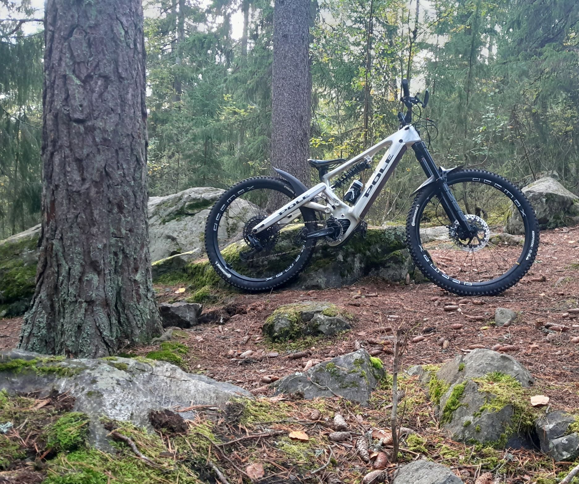

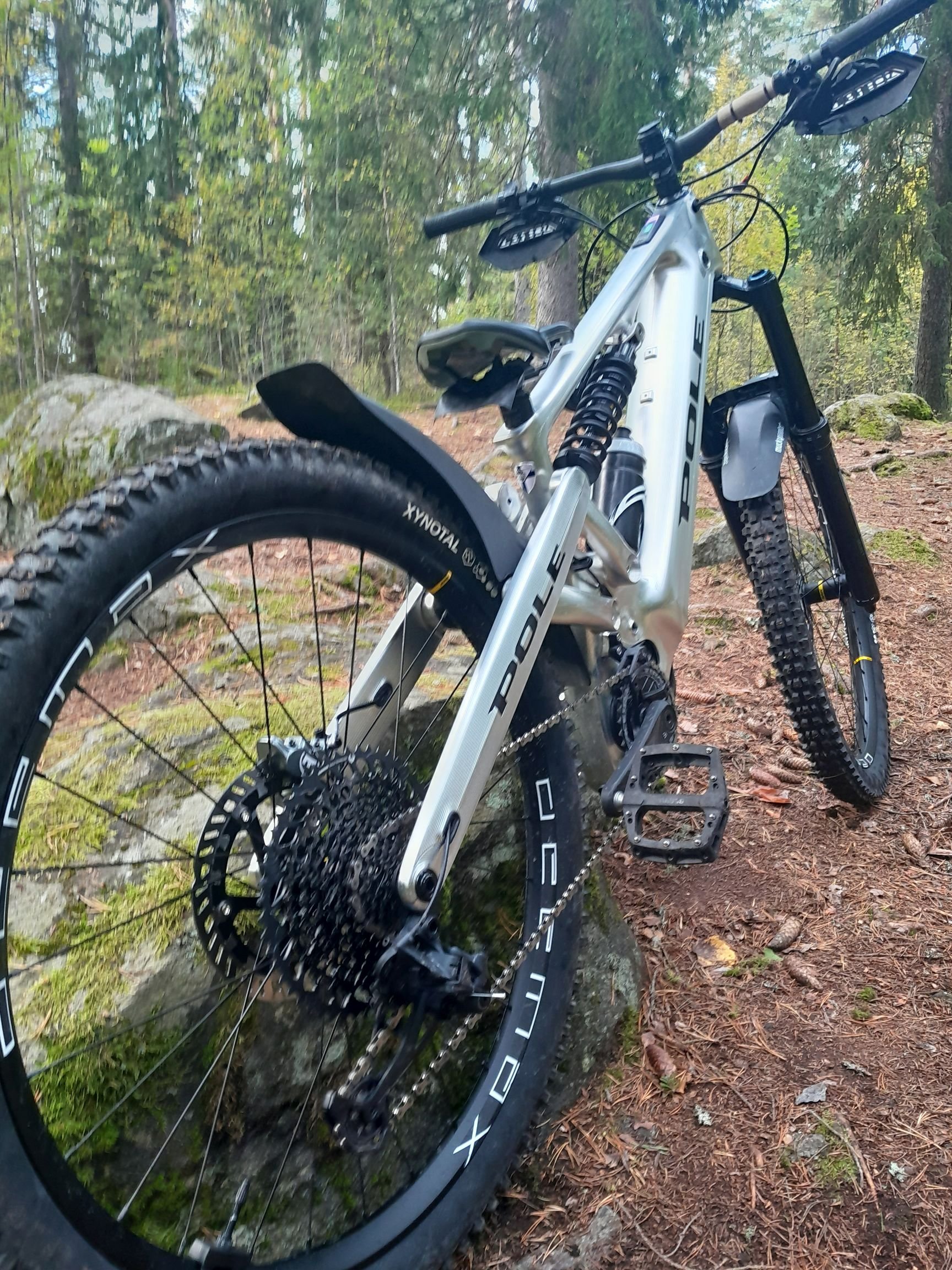

Today some Sappee bike park rides. In berms this "machine" temps me to increase the speed well above my skills. But I also noticed how significantly Voima is tempting rider to lean in on curves - any kind of curves. I didn't figure this out yet, but there is definitely something in the geometry that's makes leaning in so natural. And that's kind of funny feature, because mtb bicycles are normally quite opposite... so need to go deeper on physics with Voima... or I just ignore physics and focus on riding :D - what a beast he is <3 (sorry gents, not "she" from my point of view ;) )
Mabman
Feb 28, 2018
1,124
1,853
Oregon USA
If as you say the natural tendency of the Volma is to want to lean into corners then you might explore the use of countersteering? Or maybe you already do but I know it works on motorcycles that like to lean and I have used it to good effect on bikes with + tires on the front.
Have you ridden a downhill bike before? The Voima feels like a heavy downhill bike to ride down. And so it should. It's similar travel and angles.
So yes, it should take you faster than you've gone before. It is a monster. Ride it like you stole it.
Ps I dont buy the higher stack under the stem for the Voima. It's already dh bike high. I tested and didnt like it. So slammed it back down.

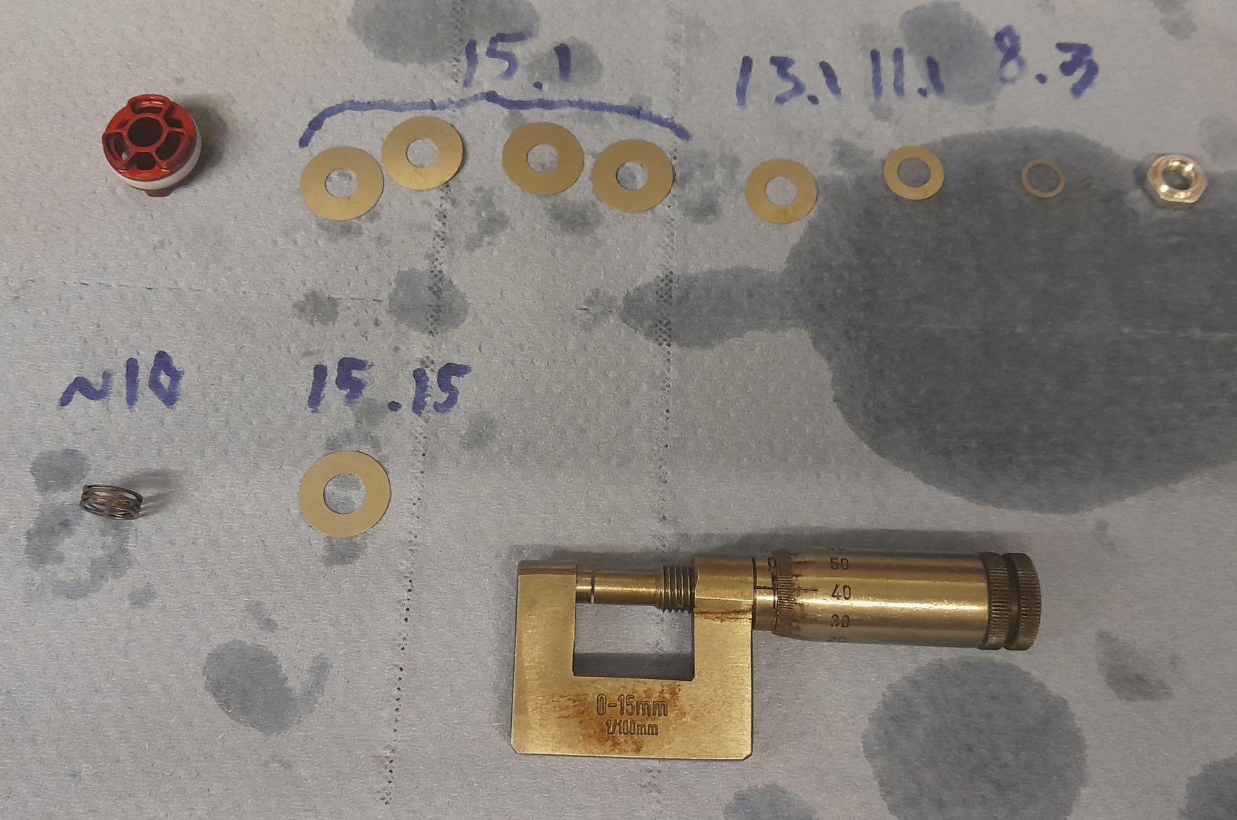

Even though fork damper has way too harsh midvalve for someone my weight, it's still the best I have founs- unless Avalanche taken into account. I wonder why 190 Zeb isn't listed, but Boxxer 38 is...
THA
Sep 16, 2023
76
90
Finland

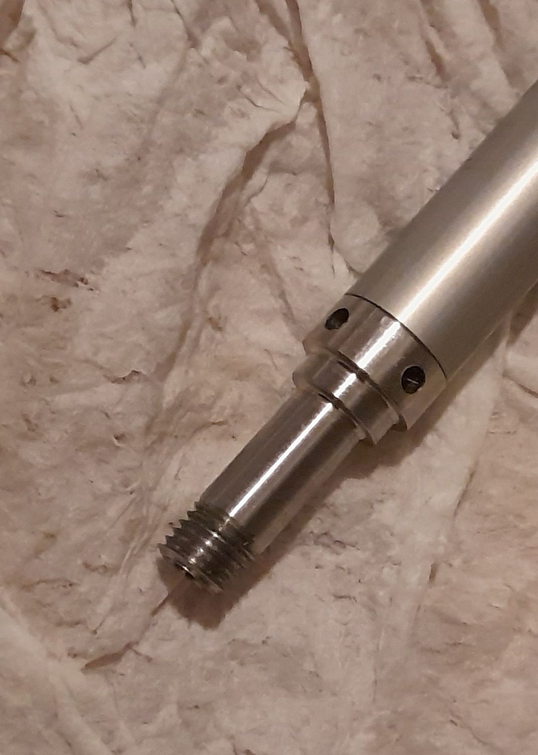

This is what's going on in the midvalve: 15x.15 shim has quite forgiving 0,35 mm float, after that untill 1,2 mm bends over app. 7,5 mm notch and then sudden change over app. 10 mm spring (bottoms at 1,2 mm). Regardless of exact measures, this behavior is far from continuous curve that should occur right after float stroke have been reached.
- micrometer might be as old as I, but well maintained and accurate

This piece enters to my super-Zeb tomorrow... I just decided I won't care anymore, I just want my Voima to be as perfect as possible, as soon as possible. Someone might be interested to make this commercial, for me this unique piece is just what I need - so I'll continue ... proper midvalve shim setting, then compression, rebound is quite easy to get close enough... I'm all open to help anyone below any weight schedules in order to find nice suspension setup w/ coil Zeb and custom damper ;)
