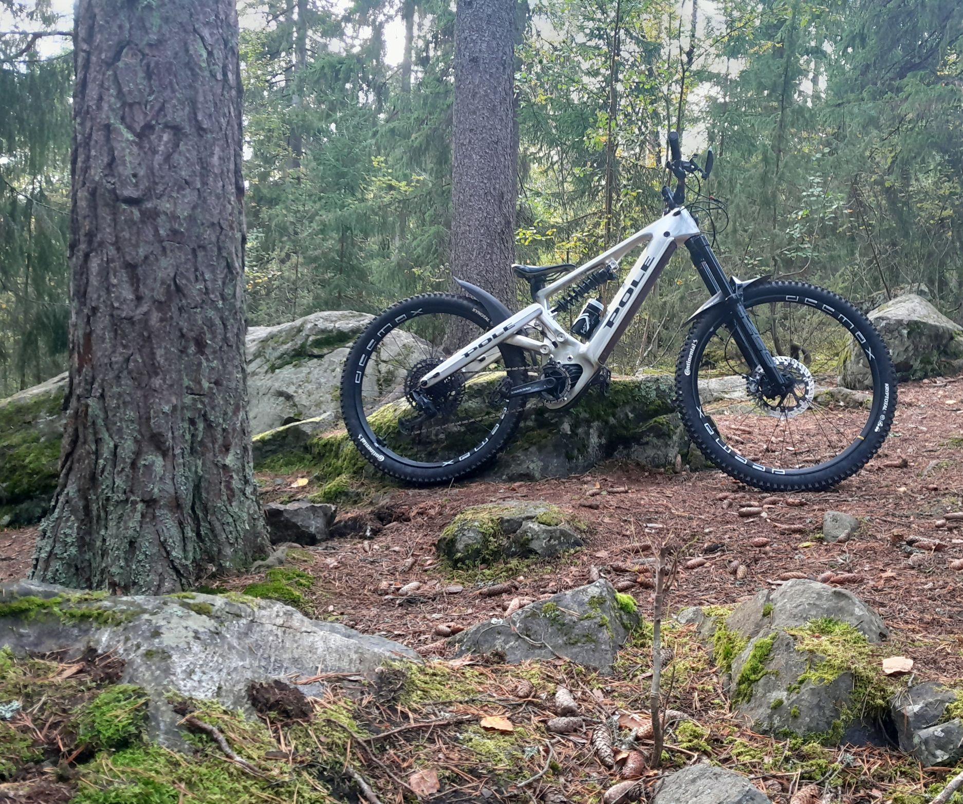

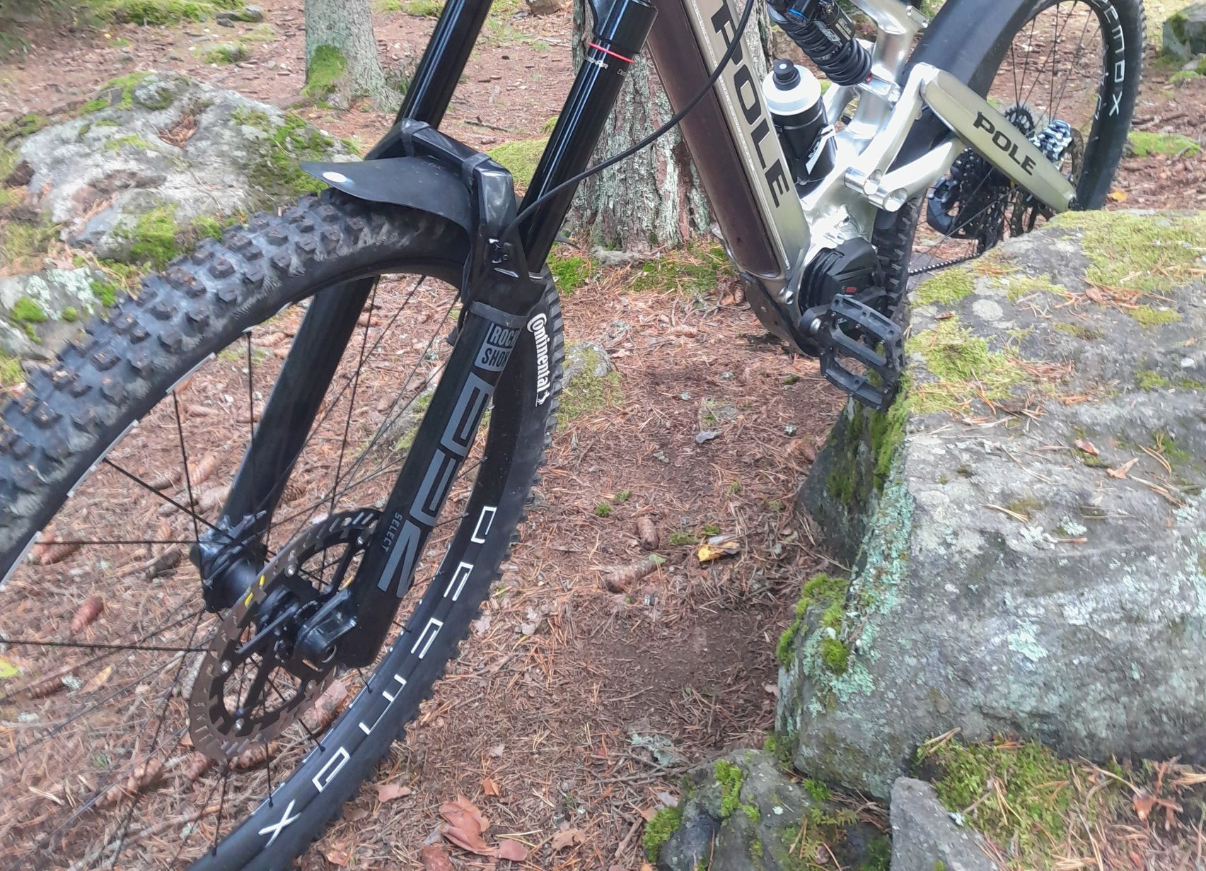

I think Pole Voima K0 is the smallest bike pole ever made. Probably the smallest long travel eMtb on the markets. This is loooong bike, but the geometry makes it plausable to someone like me, although some shrinking process was necessary...

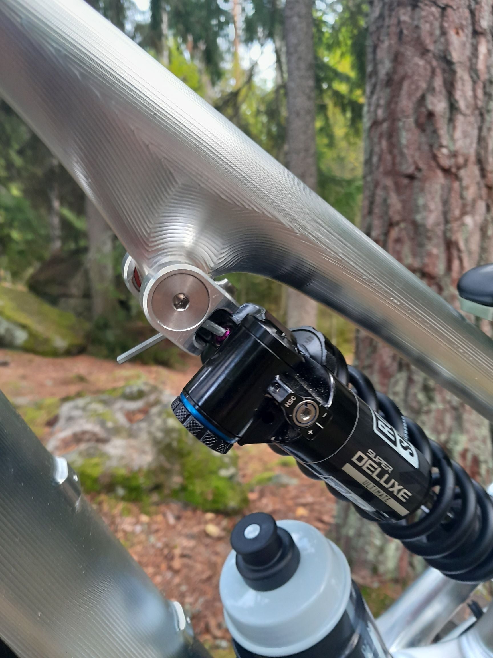

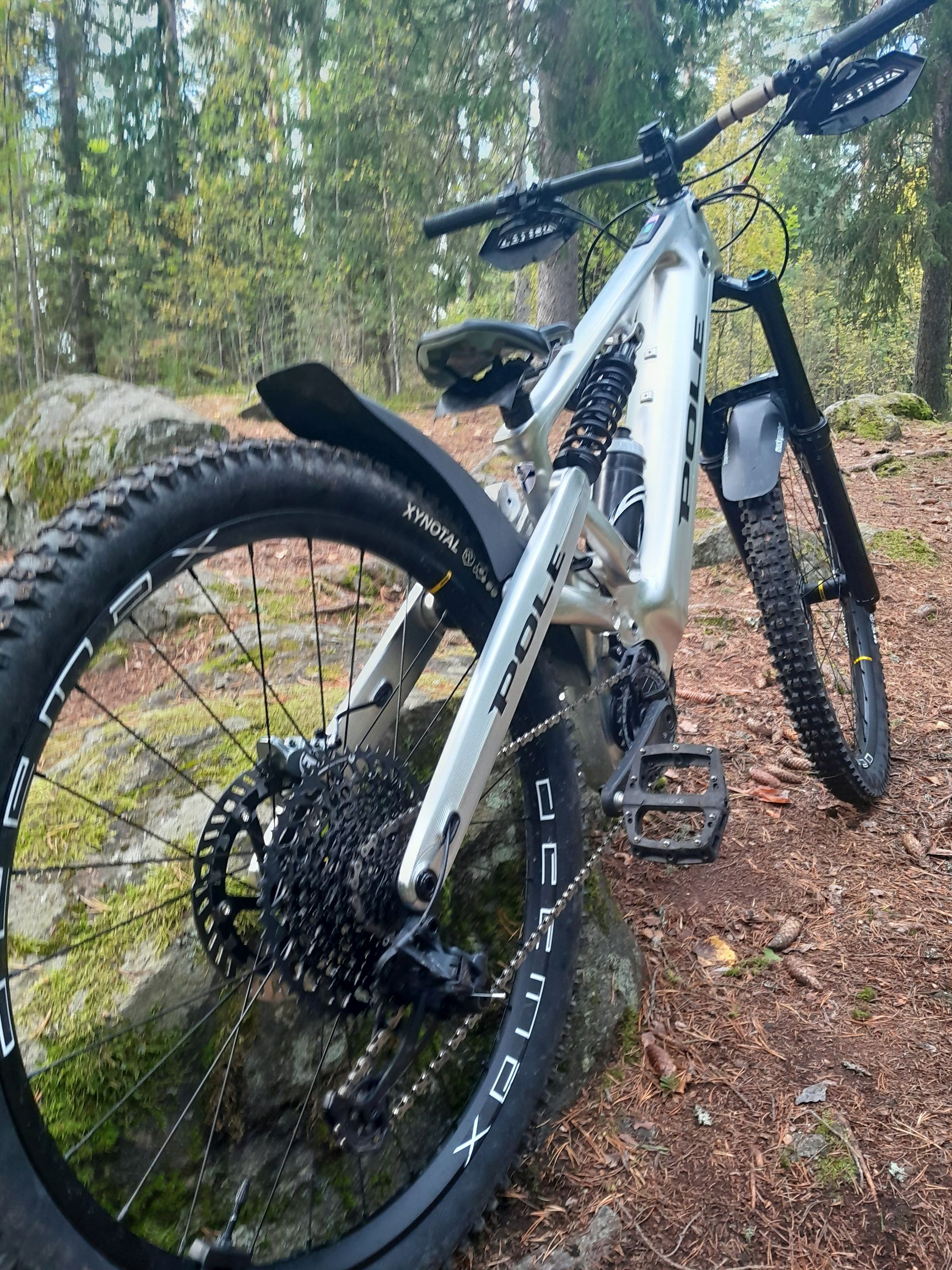

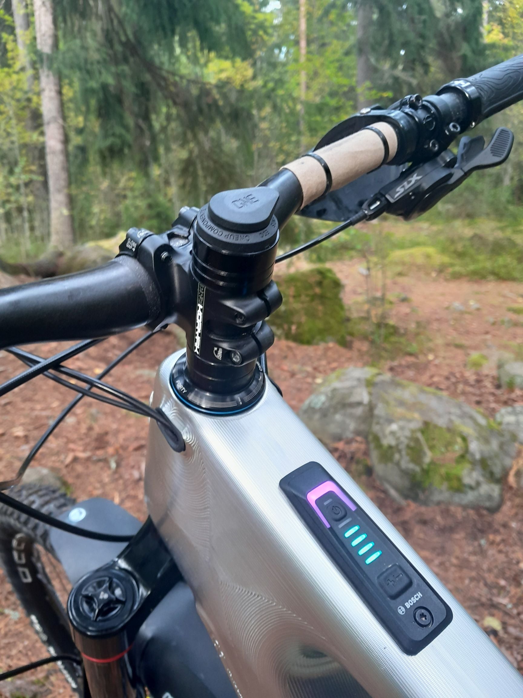

I finally got everything together:
- 35 mm Stem
- 720 mm handlebar
- Cube saddle, very much in front
- RockShox Super Deluxe Ultimate Coil DH with 250 lbs/in coil
- 190 mm Zeb with 30 lbs/in coil
- Magura MT7 brakes
- Shimano trigger
- OneUp 120 mm (OEM)
- Mullet with Deemax wheels (OEM)
- Pepi's inserts and 0,8 bar pressures
With Voima there just wasn't any need for lock-up, so I chose DH shock. HBO adjustment needed customized allen key ;)

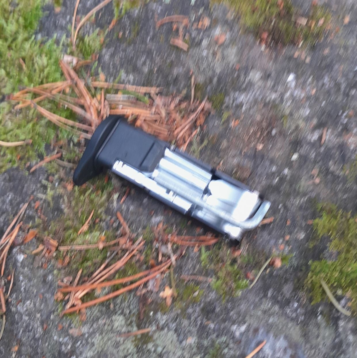

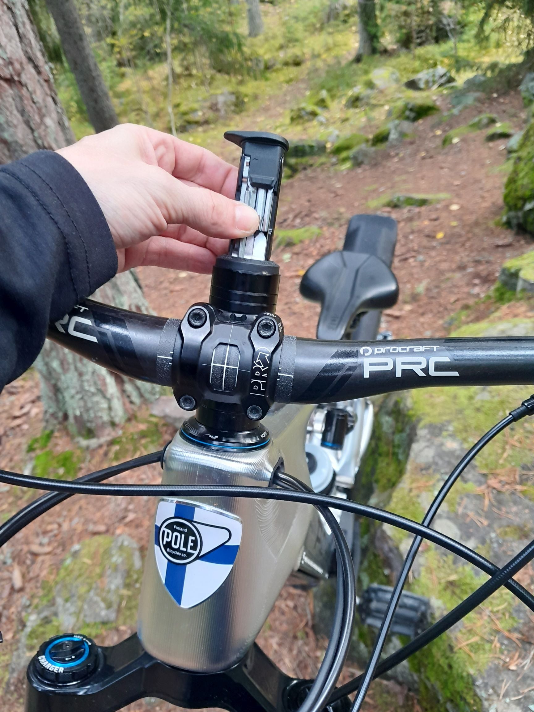

Now it fits to OneUp EDC mini's tool holder :D
And how this beast behaves in trails? This in incredible!
View attachment 125271 View attachment 125272 View attachment 125273 View attachment 125274 View attachment 125275 View attachment 125276 View attachment 125277
Hot! But yes that steerer tube is a nut sack incident waiting to happen 😅
Maight be, for someone with sacs ;) - don't worry, I rose the bar back up...

Today was a great day for me and my Voima - now I truly "have the Force with me" :D
Yesterday I was finally able to test ride my second custom setup and I was so happy with it in "rockish" (rocks 10-20 cm high, max. 30 deg. downhill) trail sections. Today I took it to a bike park and just some fine tuning necessary - it was super smooth, stable... the best fork I've ever ridden. The best bike and suspension I've ever ridden.
54 kg rider + RC2 my23 RS SDLU-ULDH coil w/ 250 lbs/in+Linear/Low tune, HBO -1, HSC 0, LSC -2
Fork: Zeb, originally Select 190, my23...
Spring leg: converted to 200 mm coil fork with boxxer x-soft coil and custom built interior parts.
Damper side: custom built from charger 2.1 RC2, custom middle valve shaft, with iD 8 mm shims / proper midvalve, instead of sorry stock iD 7,5 mm'ish 0,35 m float + 0,15 mm "plate" on top of 10 mm base spring. Custom stacks, reduced HSR, significantly increased LSR and HSR damping.
My Zeb seems to be one of the few in kind, bushings don't seem to be any (at least significant) issue.
If You are light, like me, don't hesitate to ask additional info / PM. I'm very willing to help - I definitely know how hard it is to get suspension set up, as I'm, below any weight scales (or at least, empty promises for someone as light as I am).
Voima is a super-bicycle - everything I can't do from now on depends on my skills or lack of will to take risks... :eek:
