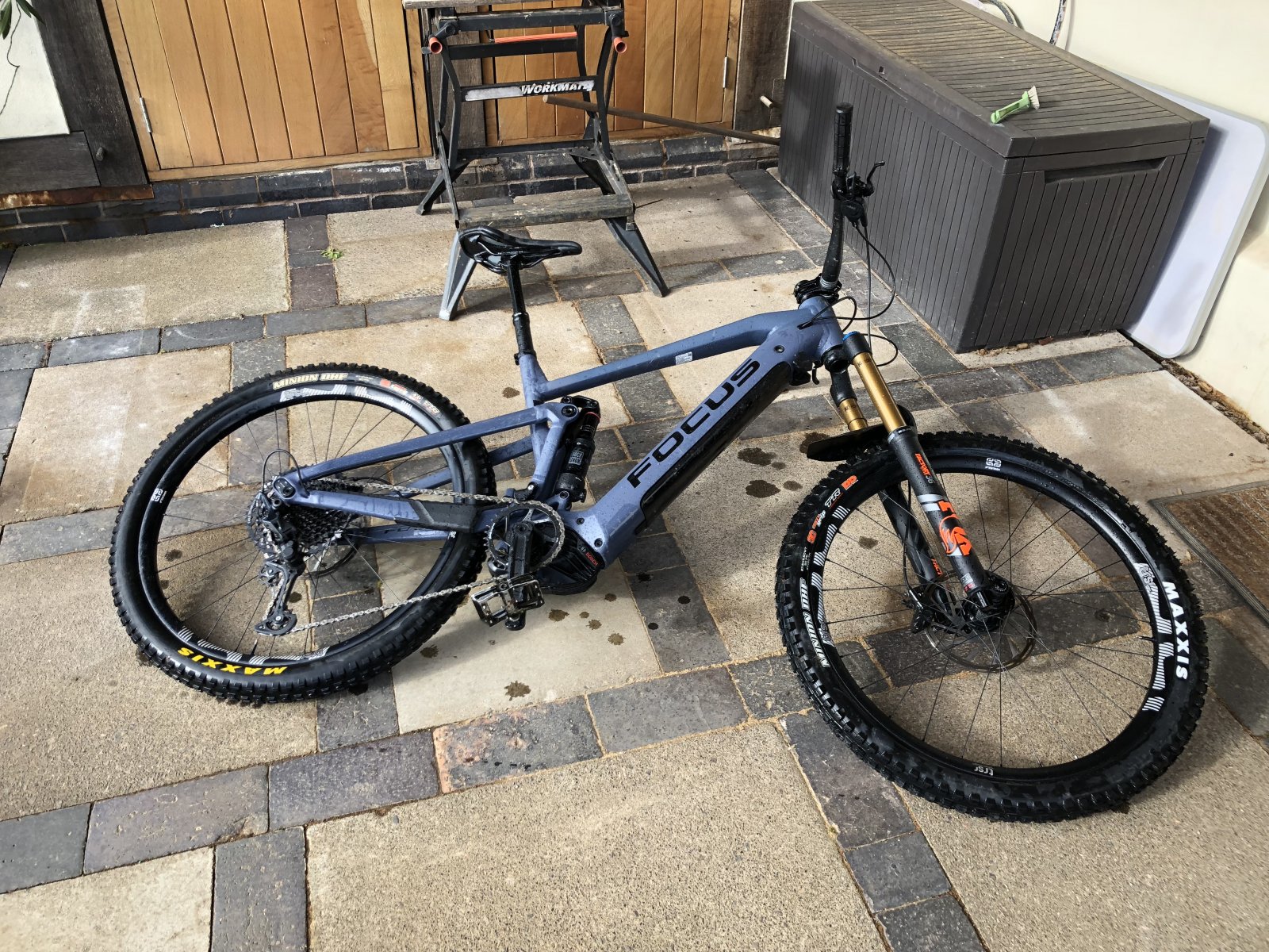

Took the jam2 Bosch for its first ride today (finally over my man flu thank god).
Set up with 27.5 wheels in low mode with 170mm fork.
Very very impressed with it. Motor is nice and powerful, definitely feels more powerful than the shimano and about the same as the brose mk2. I was pleasantly surprised by the noise levels, not as bad as reviews say and I think quieter than the shimano.
Bike handled really well. Snappy in corners, jumped well. Brakes were plenty adequate.
I can understand what reviewers say about lack of support when things get rowdy, but its not as bad as they make out. Its probably just down to the fact the shock has no compression settings on it at all, not even a lockout. I think I’ll swap the shock out and then it will be perfect.
For £3.3k I don’t think you can get a better ebike.
Its certainly rides a lot better than the Canyon Spectral 6.0 and I prefer it to the YT Decoy which are its nearest price point competitors. View attachment 26907

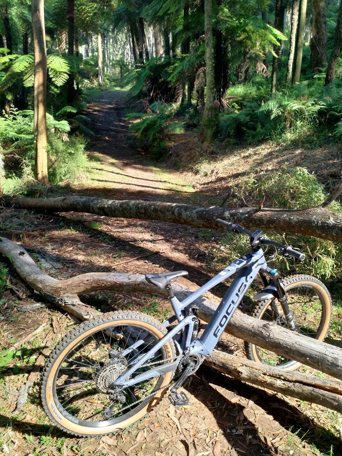

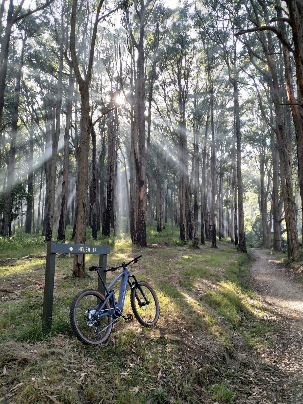

I finally added an ebike to my stable and went with the 2021 jam2 6.7 nine
I thought the spec was lacking but happy with the frame and motor so immediately switched out a bunch of parts from the bike it's replacing.
- manitou mezzer pro @170mm 29"
- nextie asymetric carbon rims (mullet) with industry 9 hydra hub in the rear and a hope pro4 in the front.
- 200mm brand X dropper post
- formula cura 4 brakes
- swiss stop catalyst rotors (203mm)
- joystick analogue carbon bars
- joystick binary 35mm stem
It's an absolute dream to ride and my other rig has been totally ignored. I found when I jumped back onto it, I thought the hub was binding but it was just the lack of assistance.
Anyway looking to do the final mod and want to fit a manitou mara pro shock to replace the stock deluxe.
Has anyone fitted this shock on a jam2 or any others that fit? Clearance looks tight! Fwiw the frame is an XL.

The mezzer is fantastic. It's the best fork I have ridden, the chassis is very stiff, it holds a line well through rock gardens with deflecting and because of the irt you can run it plush in the initial stroke and have it ride high and not dive in the mid stroke. I replaced a grip2 fox 36 with the mezzer and it's worlds better imo. There is a spreadsheet on the mezzer thread on mtbr which I found spot on for getting it set up.

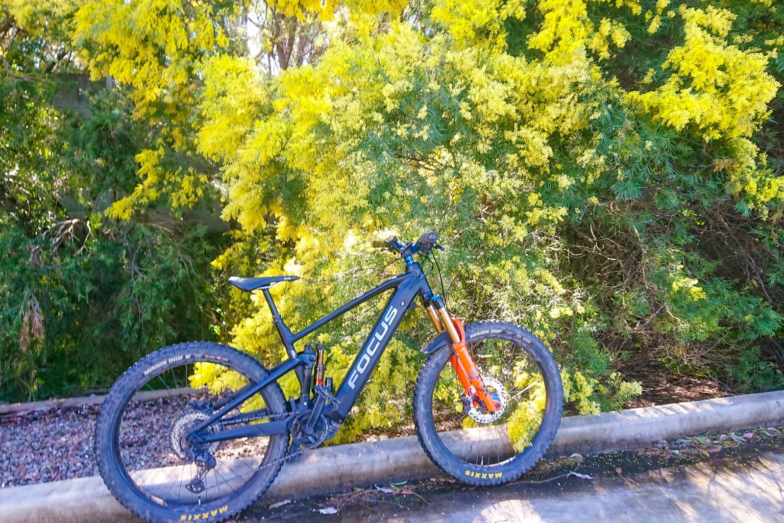

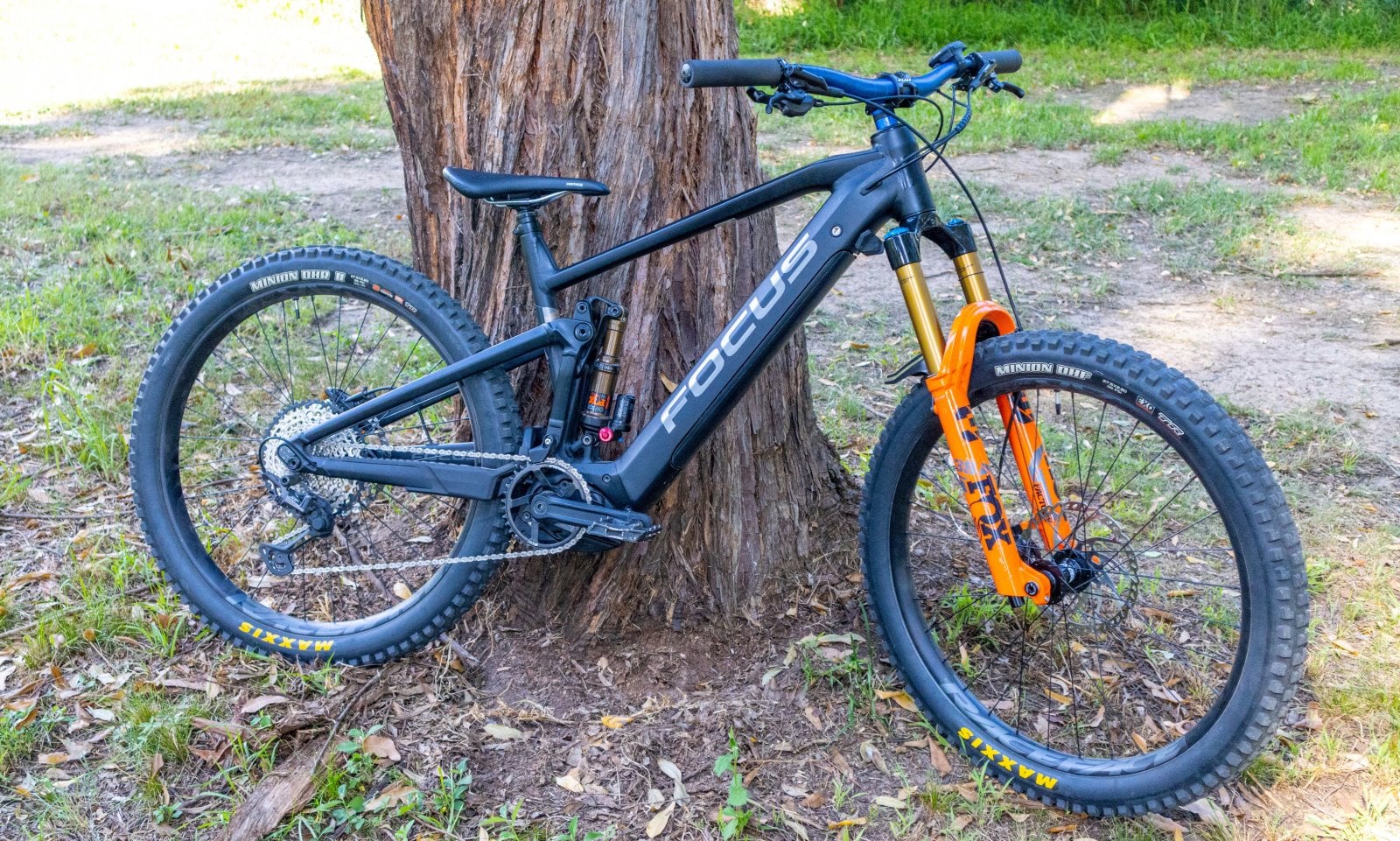

2020 Focus Jam2 Plus
Current mods - 36 tooth chainring, XT shifter, 35mm stem with 35mm rise bars, Wolftooth Fat Paw XL grips, Bontrager Montrose saddle (had it on my Trek and loved it), One-Up 170mm dropper with PNW lever, Maxxis DHF / DHR II tyres.

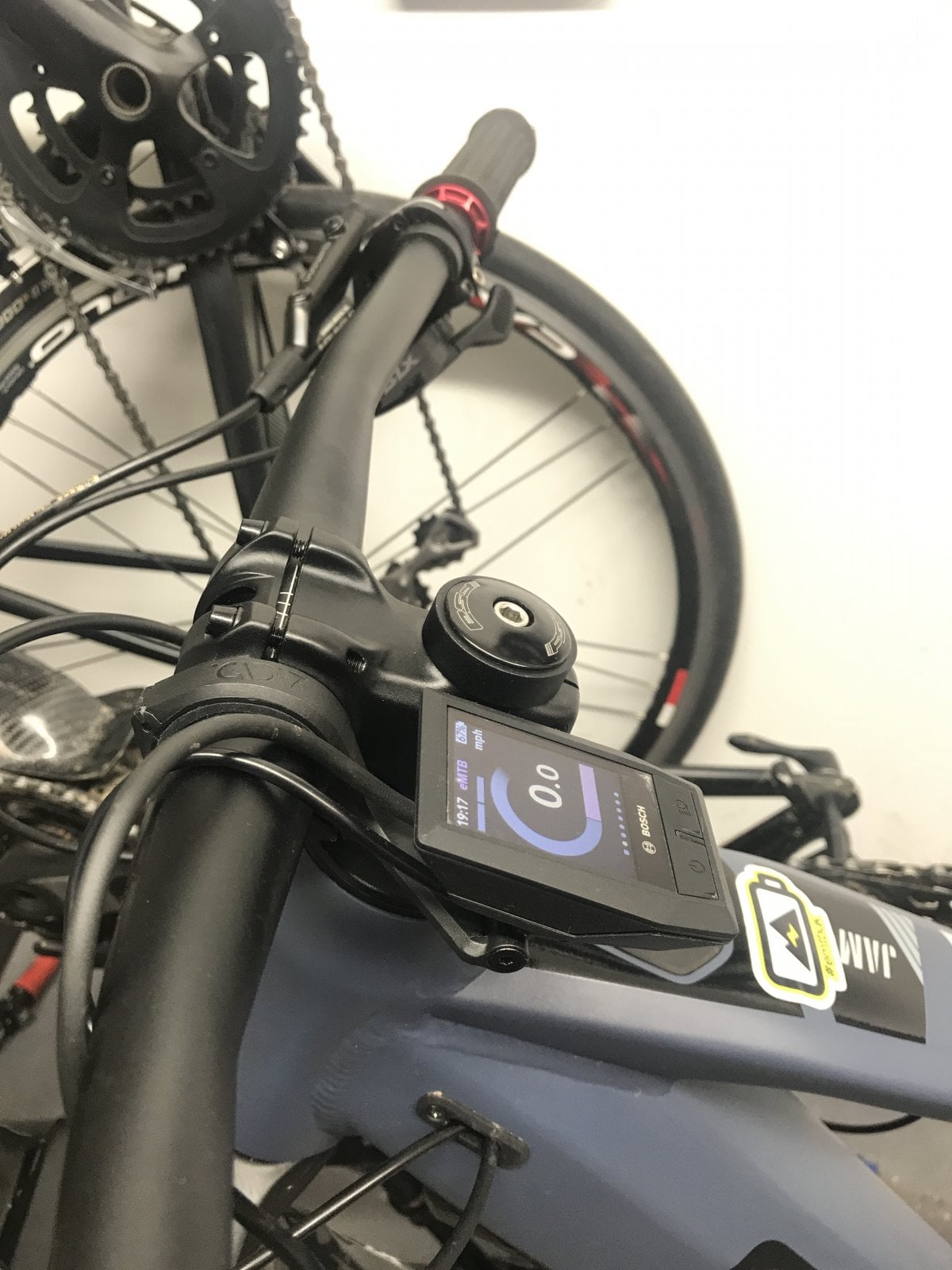

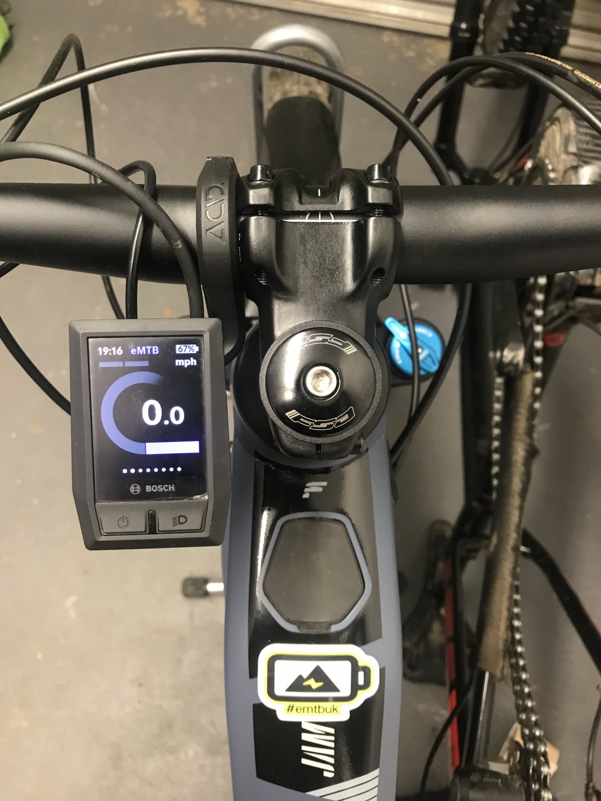

View attachment 26946 View attachment 26947

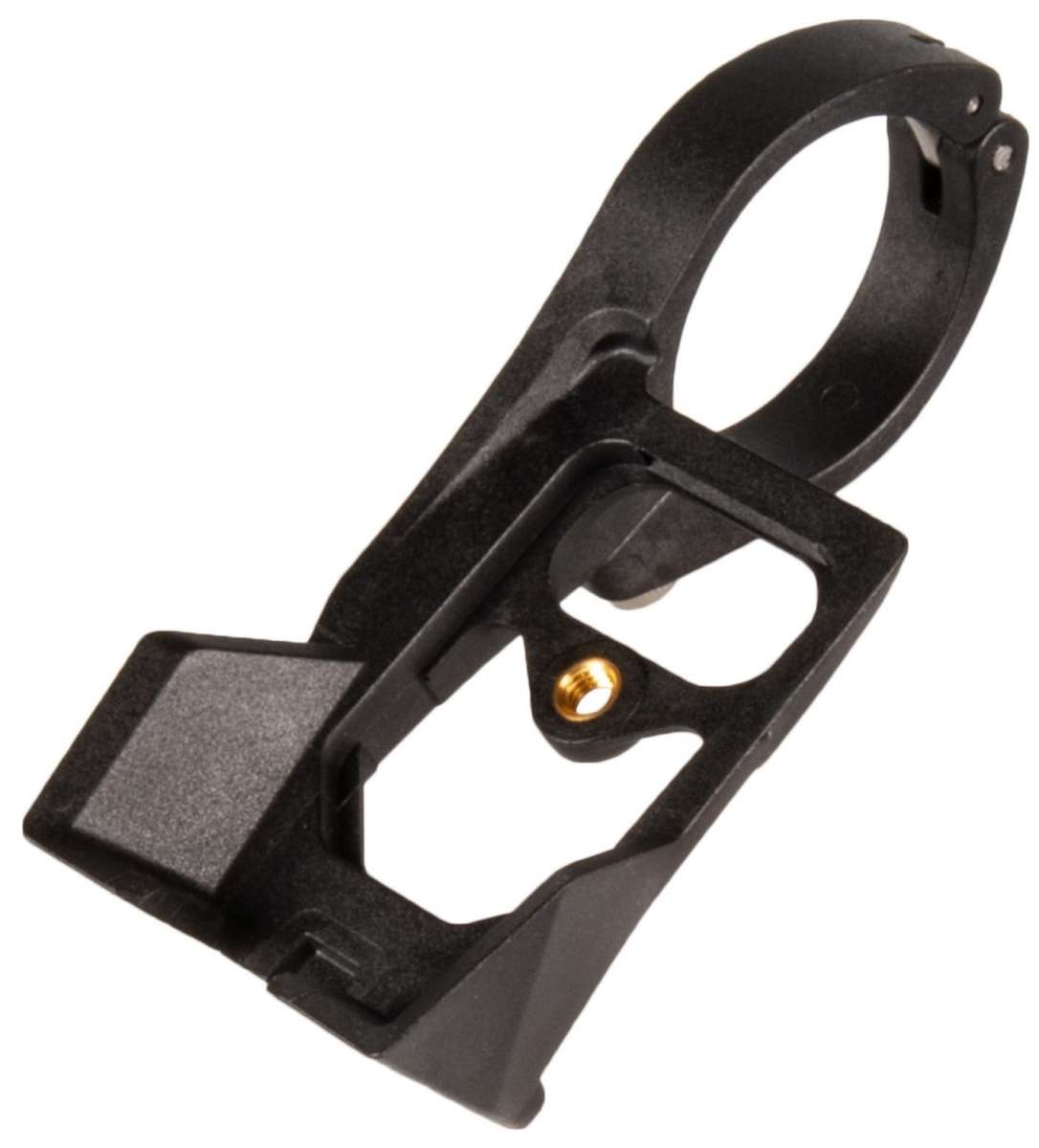

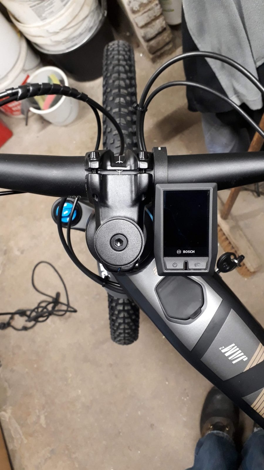

Fitted the new bracket for the Kiox. Looks a bit better but still quite a bulky display to integrate nicely. It’s already got a chip in the corner of the screen too, not sure what longevity it will have. Does anyone know how easy it is to swap it out for the Purion display? Almost positive at some point I will set off for a ride without the Kiox and not be able to turn the bike on ?‍♂️?
I mounted the KTM bracket!

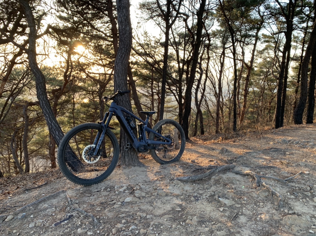

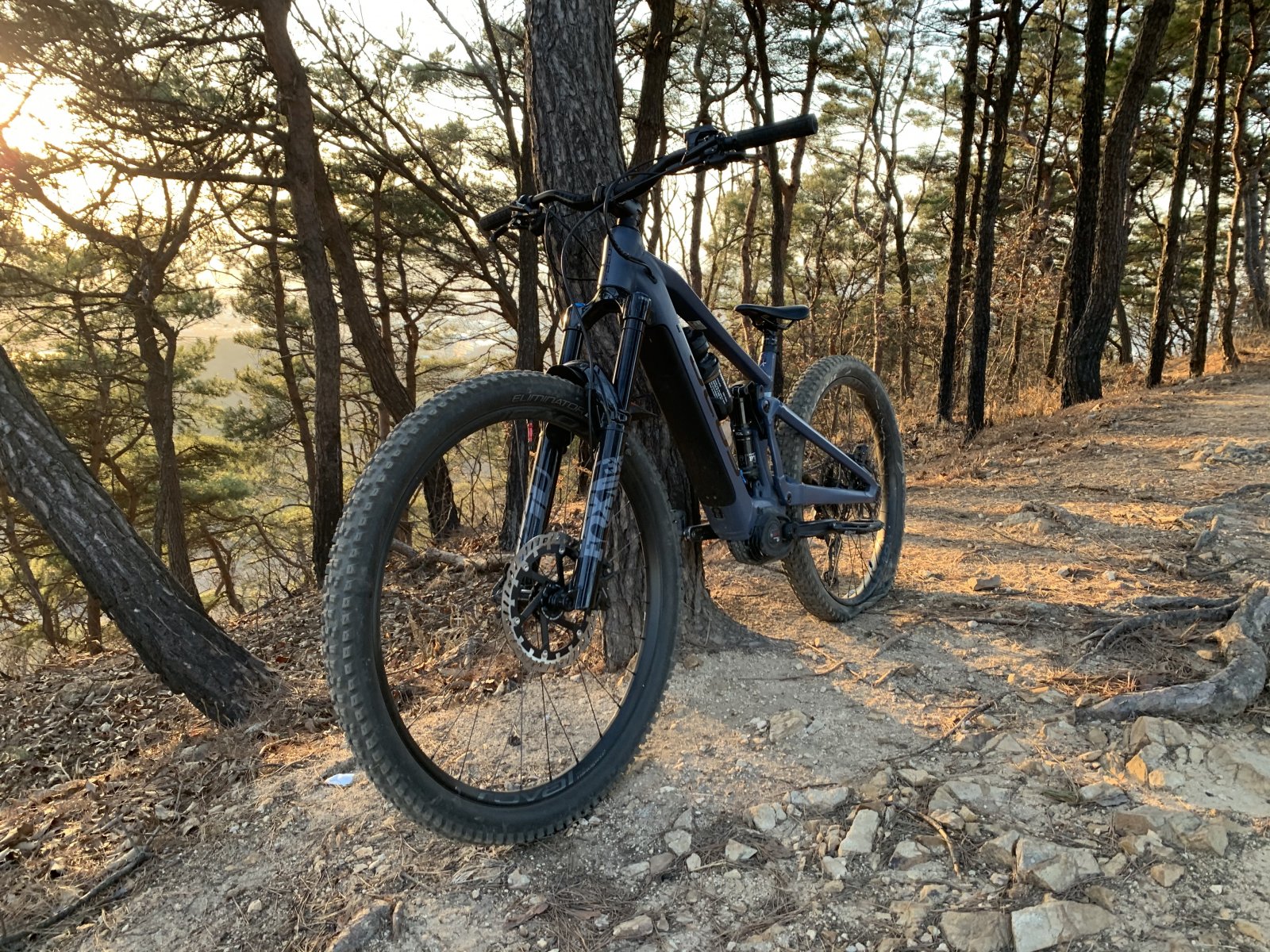

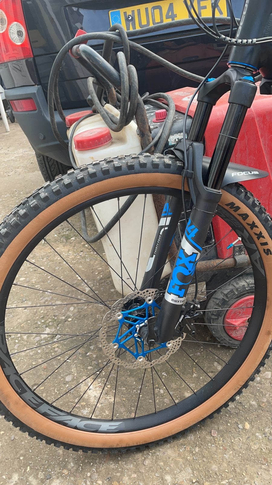

2020 Jam² 6.7 plus with 29” wheel up front. Fox 38 170mm fork 44mm offset. Different bars off one of my other bikes until I find what I want to put on for good. 220/203 Magura rotors. Old Chester pedals. Everything else is stock and loving the bike!! I’ve had it about 3 weeks now and put 243 km on it already

Myskovon. - Also when you have connected the Acid handlebar Kiox mount can you post photos and give feedback. As I am interested in moving Kiox display too
The Kiox holder from KTM looks better! It's mounted on the rightside of the stem!

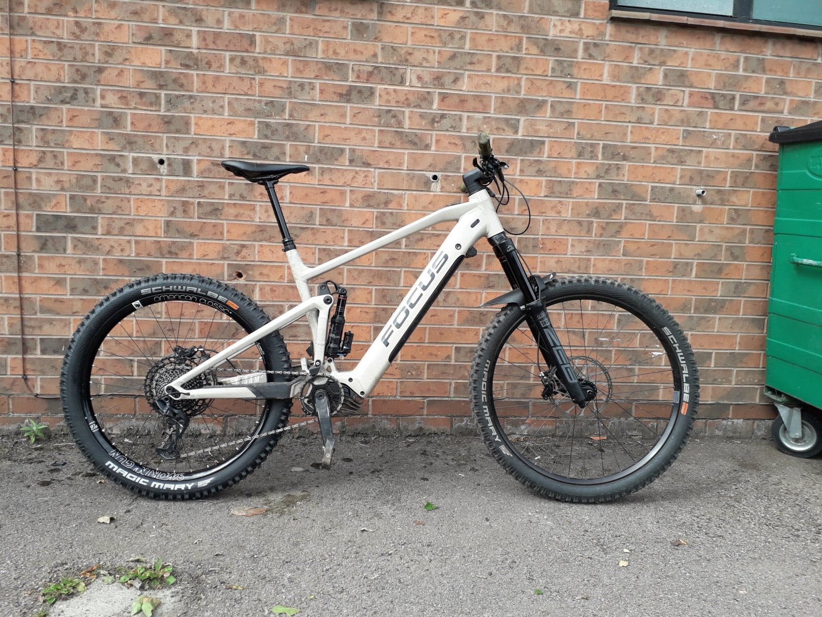

Business up front, party round the back.
Yes, gone mullet.
No downsides, even with the flip chip on the low setting not getting too many pedal strikes and the bike is a lot more agile.
Picked up an American Classic Smoking Gun 27.5" rear wheel which seems to be a smart bit of kit and stuck on a 2.6" Magic Mary on it...

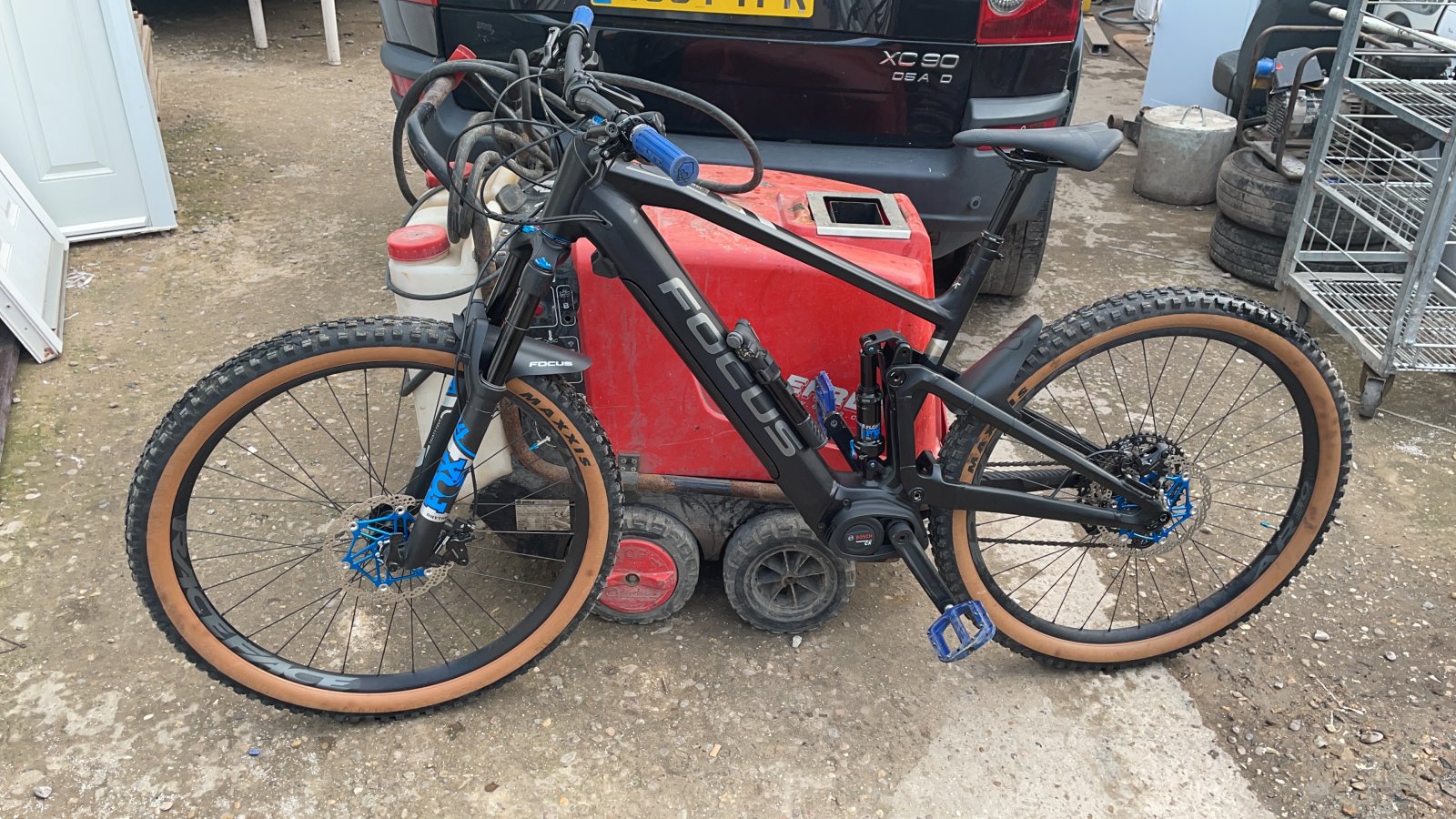

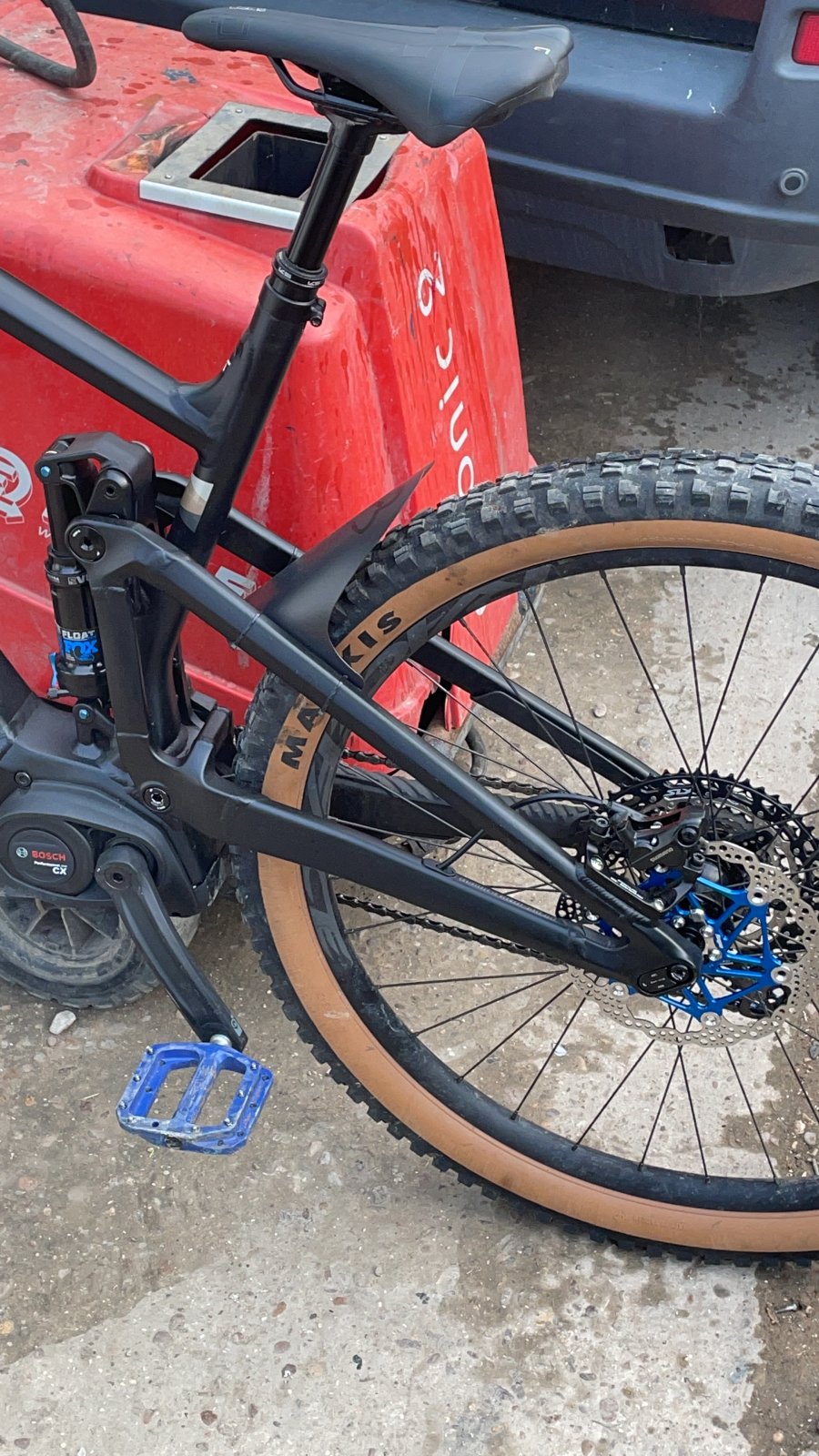

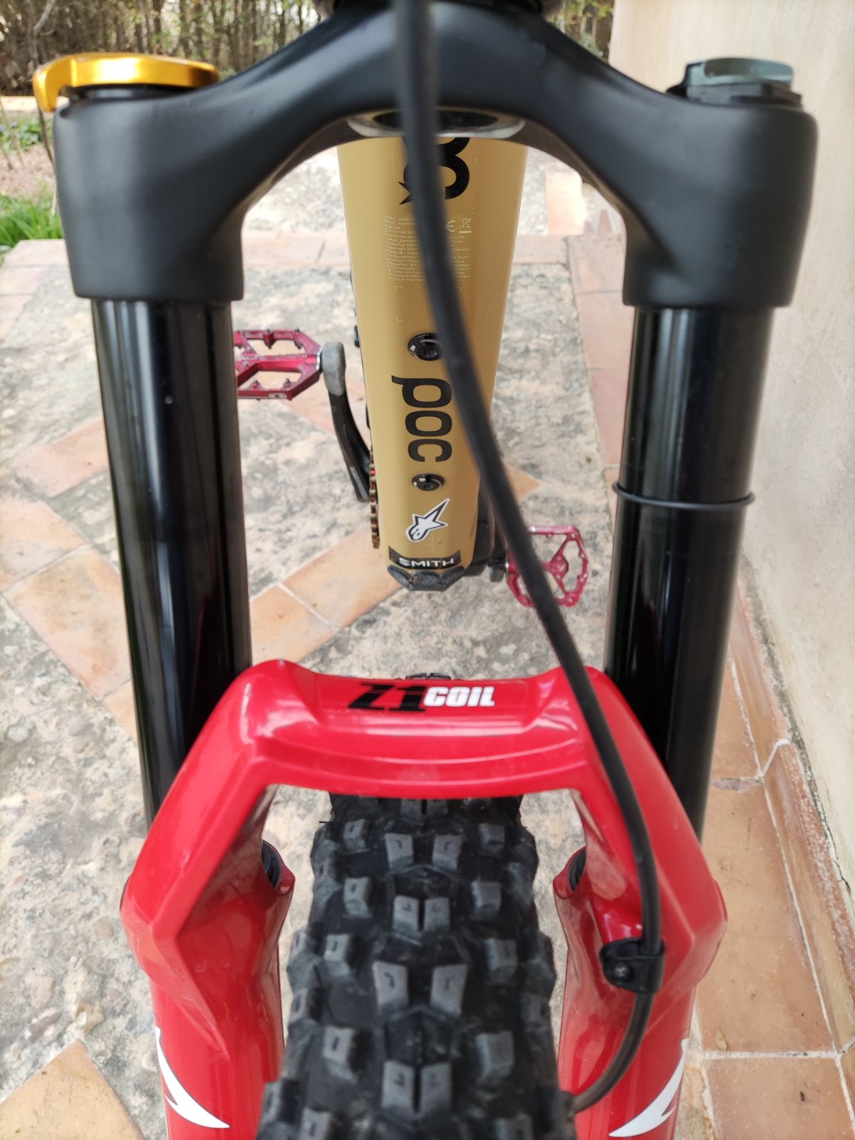

Made a few mods over the last 12 months..
Renthal stem, Hope bottom headset, Cane creek top headset, Boxxer forks with a custom top yoke, Hope mullet wheel set, Hope tec4 V4 brakes, Hope discs, Spoon saddle...

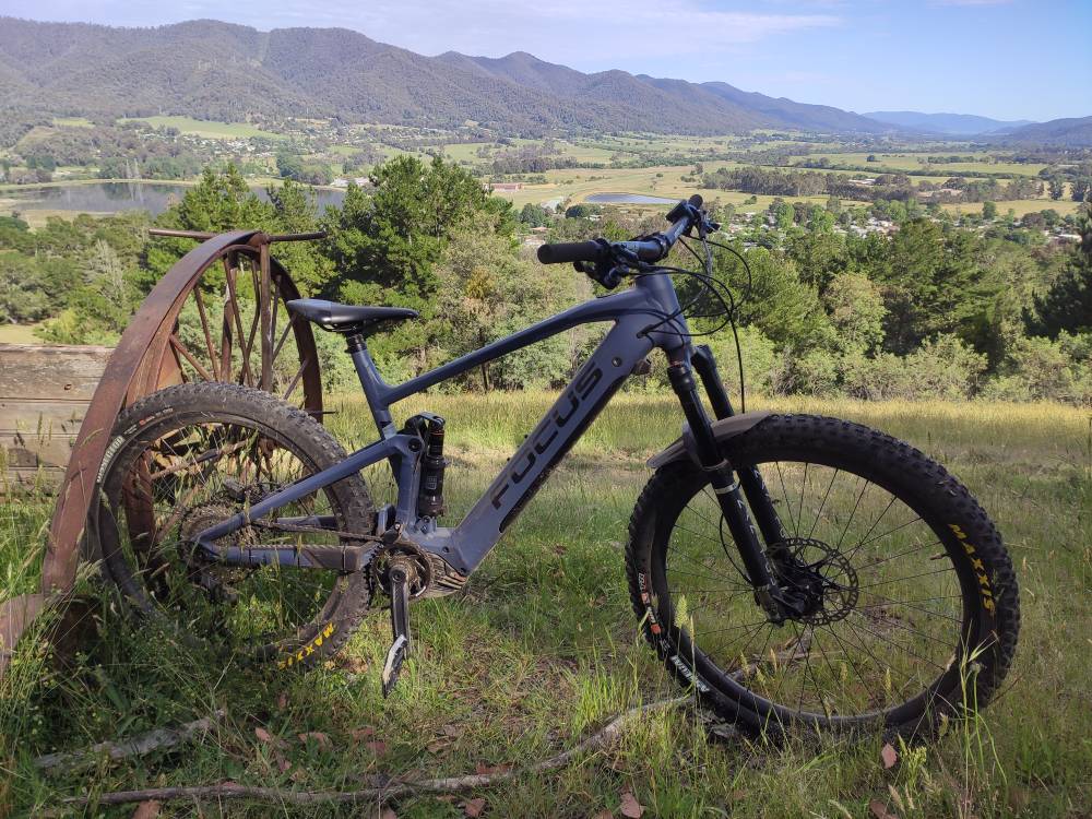

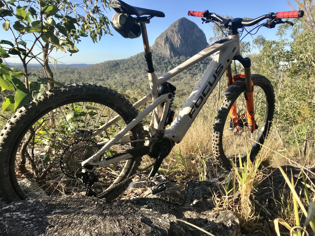

Diety 30mm rise bars, Saint flat pedals, red Hope floating 220mm front disc with a Cleanskin caliper mount, matching red Snail brand floating rear disc, Ergon Ebike seat, gone mullet with a Hope Fortus 30mm-27.5 rear wheel shod in a 2.6 Magic Mary, Kiox display with a Jam handle bar mount, with the smaller Kiox controller and some red Oury grips.
Most of it sourced from my old e160 900E Merida before I sold it.
Loving the better DH capabilities of the new steed, and of course, the more grunt from the Bosch motor over the Shimano 8000 and the bigger, fresher battery.
