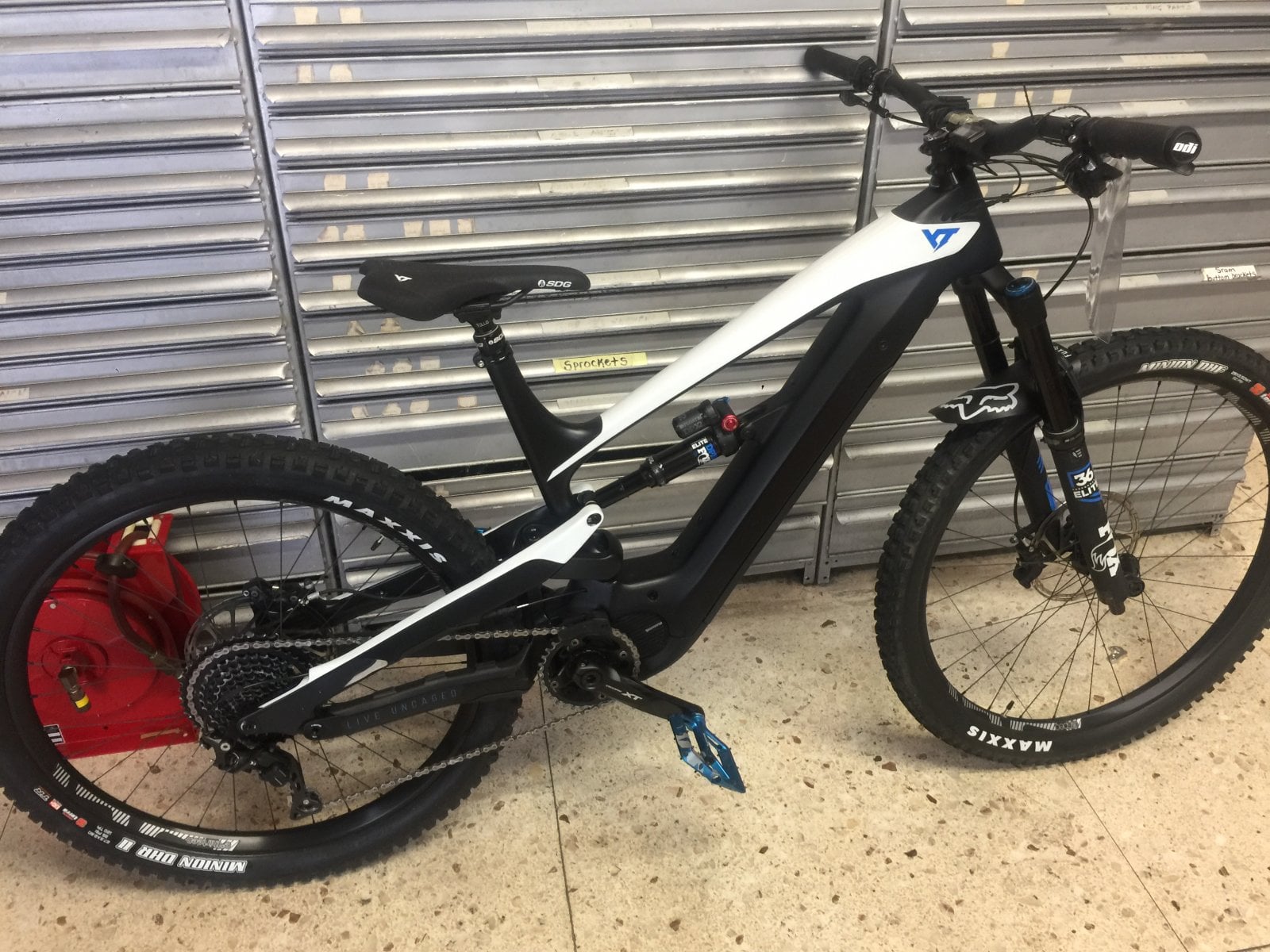

I really like this bike and I really wish I could sell it. The YT Decoy would be perfection with a better motor, but the E8000 has let another rider down. View attachment 19134
That is a sick looking bike though!:) sorry about engine.. if this forum has done anything it's enlightened me to all these shimano (and others) issues happening.
Hope the new bosch turns out to be more reliable.

So did it just power down completely and is dead, or what’s the story? Mine has cut out on me a few times unexpectedly requiring me to turn it back on, it’s always instantly turned back on without that problem. Figured there’s just a loose wire/connector somewhere and can’t be too hard to get fixed. Nothing I can’t live with until riding season is over which won’t be too far away and then send it in for warranty if need be.
check your battery cradle is tight and adjusted properly. They do come loose/move. and can cause exactly the power cut out you describe.
Also remove the connector bay cover and check all connectors are clean and dry. it's not very well sealed. and on certain bike frame designs actually has a completely open portion towards the top/back that allows dirt/water to get in from behind. I eventually motofoamed around the top of my motor and siliconed/taped the case cover and it solved the water/dirt ingress issues I had frequently with my first motor. i do this from new now on all my replacement motors.

Just for fun since I was working on a 2016 Levo, I decided to weigh the YT against the Levo. The YT weighed 50lbs 14oz, the Levo weighed 51lbs even. So the YT weighed an ounce less.
Solved the motor issue backtracking the connections and tightening up the battery. Great bike, okay motor.
