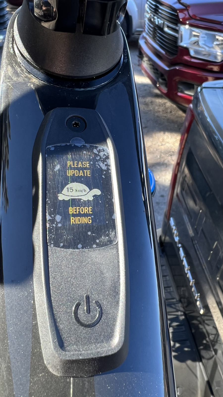

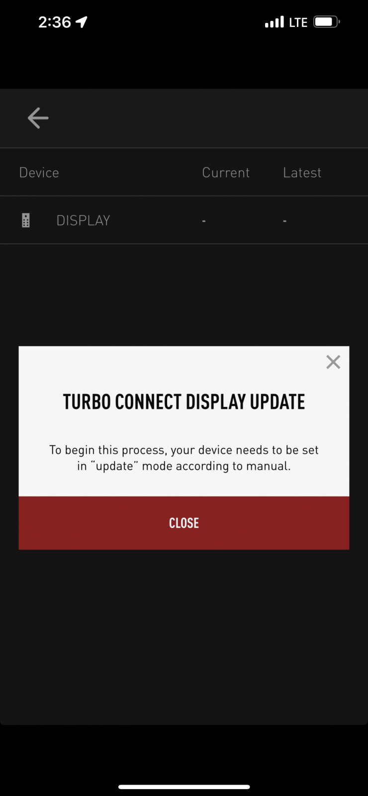

Hi everyone,
I'm new to the forum as I just bought a new Kenevo SL. Excited to get out and ride it, but getting the errors in the pictures below and not getting an option to update the firmware in Mission Control. Here are the steps I've taken to try and resolve it:
-Removed and re-installed the Mission Control app.
-Completed a factory reset through the TCU display by holding the "+ and -" buttons on the handlebar control at the same time and the display re-boots twice and then says it's reset.
The mechanic at my LBS is reaching out to Specialized as well, but hoping that someone on here has experienced this.
abomb
Nov 15, 2021
Ruidoso, NM
Hi everyone,
Turns out this is something that only the LBS can do, so I'm taking it back there.
