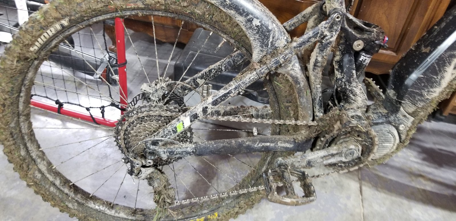

Looking for winter traction levels, I decided to try the tannus armour with a 2.5 exo shorty as rear tire. The shorty's story is more of the same. Originally installed tubless on front wheel, and punctured almost instantly.
I've got it installed now and will try my best to ruin it.
DrStupid
Jul 10, 2019
1,464
2,129
Pleasureville Ky
I threw everything I had at it today. Granted speeds were down with how gloriously muddy it was. I did try to do it harm, but the exo casing shorty with the armour will fight anouther day. Rain in the forecast.

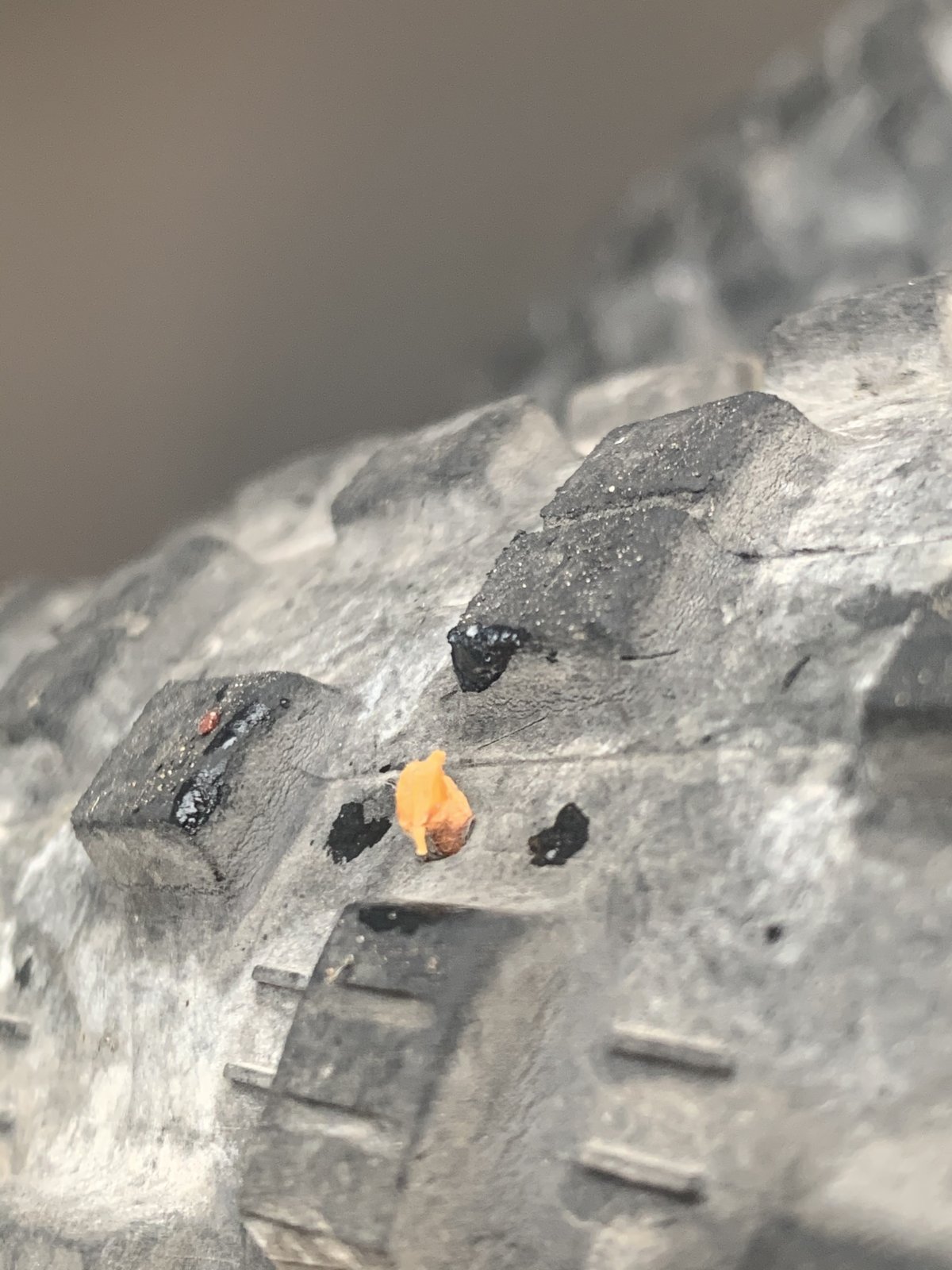

The Tannus Armour saved me a walk home recently.
I've been gifted a cycle computer which I was fitting over the weekend, when I notice (what I thought at first was bubble gum) a pink/red line on my rear tyre. It was a cut of around 20mm & it was the armour I could see.
The armour has a slice in it too, but not deep enough to get to the tube.
I need a new tyre, but that's all.
At a guess, it looks like something very sharp like glass was the culprit.
It's saved the day for sure. Big up for Tannus Armour (y) (y) (y) (y) :):)

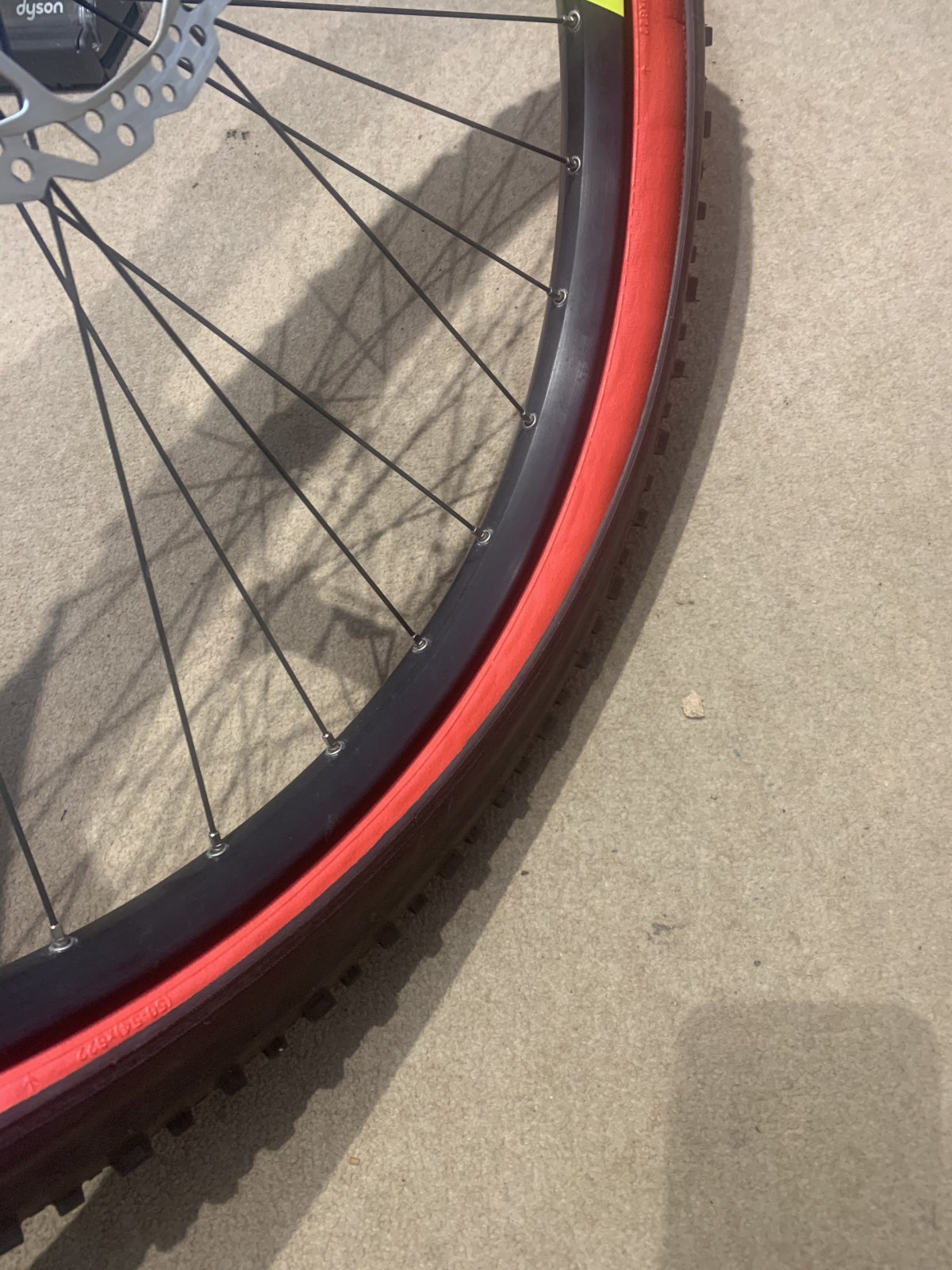

Just fitted one in the front this morning. No tyre levers needed. The tyre just popped on by itself. 5 minute job once I had removed the old tube.
1) break bead on one side of tyre and remove old tube
2) insert armour all the way around
3) insert partially inflated new tube into armour putting the tyre valve through the hole first
4) press the edge of the tannus flap into rim and repeat all the way round (see photo)
5) deflate tube completely now in order to get tyre back on
6) put soapy water all the way around the rim
7) start from valve end and work rim of tyre back on bit by bit.
8) if you do feel resistance towards the end then simply pinch the tyre at various points inwards. This puts the bead into “V” shaped valley inside the rim and creates slack. The tyre should now pop on easily
7) I used a battery powered pump to inflate to 30psi at which point the tyre was perfectly on the rim.
