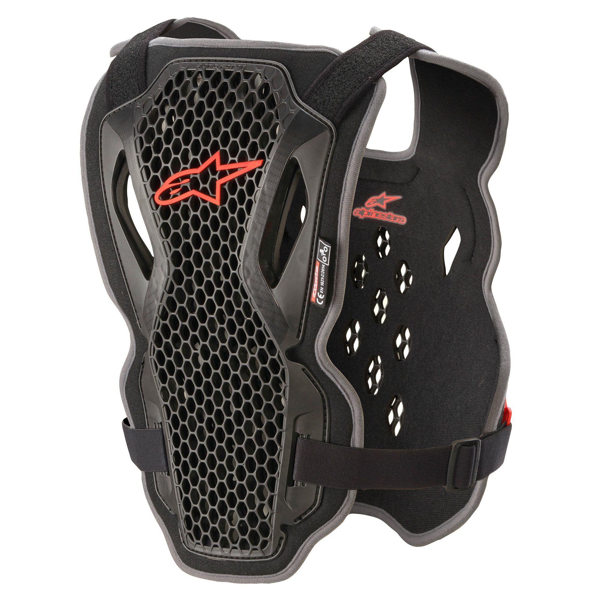

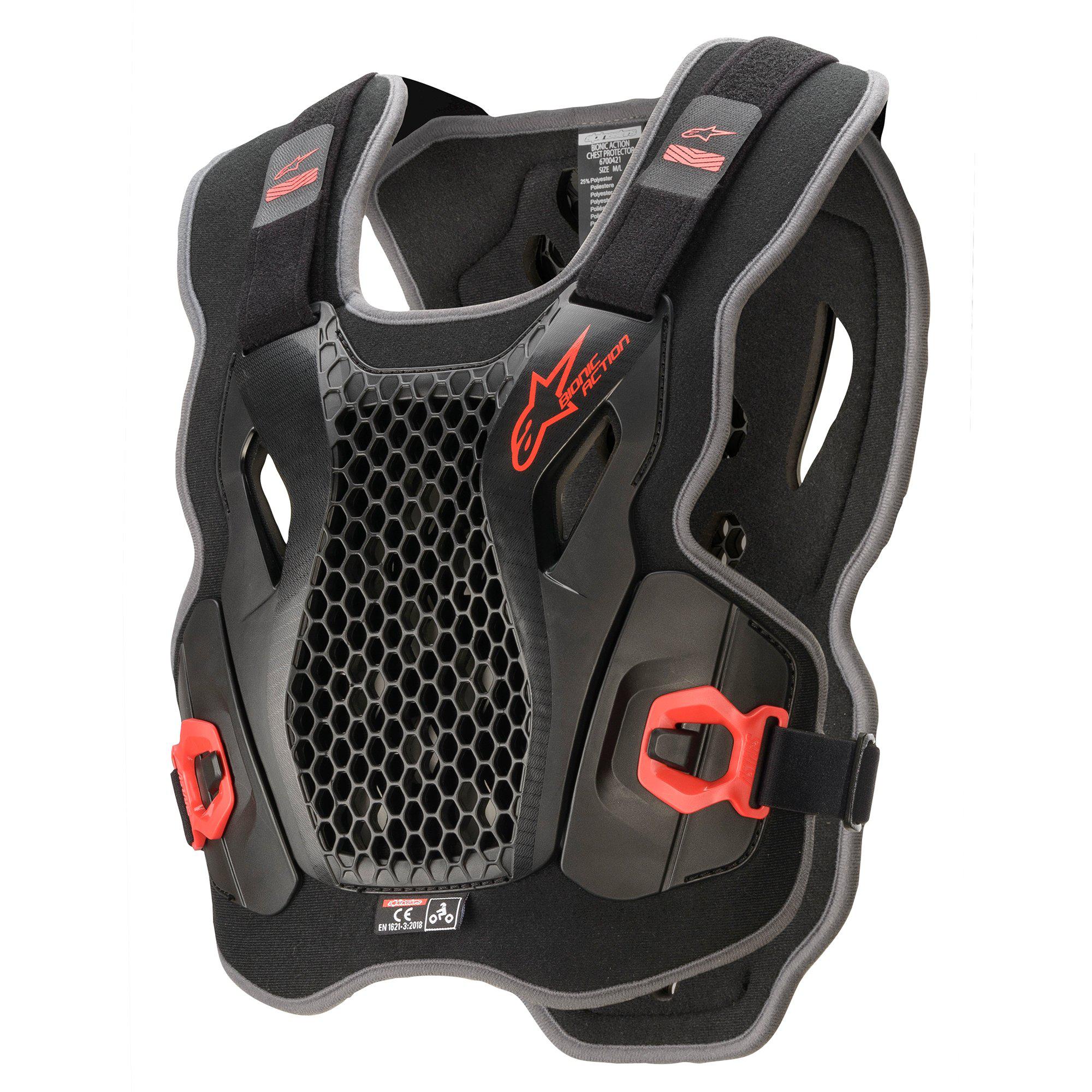

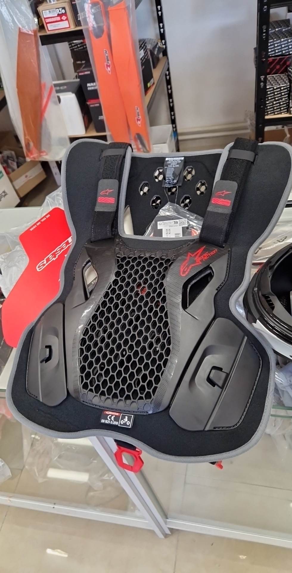

finally at home. first I would like a buy alpinestars A6, or A10 chest protector, but it was unavailable.
80e in motoshop, so lightweigh,airly and good sizing for big guy.

I've not tried that one. I really like Alpinestars gear, but for MTB everything I've tried so far is too hot - they always have what looks like great ventilation, but it's normally limited on where the air actually comes all the way though.
This one was much more lightweight, had crap protection and got really hot :
This is a little more like the one you're looking at, but compared to most other things it was uncomfortably hot.
For really excellent front and rear protection there's the RXR protectors. The main downside again is heat. I've modified mine, but I'm still not super happy with it.
There's dozens of different vest type tops. I've been re-trying several of mine lately that I didn't give away, but I still find the TLD7855 the coolest to wear - the padding doesn't get as warm as D3O type protection and it just lets the air through better all over. Doesn't sound like it would fit you though.
There's the racer, not sure it would go big enough and the chest protection is minimal :
There's various Leatt ones, and whilst I like a lot of the Leatt armour I didn't keep hold of any of the tops I tried, thye all seemed a bit lacking in overall protection with the armoured sections being too small.
Forcefield would make things which would fit you, but they get a bit too warm on an MTB.
A Troy Lee 5955 would protect well (Hard plastic type), but the back protection is a bit short.
I think if I was about to buy a hard armour now for just chest/back, I'd probably go for something like the Fox Raceframe impact chest guard or even the Raceframe Roost Chest guard (lighter with less padding, but also cooler and the hard plastic will protect better than any of the reactive armours). You could wear them under or over a shirt and they look like they breath really well. If you overheat too much in your armour, you just won't wear it when it's hot.

Over the weekend, I tried the Alpinestars protector in two bike parks. In the morning it was around 18 degrees, in the afternoon it was almost 25. I rode first with a long jersey, later with a short one and protective gear on. Yes, I was really warm, but I think that the integral helmet, elbows and knee pads took more sweat than the protector itself. a great choice for me, if I could try the A6 or A10 in person, maybe I would make a different decision, but since I have huge shoulders, they probably wouldn't even fit me :D Either way, if we have guys on the forum with big chests and airport backs, I can highly recommend alpinestars. BTW, I had the option while waiting for the chairlift compare my Alpinestars with fox Raceframe or Leatt 4.5, alpinestars was clearly the widest in the chest area
