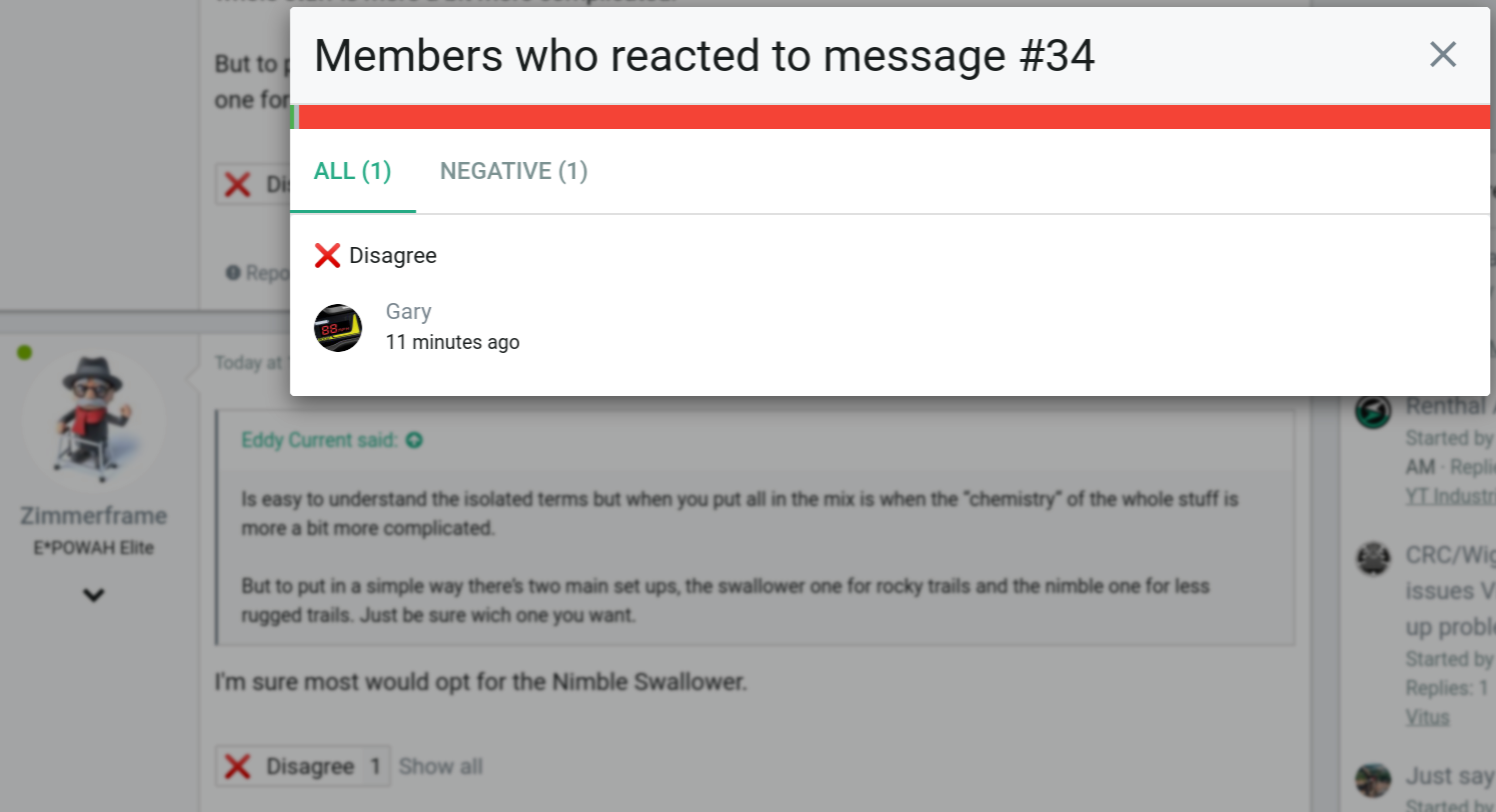

Just when you think you have your forum peers stereotyped, someone throws a spanner in the works.
