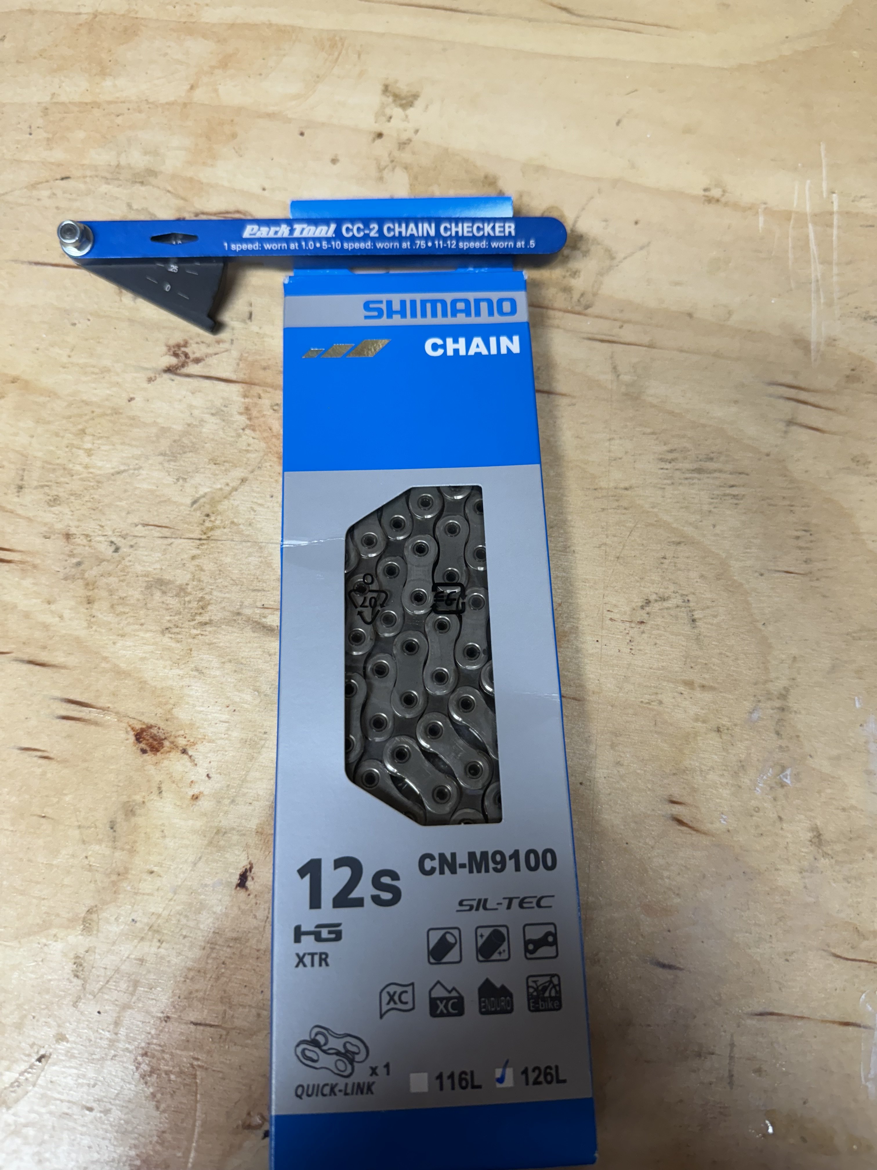

Update….bought the park chain measuring tool and let’s just say after 1600 miles the chain was out of tolerance 🤣😂🤪 biggest gap from normal is 1.0. If it could go higher it would have. Oppps. So bought a Shimano m9100 replacements at my local bike shop. Was going to get it on Amazon but apparently there are lots of fakes out there. Putting it on today we shall see what a difference this should make. Did not replace the cassette or any cogs as suggested. Will wait on that to see how the new chain performs. Not sure you can see the reading on the gauge but it’s a bit saggy 🤷‍♂️Wish me luck.
