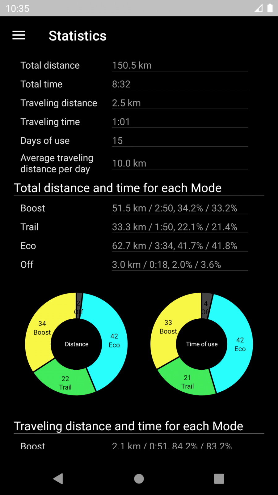

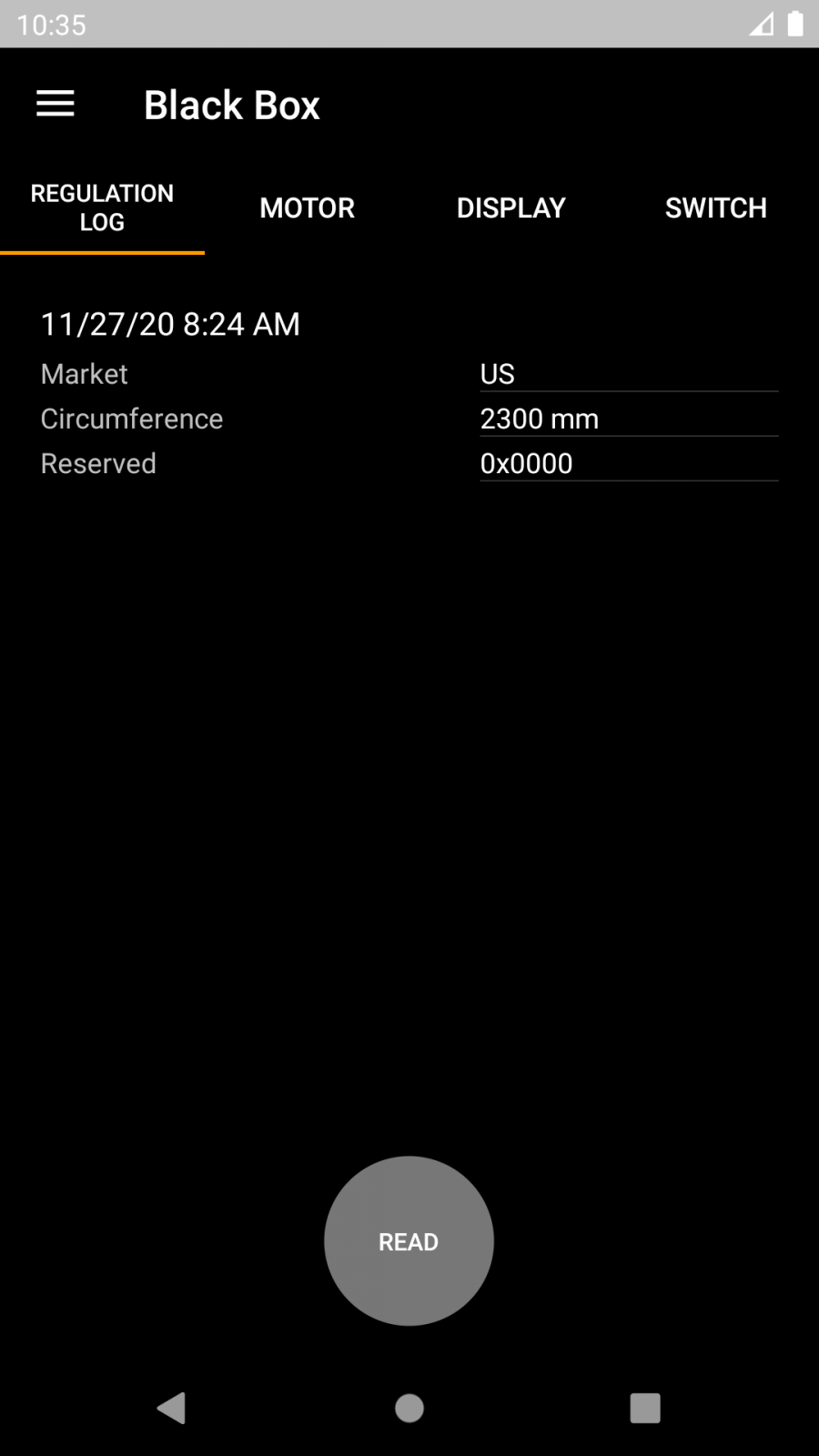

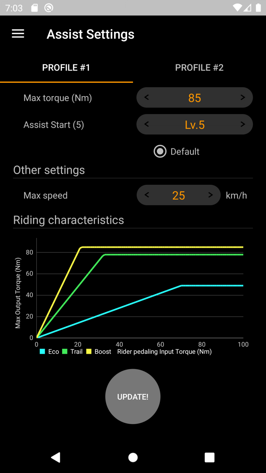

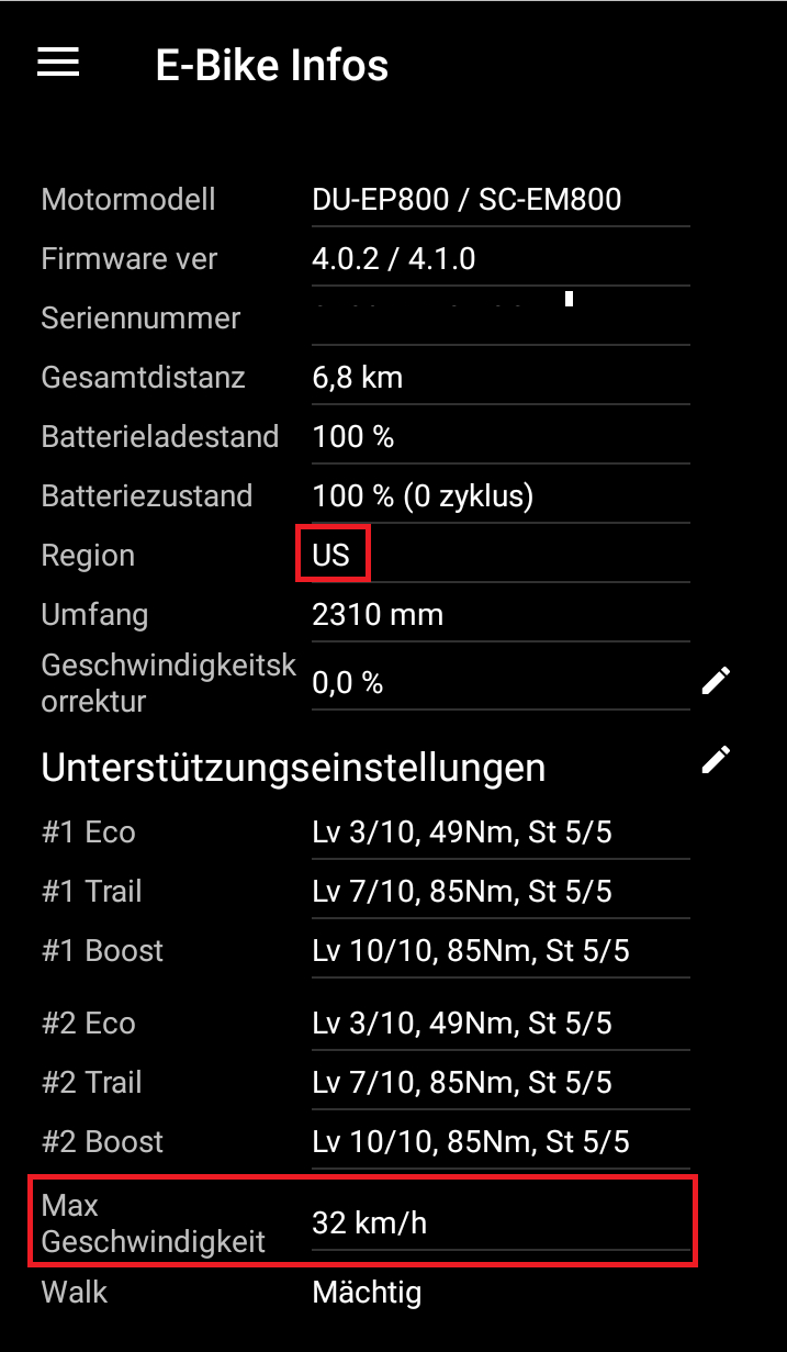

New App's features for EP8 owners.
EP8 collects some statistics and the App displays them. Moreover, EP8 has "regulation log", so all changes of Market/Circumferences are stored...
added: I thought the system does it automatically, and I couldn't check it as I didn't get my EP8 yet, but those "smart" guys from Shimano made an extra command to add an entry to the log. So, if you change the region in STUnlocker, no entries are added to the log.
