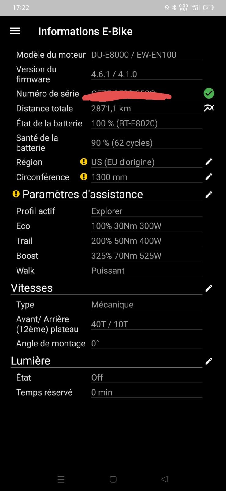

exploring 4.6.1 , as it's compatible with ew en100, it gives me a good cruise speed, spd is read on a small computer display from van rysel, exploring power and assist boost limits, no problem at 325% 525w atm, here south of france, direct sun, 37°c wheather. motor unit is warm, can keep my hand on it, counter side battery is empty quicker. chanring is bmx race 42t

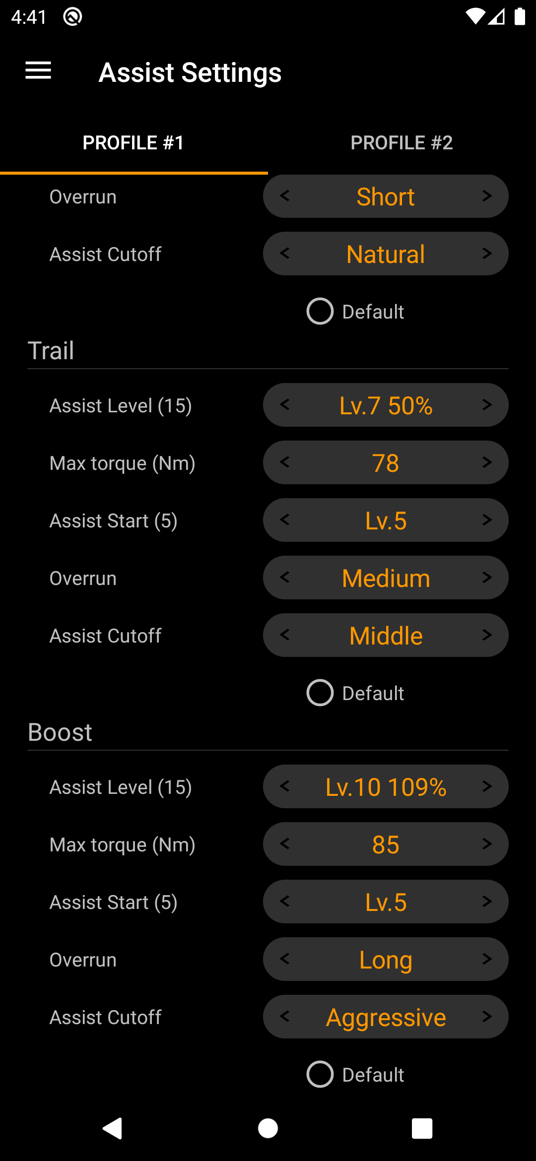

New 1.20 version is available. Suitable for EP801 with the latest 4.3.0 firmware which Overrun and Cutoff settings introduced. Unlike the Windows version of ETube Professional, where you can only set Overrun for the entire profile (for all modes), in STUnlocker there is an option to set Overrun for each mode, as well as a Cutoff.:
