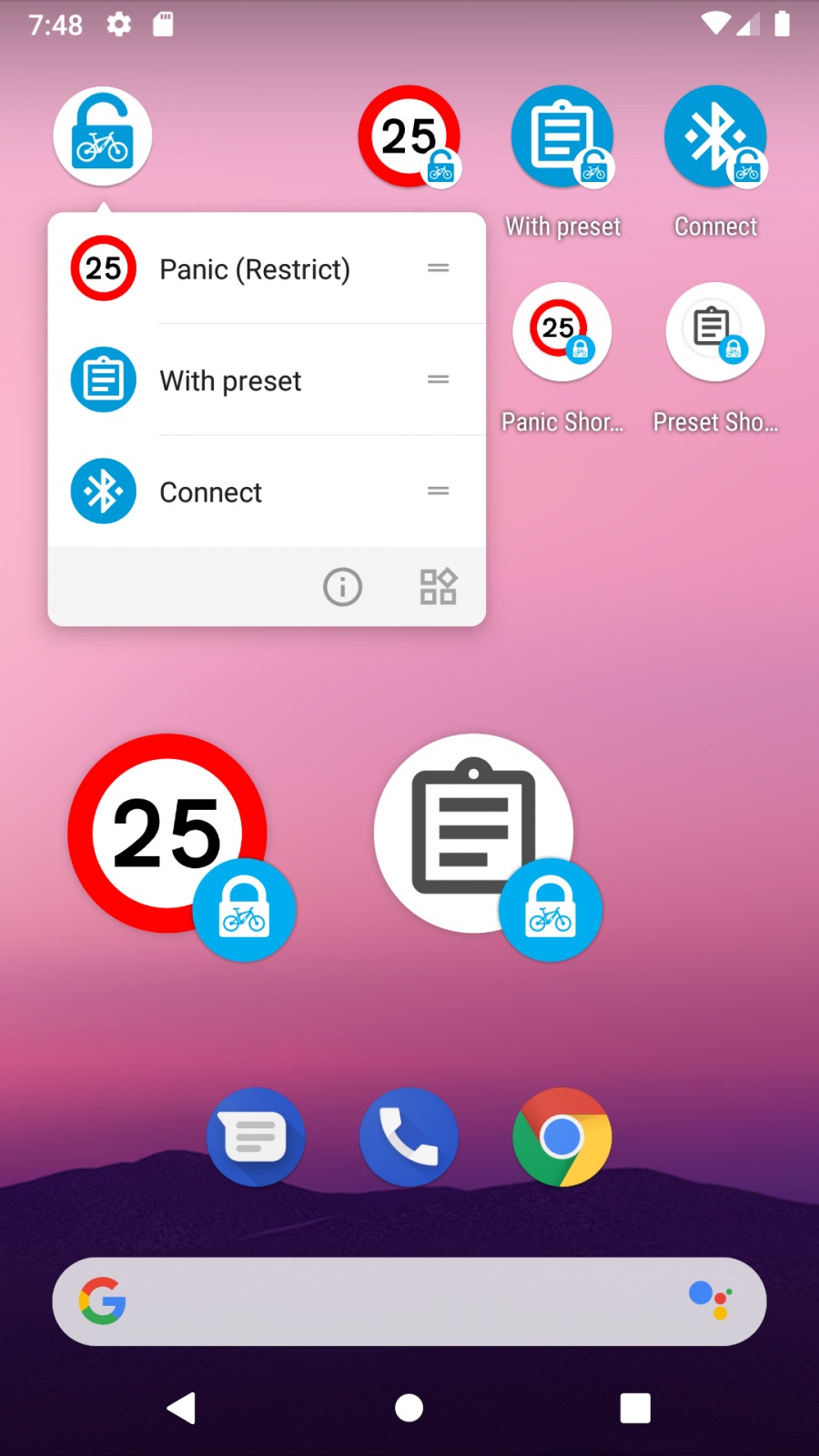

The new version 1.9 was uploaded.
- "Mount angle" can be negative now
- added the new feature: it's possible to select "Preset" which will be automatically applied after establishing a connection with the bike. It can be canceled. Some customers wanted this feature for a case of Police control...
vadII
Feb 19, 2019
812
583
Earth
New version with widgets and shortcuts for quick applying settings available at Google Play
"Panic" widget/shortcut for applying "Stock" settings
"Preset" widget/shortcut for applying custom Assist settings for bikes on which assist settings are not savable.
Updated manual includes all latest changes
