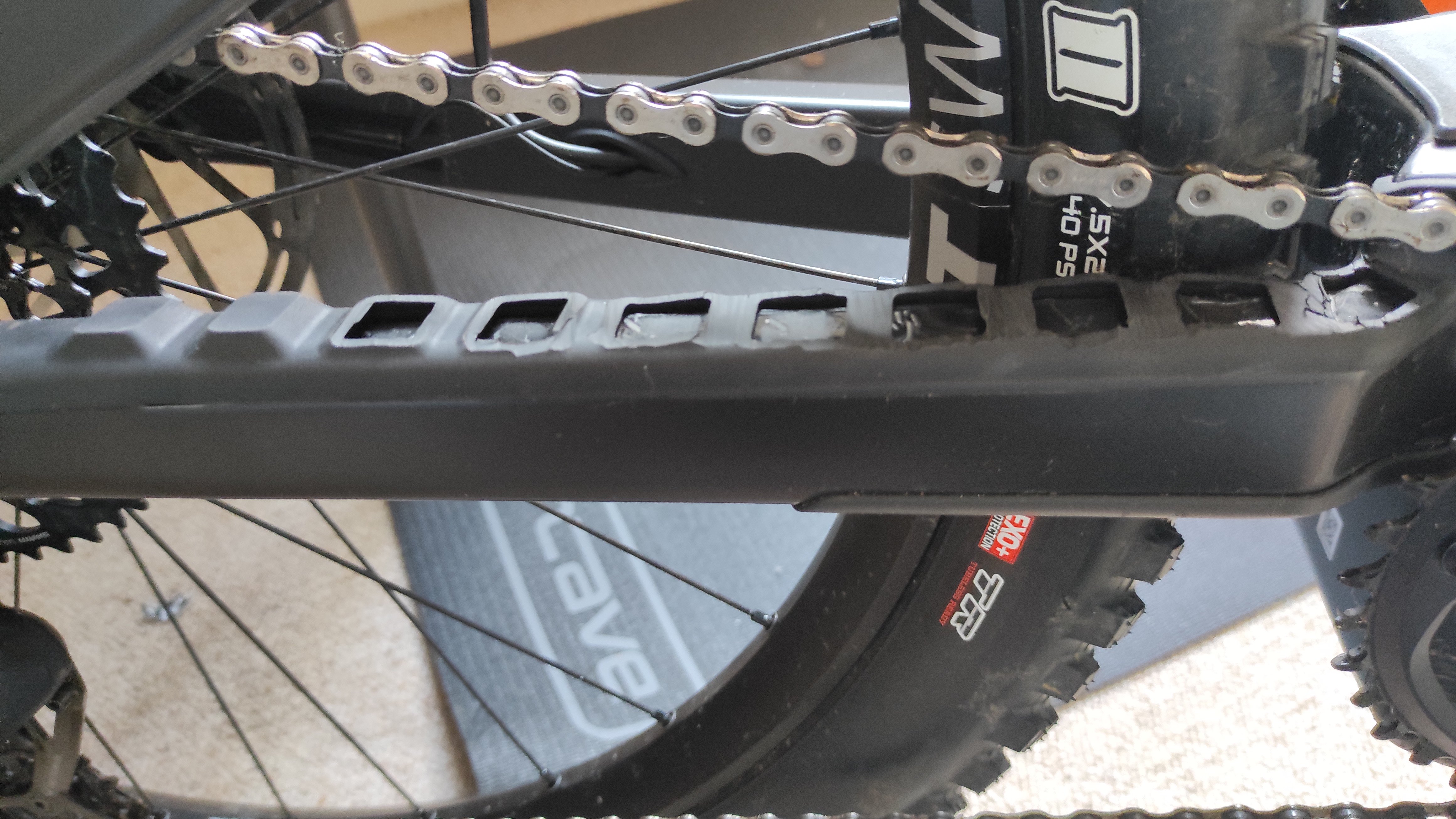

1. bottom bracket/motor height. It really touches everywhere, with consequent breakage of the engine/battery cover and also becoming dangerous in some situations. Obviously SAG and correct suspension settings (I've been riding mtb for more than 20 years and I bought my first eMTB in 2016)
2. passage of the chain, in the first 4/5 sprockets (!!!) it touches the chain guard with evident wear of the same. And it doesn't cost pennies, it's not found in the shop next door and in the idea of keeping the bike for a while, several will have to be replaced...

The chainstay position isn't a great design. I'd contact Canyon with pics of the damage and ask them to send out spares since you will be going through these quite often. The only other thing you can do is use an inner tube and wrap it round the chainstay.

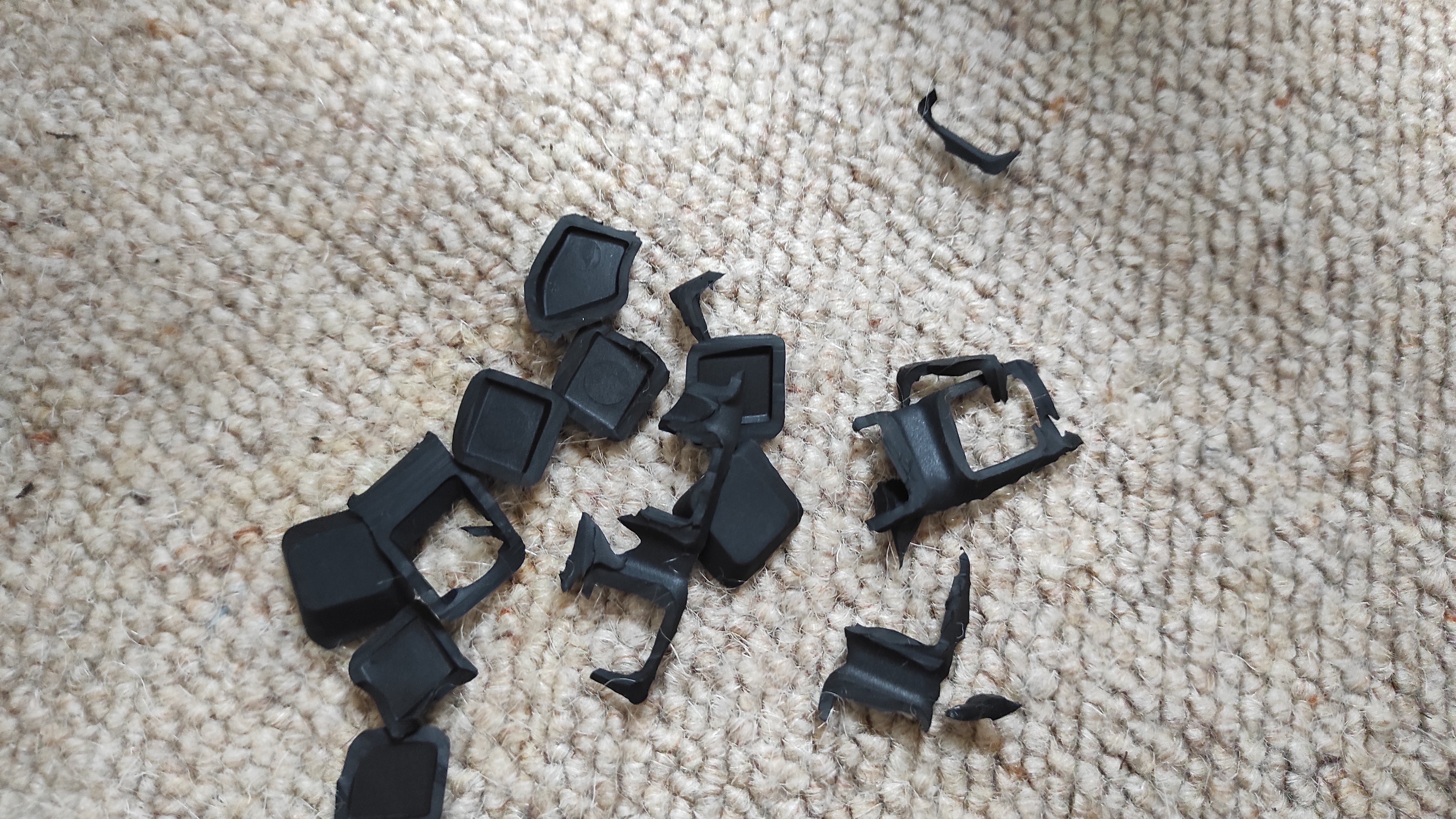

i did it, I think I'm probably just gonna remove the top part and replace it with inner tube or smth

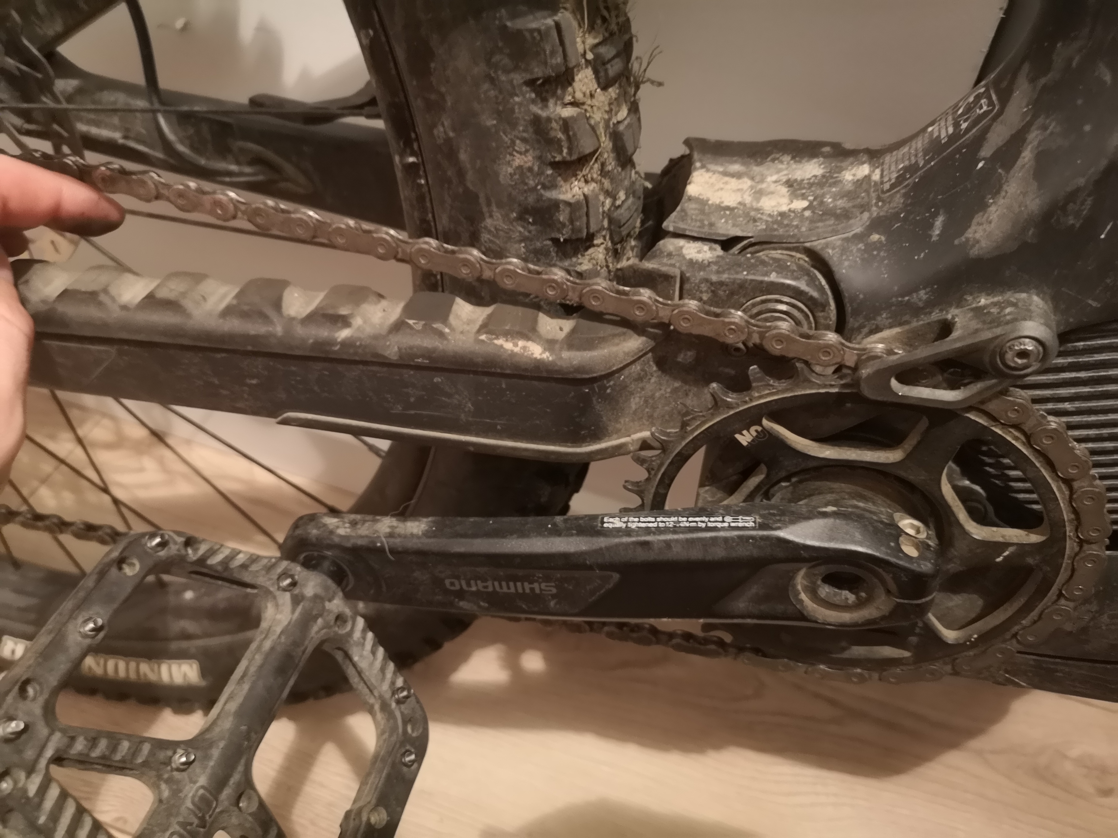

I attached photo after 1500 km in mud and dust.

Chain - Yes, chain touches the rubber sometimes. I do not see the problem. I see no wear on the rubber or chains ;-)

why did you cut out the chain stays.. you could have just wrapped it.. its actually functional piece meant to be there so the rear swing arm doesn't get chain slapped all too often..

Agree on the rubbing chain being a non-issue though I stressed about it in the beginning. I believe the sag takes it off the rubber anyways?!? 800+ miles on the bike and no wear on that rubber piece.
