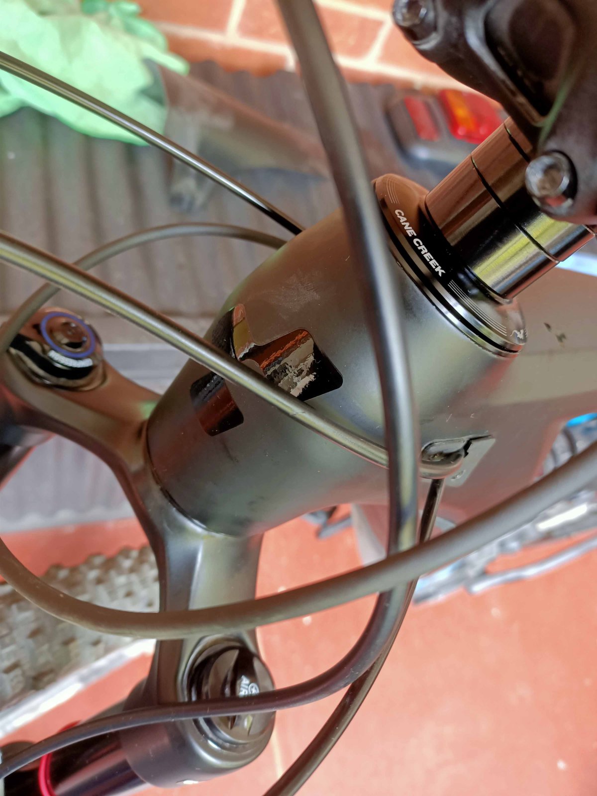

I've successfuly fitted the Cane Creek headset and it's a vast improvement on the stock FSA. FYI Daboss The old cups drifted out of the frame fairly easily and the new cups installed easily using my variation of Ozcycle's headset press. The new crown race installed relatively easily using MrPeaski's suggested home-made crown race setter. A bit more force was required than I imagined to get the crown race seated. The biggest challenge was removing the old crown race. This could be a problem for those with little or no mechanical experience or without the correct type of tool (a thin bearing remover). The crown race is steel but the fork crown is aluminium so it would be easy to damage the fork crown using a less sophisticated tool (for example the blade of a screwdriver) to remove it. Bottom line is without 50 years of mechanical background and the tools I've collected over the same time, it would have been a job for the lbs.

I've successfuly fitted the Cane Creek headset and it's a vast improvement on the stock FSA. FYI Daboss The old cups drifted out of the frame fairly easily and the new cups installed easily using my variation of Ozcycle's headset press. The new crown race installed relatively easily using MrPeaski's suggested home-made crown race setter. A bit more force was required than I imagined to get the crown race seated. The biggest challenge was removing the old crown race. This could be a problem for those with little or no mechanical experience or without the correct type of tool (a thin bearing remover). The crown race is steel but the fork crown is aluminium so it would be easy to damage the fork crown using a less sophisticated tool (for example the blade of a screwdriver) to remove it. Bottom line is without 50 years of mechanical background and the tools I've collected over the same time, it would have been a job for the lbs. View attachment 51205
looks heaps better too, Took mine apart today and the top bearing seems to spin a little more free then the bottom bearing. so yeah I'll def be changing mine out for the one you've fitted. cheers again mate.

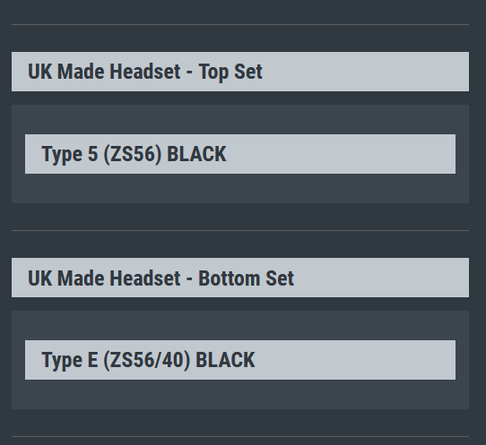

For anyone that was after replacement headsets - the Superstar Components ones are now back available for pre-order for early August! Type 5 + Type E
