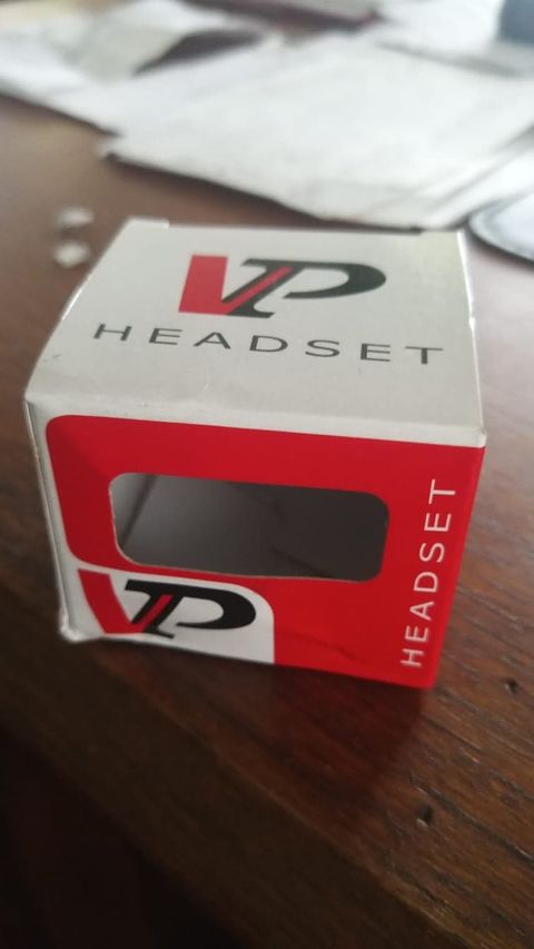

Hey Falco...i had the same issues on my 2020 hybrid reaction pro..the bars got stuck on the right side..too it into be fixed and all they did was greasse it up...( the original seal come UN greased for some strange reason) anyway soon after it got stiff again..and then i realised that the bearings in the head set are unsealed...so i brought a sealed bearing unit for the bike and it has been fine ever since....i think these issues are simply cost cutting devices.... hope this helps

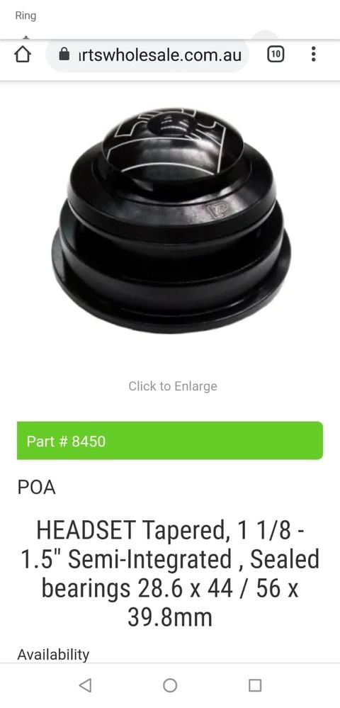

I would also like to know what and where please, the only direct replacement for zs56/30 zs56/40 I have found so far are these......
