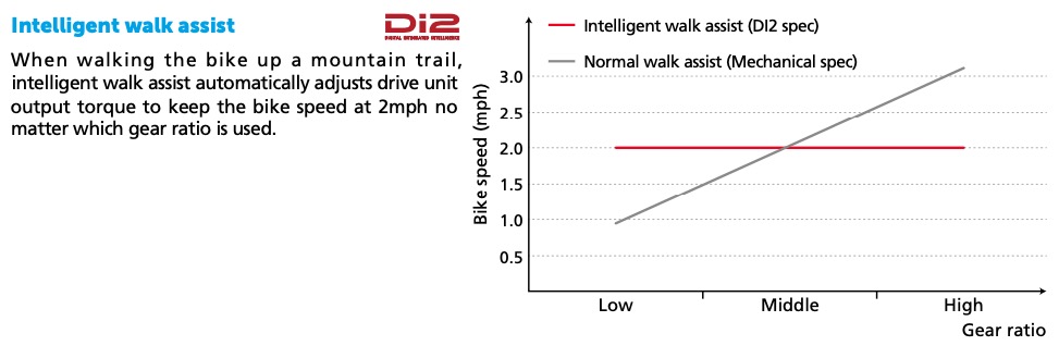

Regarding modifying the mount angle... somehow this Shimano graphic might be a clue as to what/how we could use the mount angle setting for (if it actually does do anything):
That graphic has nothing to do with motor mount angle.
It's simply showing what speed walk mode will power a bike along at in walk mode.
ie. Di2 works out the gearing so it powers the cranks to achieve a constant 2mph whatever gear the bike happens to be in
While a in a mid cassette gear say 34x18 Walk mode will also power a mechanically geared bike along at 2mph (So a higher gear will be faster, lower gear even slower)
What's interesting is that Shimano actually designed walk mode to power the bike along at 2mph. A pretty uselessly slow speed for anyone fit and healthy. and why I never use it at all.
I suppose they had to do this as if 2mph was achievable in a low gear muppet would almost definitely try to use the mode to power their bike without pedalling by using higher gears.

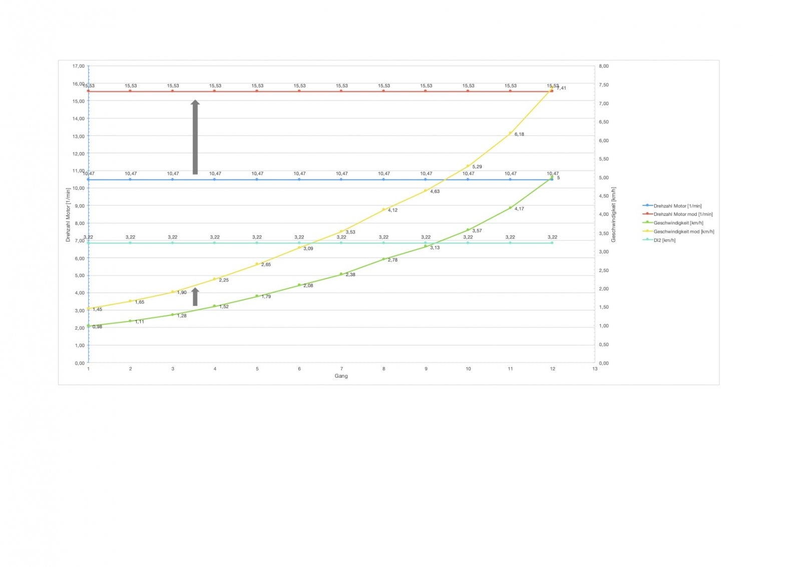

Hello together,
I found out that in the Stunlocker menu "Gearshift" the number of teeth of the sprocket can be increased up to 14 (without getting an error message). Chainring should be set to 34. This leads to an increase of the engine speed and thus to a speed increase (in my case this was about +50%, installed is 36 chainring and SLX 12-speed 10-51). But at 6 km/h the engine stops and switches off briefly, until the speed is below 6 km/h again.
The attached picture shows the two different speeds of the engine and the resulting speeds in manual shift mode compared to the DI2.
--> I can now drive e.g. in 6th instead of 9th gear (approx. DI2 speed) and have more torque available due to the higher gear ratio.
Try it out at your own risk. :)

Thanks for info. BTW, what is your bike, motor, cassette and front chainring? What was settings from stock?
Eyjim
Apr 29, 2020
It is a YT Decoy Race Pro 2019; Shimano STEPS E8000; 12-speed Shimano 10-51; chainring 36T. Settings in App from stock were 11 for smallest cog and 34 for chainring.
