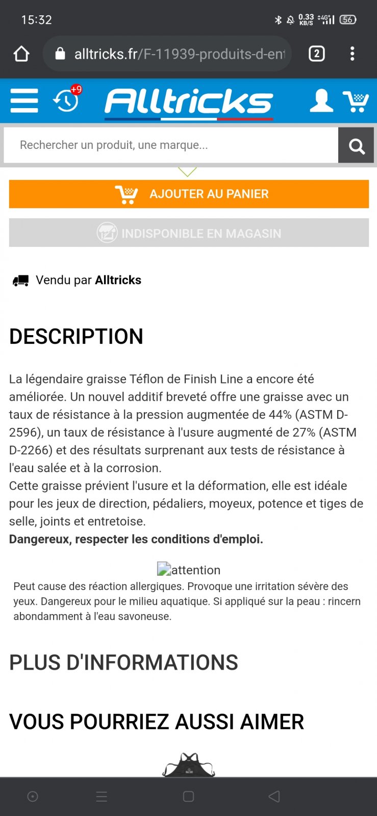

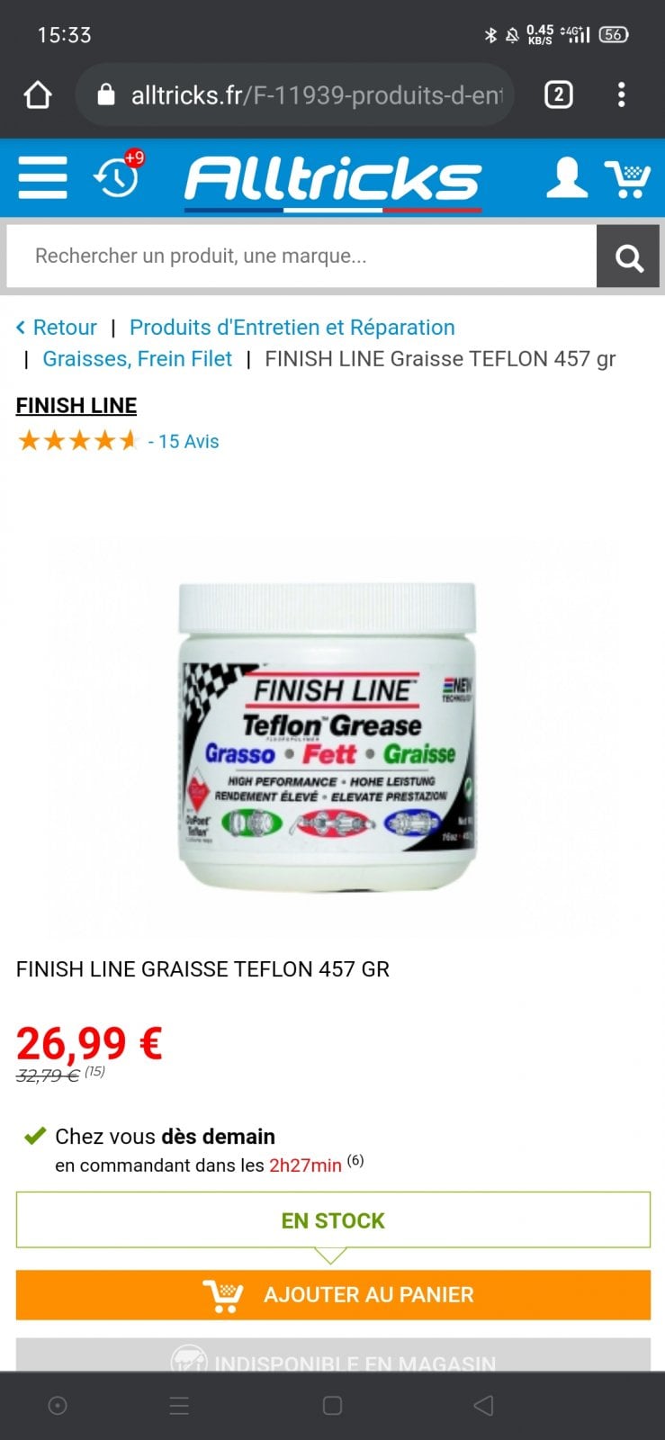

is the white molykote pg75 grease look like the finish line withe grease ? this one is really durable , very sticky , and smooth , it is teflon based with enhencement ; high pression resist and water ingress résistance
So many people make big mistakes with grease. I am sure that for some applications the grease you list is great! But try putting this stuff on a roller or sprag clutch bearing and the bearing will slip or worst still, slip and then grip, which can shatter the bearing. Too much grease or the wrong type of grease can be a nightmare as far as your high precision ebike motor is concerned.
This again is why we spend months and sometimes years sourcing the right and best parts to do the job properly.
