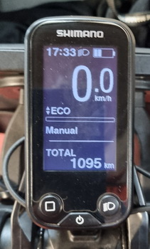

108 Kilometer yesterday between minus 5° and 0°.
1500 Kilometer since 15. XI 2021 and my servicing of my E8000.
17423 Kilometer until 15. Novembre 2021 with the axle clattering diagonally like a metronome
18923 Kilometer since 22. XII 2019 with this 3rd Engine, the E8000.
22823 Kilometer since purchasing the Husqvarna on May 30, 2019

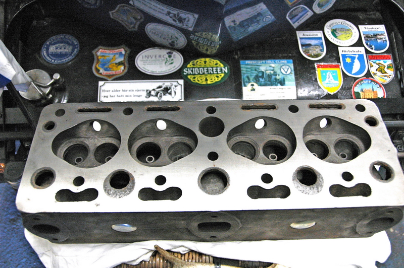

I use Blue Loctite for my pre-war cars since... over 40 years.
Before closing the motor unit, take care to remove this transparent film with a razor blade.
And when you rebuild the engine block tighten step by step and staggered the black screws,
as if you were doing it with a cylinder head of a car.
This is
1) to have a flat and clean seal plane without twisting the aluminium cover
and 2) to help the ball bearings to slide smooth into the housings,
without forcing, without putting them askew and ovalizing their housings.
And even when you have very meticulously closed the block,
you will notice by the noise emitted by the gears
during the first 10 to 20 revolutions of the pedals,
that everything is going back a little better in its nominal place.
And you can enjoy yourself again for a long time !

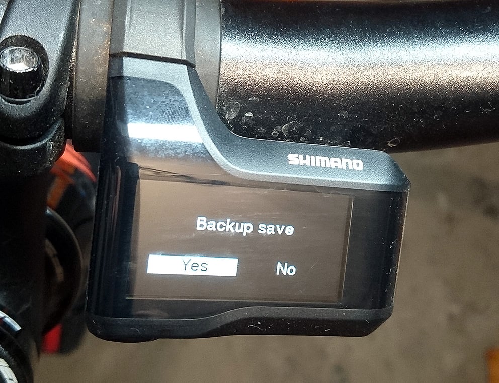

I mounted a new engine Steps E8000 on my eONE-SIXTY M#RIDA.
But after each switch on, write: Backup save ?
I always choose No.
I don't want it load my 10,500 km off the old engine to new one.
What should I do to turn this question off ?
Thanks.
I always choose No.
Thanks.
Choose Yes :)
The millage won't change as it's not a parameter you have access to. The backup refers to settings stored on the older drive unit that were saved (as a backup) to the cycle computer.

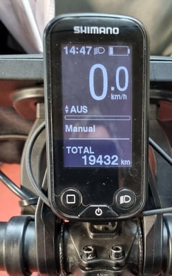

2009 kilometers since E8000 servicing on November 15, 2021
22 rides from km 17,423 to km 19,432 without any trouble or doubt.

I made now 2772 km since servicing on November 15, 2021.
All is well, no issue with the torque sensor , no W013 + E010, no issue with the two clutches.
Crank axle is ok like new.
After my lovely 2772 km with my super-serviced new-old E8000 in 2,5 months
I made now 1095 new kilometers in a month,
but with my 4th Shimano DU to be conform and covered by Wertgarantie, my insurance,
which reimbursed my new E8000 and has its Serial Number I had to declare.
My 3rd Engine, the new-old E8000, is now a good and reliable spare engine.
After each exchange, the display starts again by Zero.
But in these 1095 km with my 4th Engine, the second E8000,
I have had 3 times for a nano-second an assistance drop-out.
(Edit 27 VII 2022: I never have had again this curious issue / Now 3433 km with my 4th E8000.
I use battery grease for the contacts)
Uphill with 35x51, like ever on a quite macadam road and never with Boost,
because I only use for 99,99% Eco High with the standard 30% / 60 Nm .
Battery contacts have Pole Grease of course.
And by these 3 issues I had a full Akku or a little bit less between 5 or 4 .
The Shimano Display showed nothing,
but the Sigma Rox 12.0 showed a red popup with informations about a failure.
To see the gps-map again, I had to click down this popup, and that's all.
