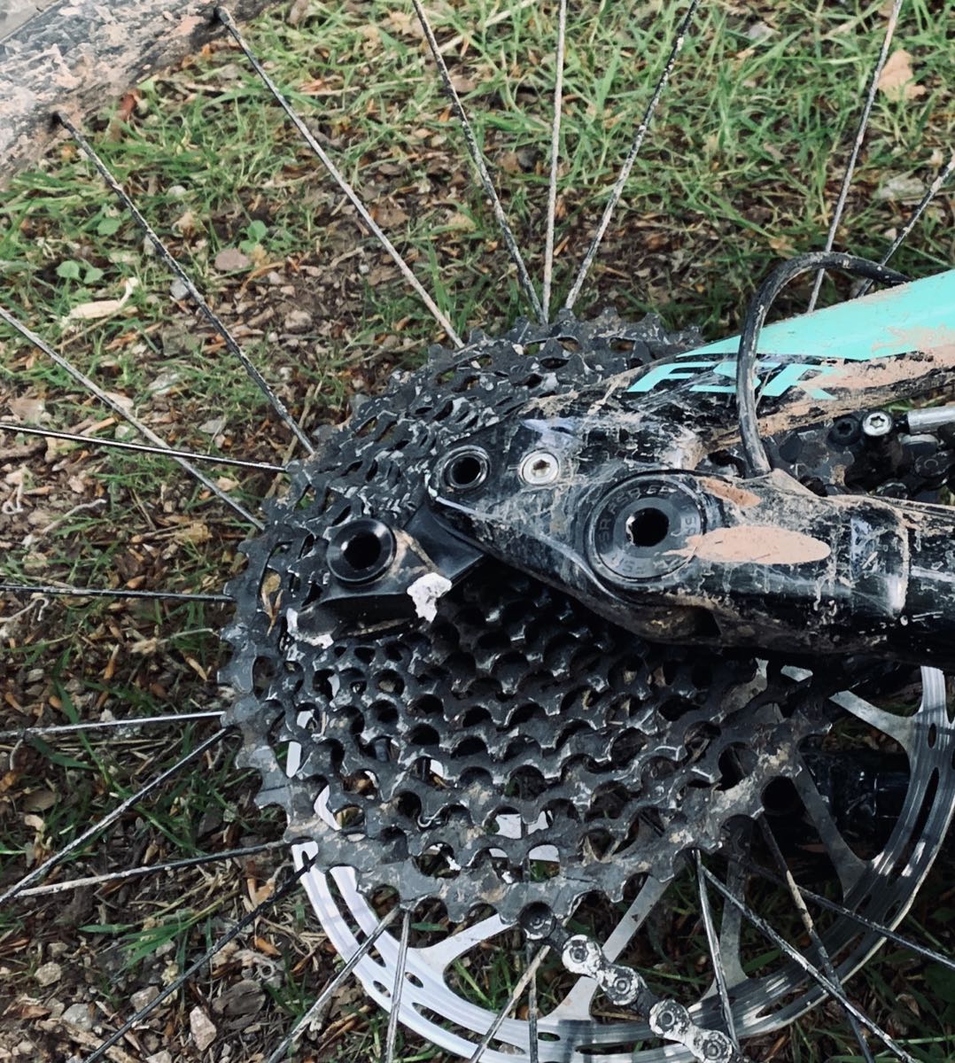

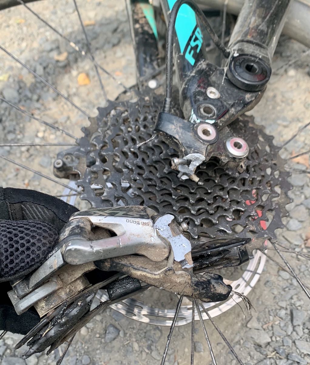

I've never bent a hangar despite obliterating several derailleurs
In the last 20 years I've bent hangers 40ish times and only destroyed 1 derailleur. Most of the time I just bent them back. I always take a hanger on trips as it's small and easy to bring. I've seen 20+ derailleurs destroyed by riding buddies.

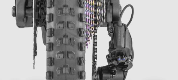

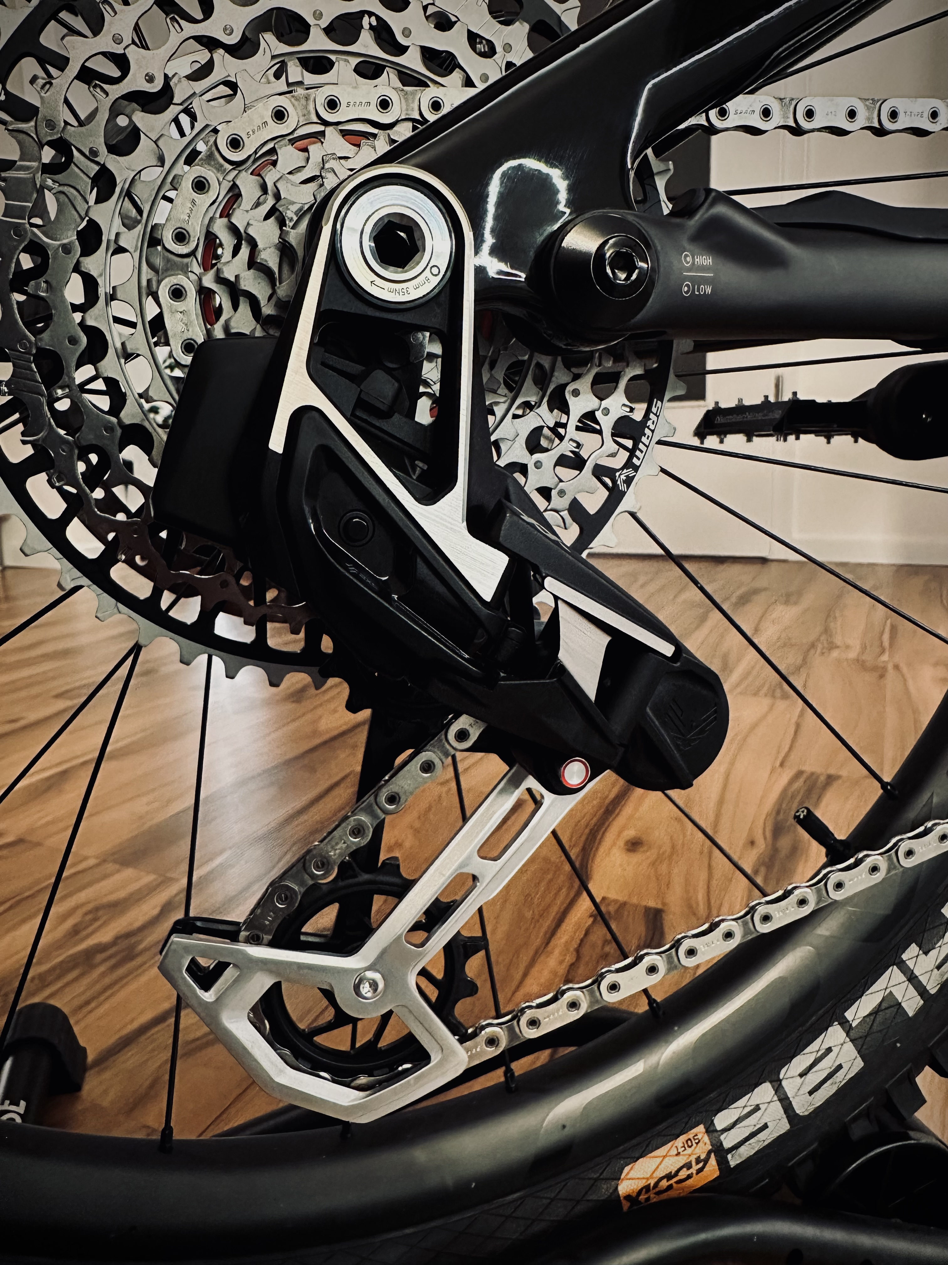

The Mech can move both inboard (via the overload clutch, absorbing some side impact forces) as well as rotate backwards, absorbing / moving out of the way from frontal impacts.
Rebuild kits are also available at reasonable prices.
Could it be broken in an unlucky crash? Yes, of course.
This is how I usually destroy mine, I’m not sure there would be much left to rebuild, but maybe if they can pivot up, I’ll only smash the cage off not the whole mech?

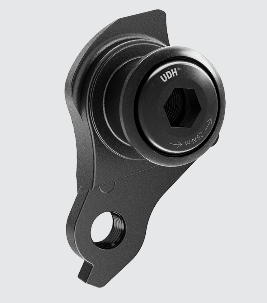

I like the look of this and the concept of letting the mech move backward on impact seems fine. If you hit a rock at 20mph something is going to break on any system but probably better to have a rebuildable mech than a flimsy hanger to replace AND a non-rebuildable mech AND a frame with a dropout that is half the thickness it could be in order to accommodate the replaceable hanger. The UDH compatible dropouts are MUCH thicker and stronger than any replaceable hanger dropout I have ever seen.
However, I don't want the hassle of charging a battery and replacing one in the controller AND the inability to fix anything myself, so I would rather stick with a cable actuated mech. Also my Levo SL does not use a UDH so it's not compatible anyway.
BUT, I do find myself wondering if I can run the new cassette and chain with my existing X0 cable actuated mech, If so that seems like the obvious way to go when I need to replace the cassette, better shifting and longer life are the main advantages I see with this.

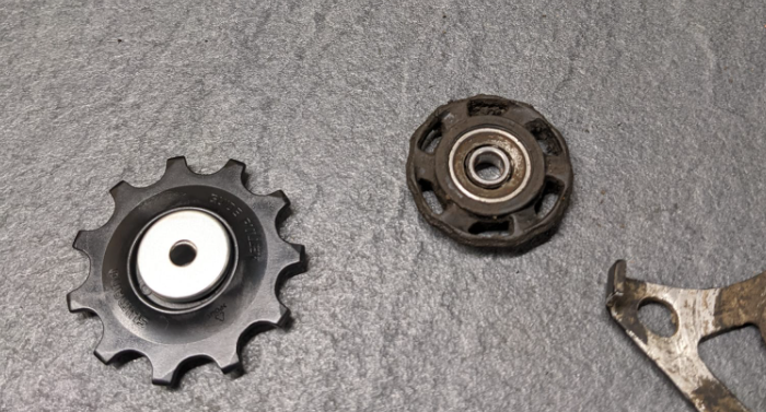

I've been working on a new Jockey wheel which is fully compatible with all systems and also has the "magic wheel" effect built in if you do happen to get an allen/hex key stuck in there as you ride along... At the moment the production time is quite high for each unit, but if there's interest I can probably speed things up.
you need to do an ally version.................mud and grass etc sticks like....well mud....to that black plastic crap!! Now it might sound counter intuitive but an ally version with much more spindly spokes actually enables mud and grass etc to be thrown off ..........it would not pass the allen key test though, but I can honestly say I have never had an allen key jam my jockey wheel. Maybe I have just been lucky!

The X0 version would defiantly not pass a technical Allen key section. The lower cog is one piece.

As I said, the UDH "dropout" is a lot stronger than most pre-UDH dropouts so we reduce the risk of damage to an even more expensive part to replace. So UDH dropout beats non-UDH dropout.
And then we are just comparing UDH hanger with the new standard, but the UDH is so strong that I doubt any existing derailleur would survive an impact significant enough to damage the UDH.

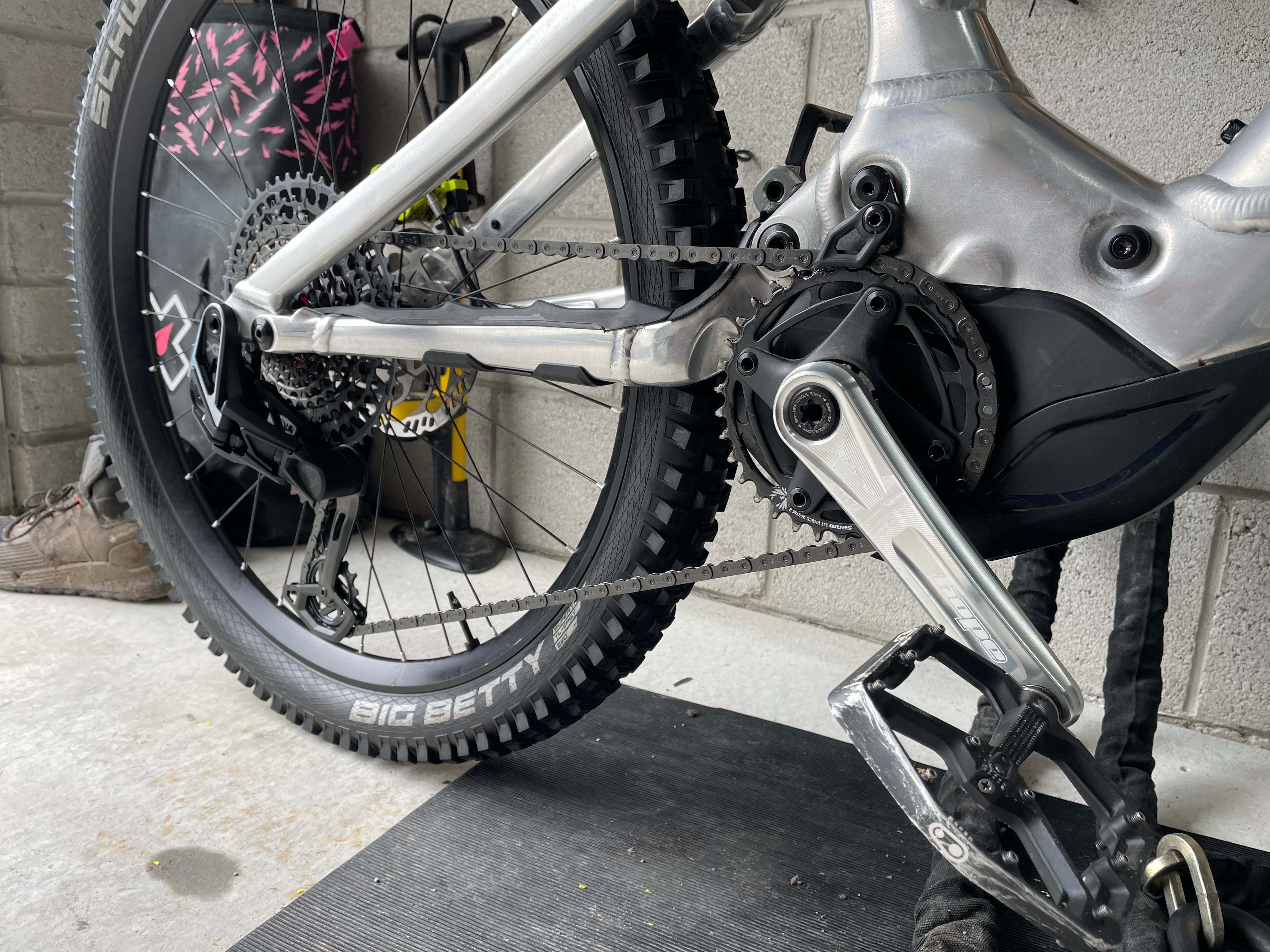

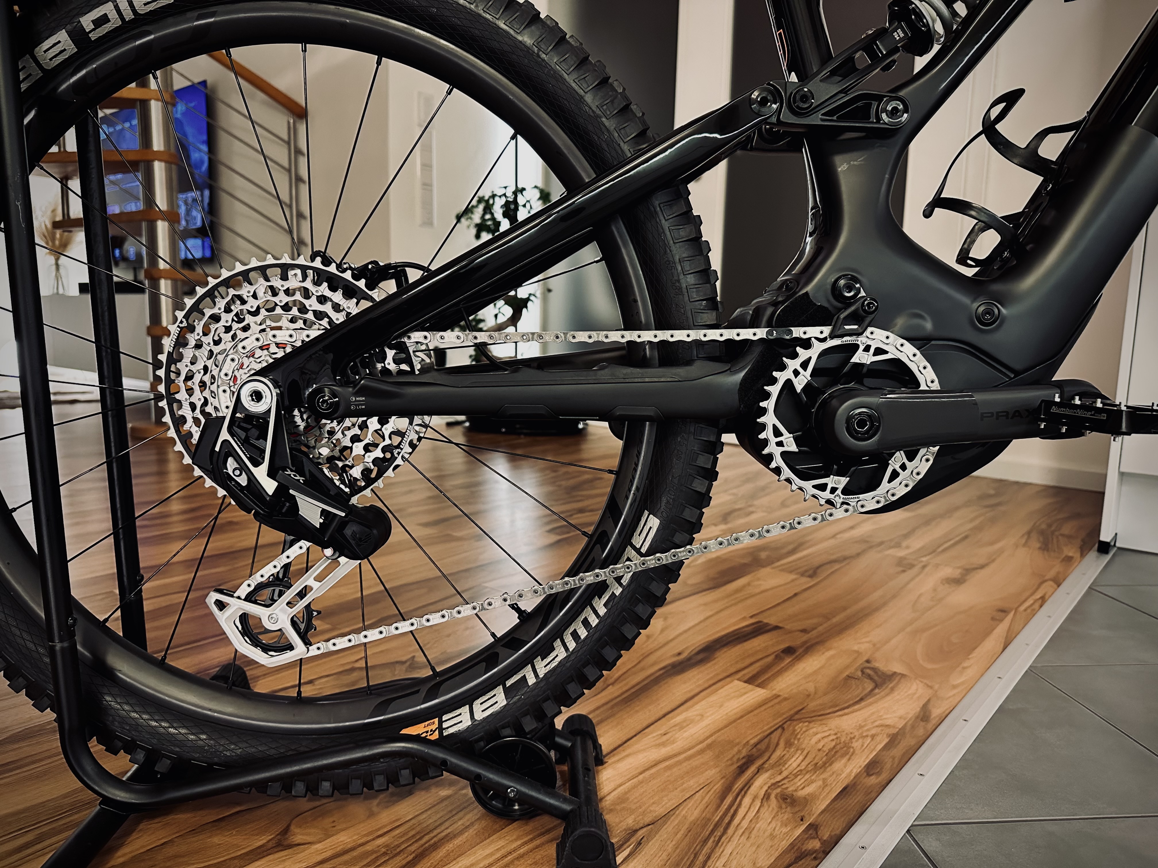

Fitted mine today. Super easy to install.

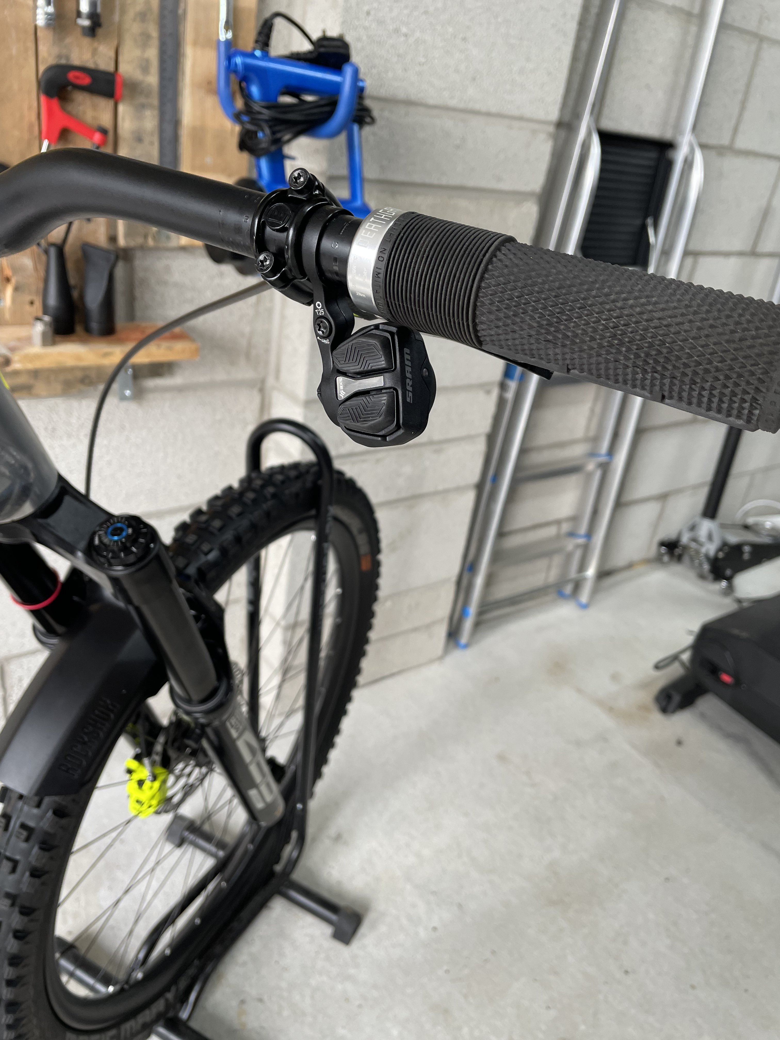

Paddle shift is ugly but functional. Probably better when Magura make a match maker for it.
Quick ride around the car park and it feels identical to the old AXS.
Hopefully will get out tomorrow for a proper test ride.

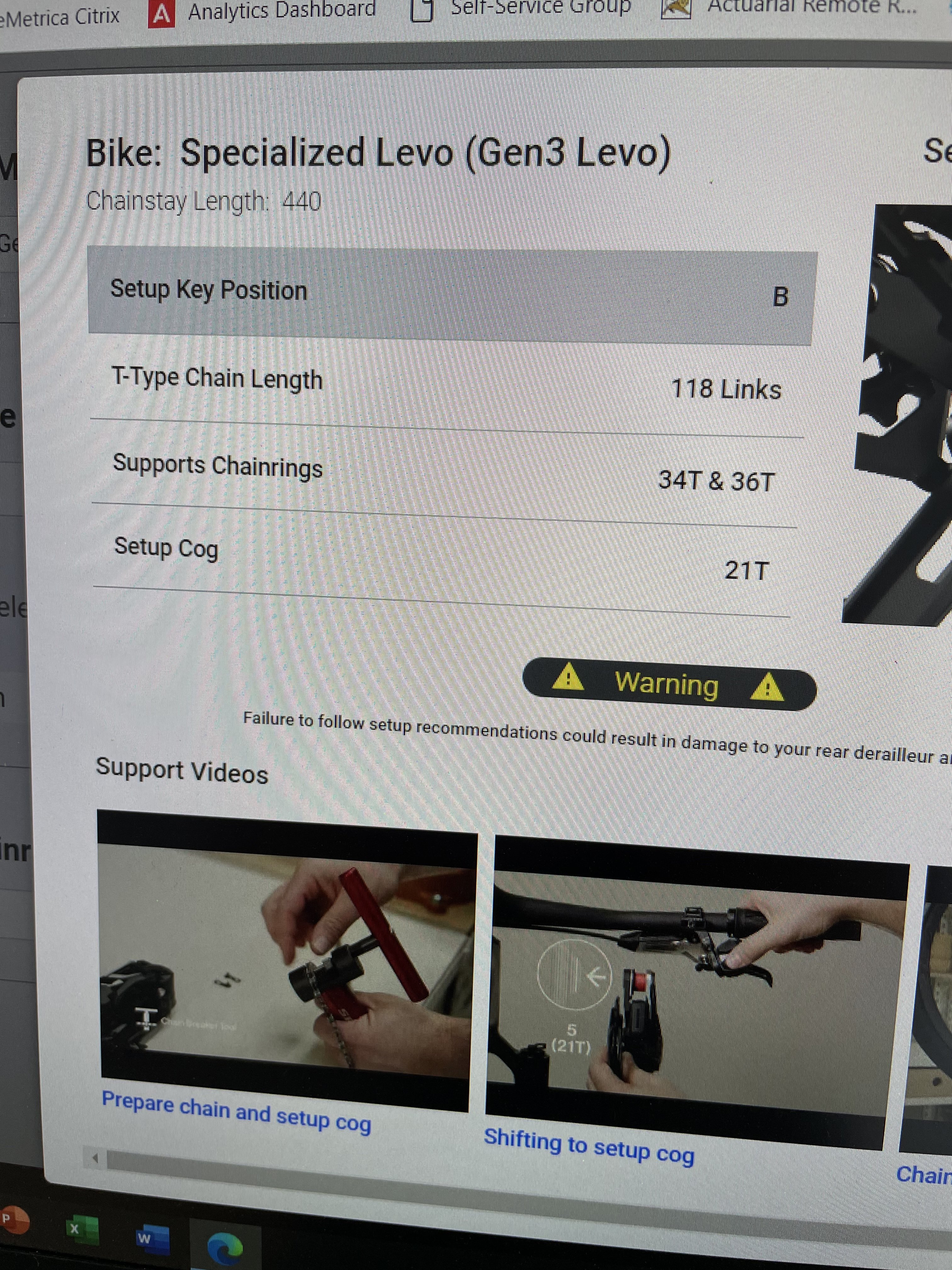

Install App for chain length takes all the faff out of the install.

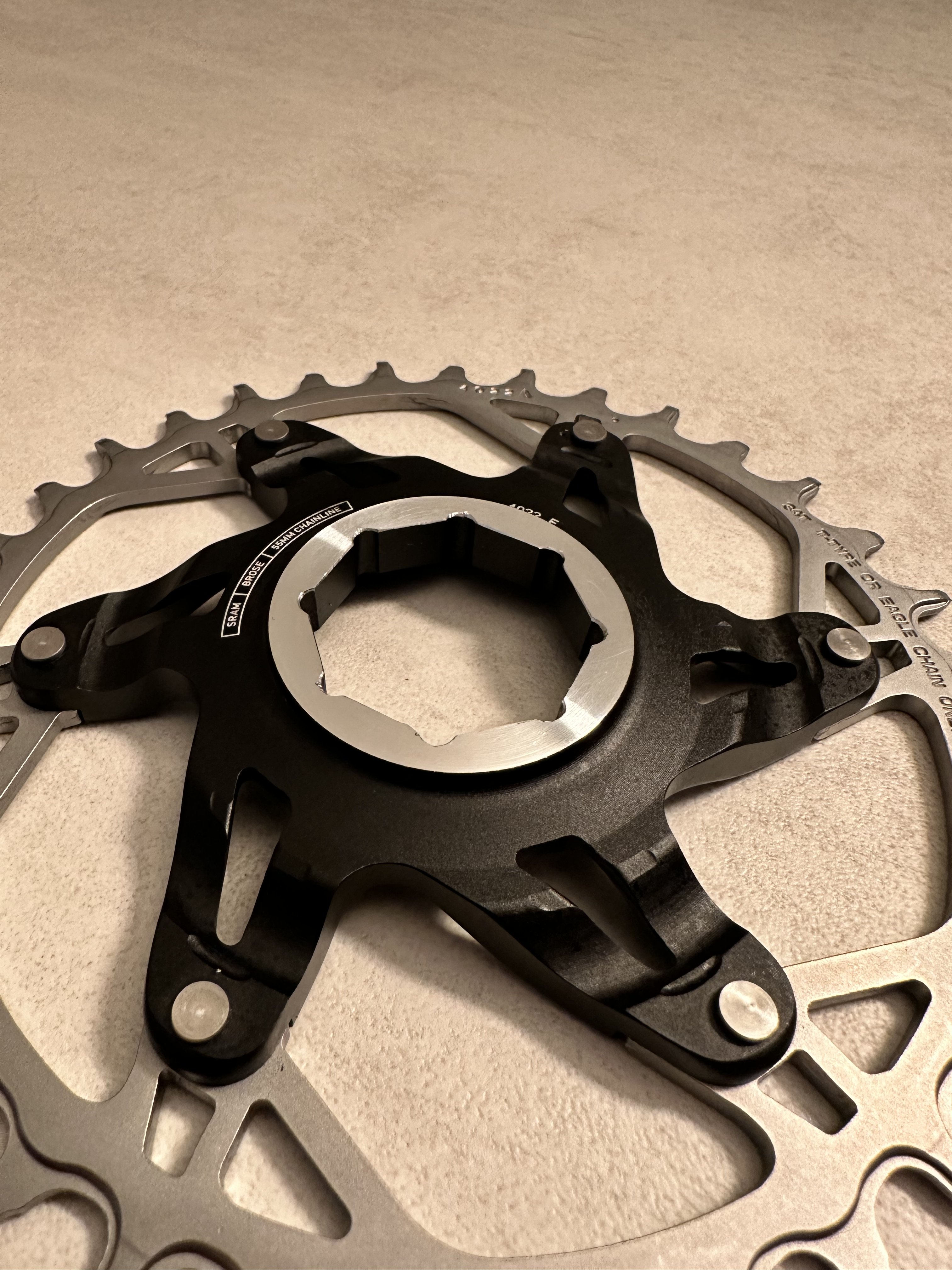

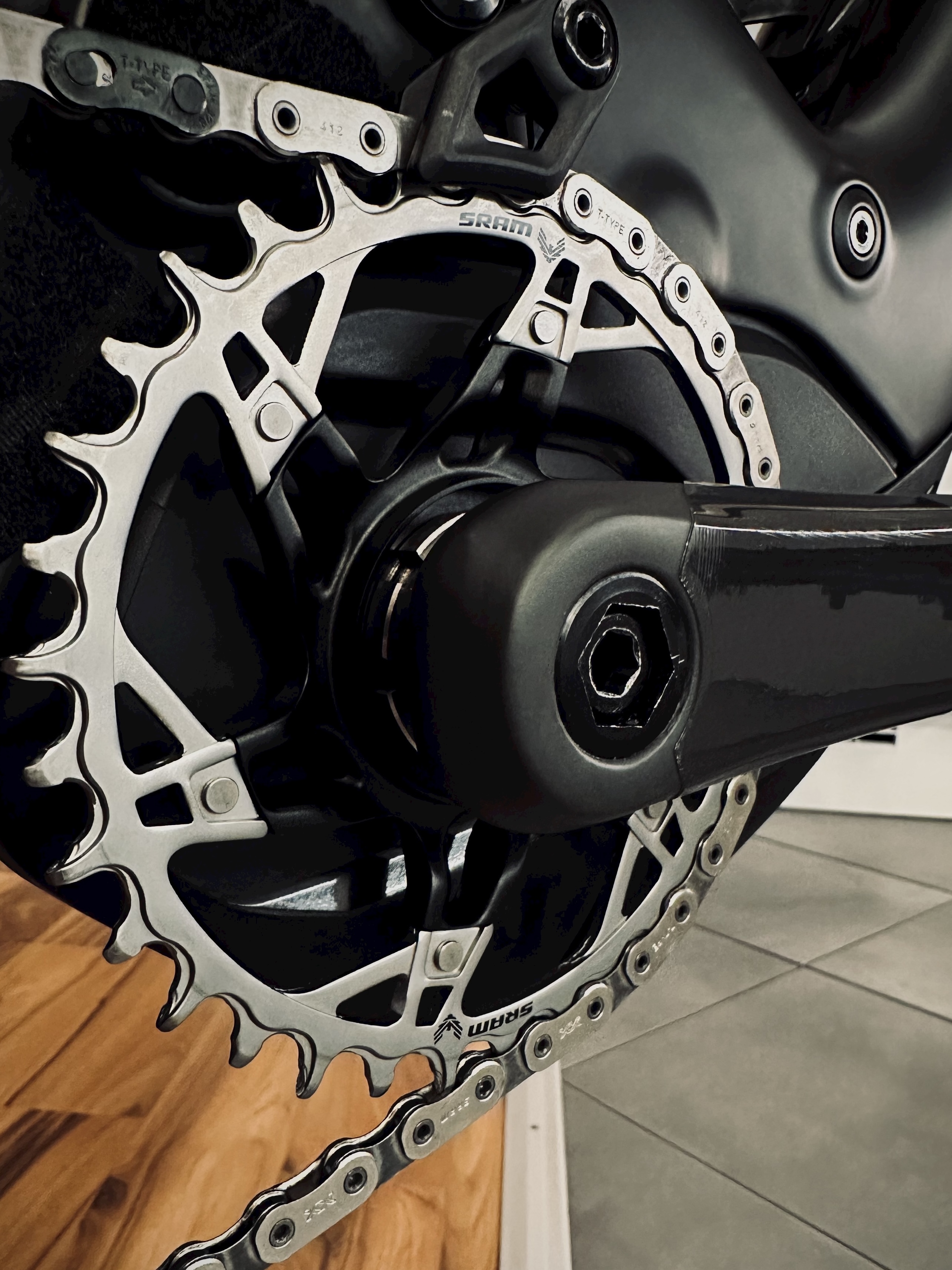

I didn’t change my 12sp 34t chain ring, was proving to be a pain to remove (how do you get it off? Take the whole ring off the crank and then remove the ring?). (Presume a special tool is needed for the lock ring?)
But the tooth pattern on the t type and eagle chain ring looks identical.

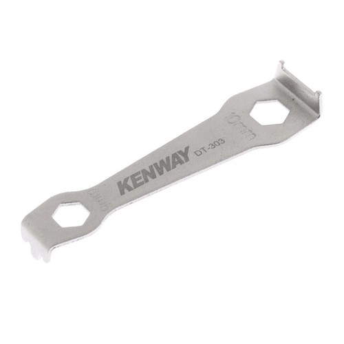

Its 4 bolt BCD I assume and a SRAM chainring....which is not threaded for the bolts so they are nuts and bolts. You need to use an allen key on the bolts with a slot type tool ( make your own) to hold the "nut" at the back of each bolt. Rotate the chainguard out of the way. Chainring will then come off the spider although you probably need to remove the pedal.
No need to remove the spider unless the T replacement is direct mount. If so you have to remove the crank then the undo the lockring....which on a Brose motor is normal thread so counter clockwise to undo. Tool required is Park Tool LRT-3 or similar.
This came up earlier in the thread for Levo's. I presumed the alternative was the 4 bolt 104, but Rob was using this one :

Getting behind the ring to hold on the bolt was the problem I am having. My 10mm spanner kept slipping off. There is no way to access it. (Maybe I should have removed the battery now I think about it?!?).
