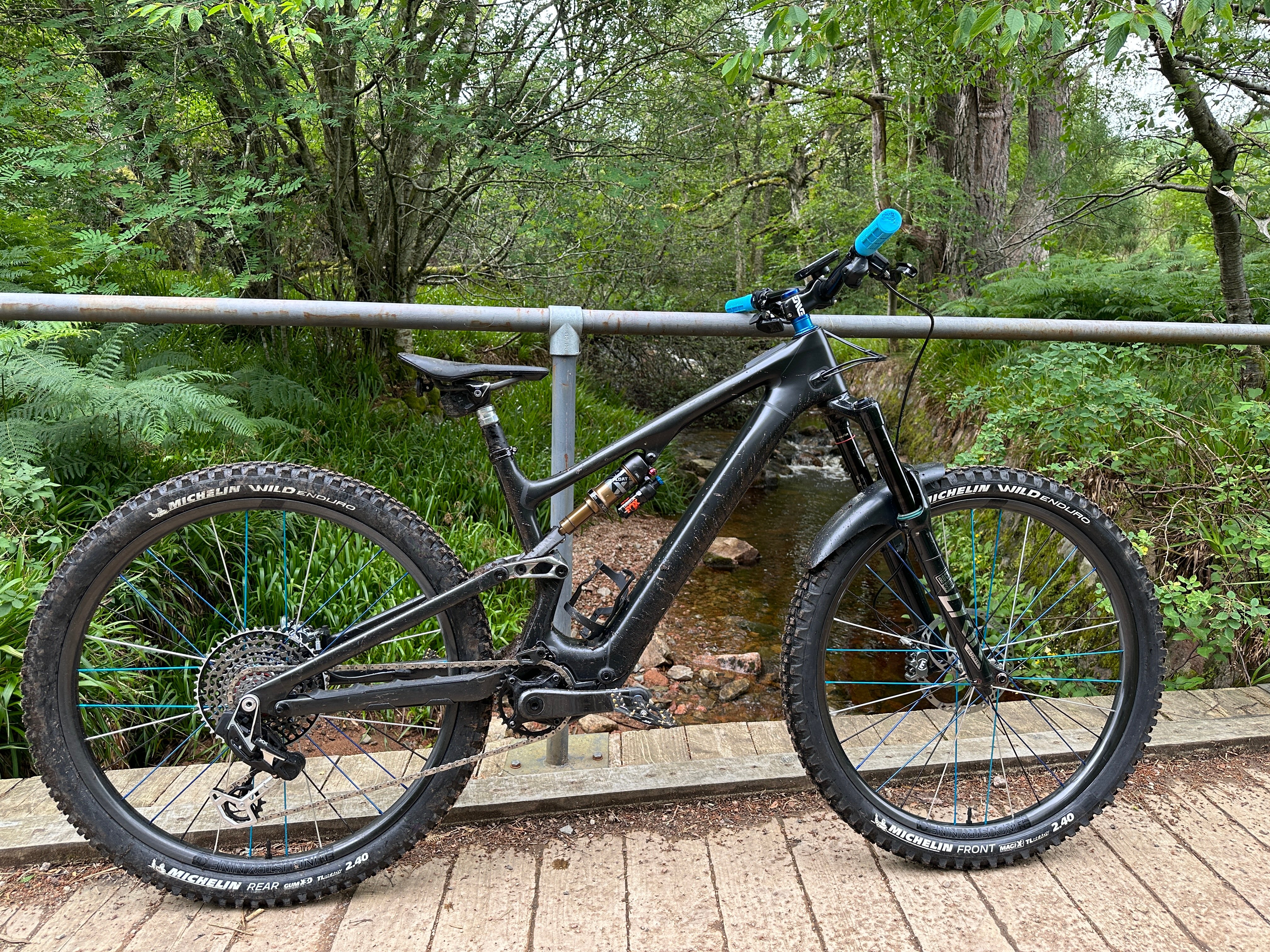

I’ve been running the XX one now for about 6 weeks and overall am really impressed.
I previously had AXS XX1 on the bike.
Now I’ve found the correct spot, I love the new ‘pod’ controller, the setup is sooo easy, and the shifting is flawless every time. I generally never shift under load anyway, so I don’t notice a difference there.
Was it worth the price to upgrade from my previous AXS? Probably not.
I did manage to get about £500 back selling it on eBay, but the upgrade was over £1300!

What bike is that on?
Levo SL 1.2
