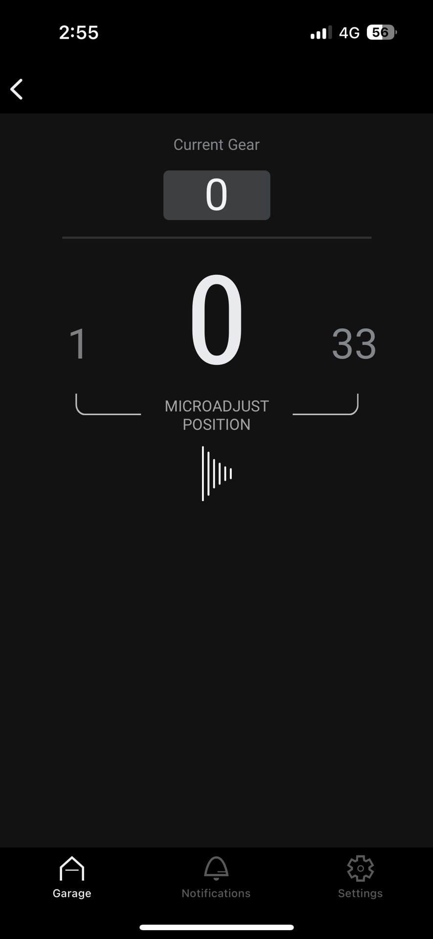

My system has started shifting badly again. I had another play with the MicroAdjust trying to fix it and the range of available adjustment in the app switched from 1–14 to 1–33! It let me set it to position 18 and try that (didn't help), before switching itself back to the original range of 1–14 and moving me back to position 14. The firmware and app haven't had any updates to cause this.
I didn't get a screenshot of it set to 18, but here's one of the range changing to 1–33. The buttons to adjust the setting had disappeared at this point.

Ok, thats truly weird… sorry I have nothing to offer on advice.
Check that chain length is correct (latest AXS app has updated calculator) and be sure your chainline (front/rear alignment) are correct since T-Type now run different chainline than prior standard.
If you are near the extremes of Microadjust settings, something is very wrong with your installation. Perhaps the cassette isn't fully seated on the freehub body.
I use my old Stumpjumper on a Wahoo Kickr / Zwift on occasion through the winter. I upgraded it to AXS, because I was fed up of having to make big adjustments to the derailleur when I put it on the Kickr. I feel like one of the spacers I put on the Kickr for fitting a 148mm axel is slightly too big. A discussion I've had with Wahoo, but they wouldn't acknowledge. I did think about shaving a few mm off it, but it seemed a dangerous game!
Anyway, to the point... my Stumpy with the rear wheel on is set at 16 (bang in the middle) and I have to offset the AXS app to setting 1 to make it work with my Kickr. I know there is an issue there, but it works.
My Levo SL on AXS was set at 15 (out of 32), and my transmission is at 7 (out of 14). Anything more than a few away from centre would indicate an issue to me.
How do you change the range from 1-14 to 1-33 ? I dont have that option and I have the same GX AXS T-Type derailleur

oh I see, I am on 14/14 microadjust step but I think I will leave it like that because is working fine, also 13/14 works good
once you get dial in you should not have to micro adjust unless the micro adjust gets moved. Another words if you had it at a certain number and rode it that way several rides and where using all the gears and it was working right then it's
not the issue. The key is getting it dialed
