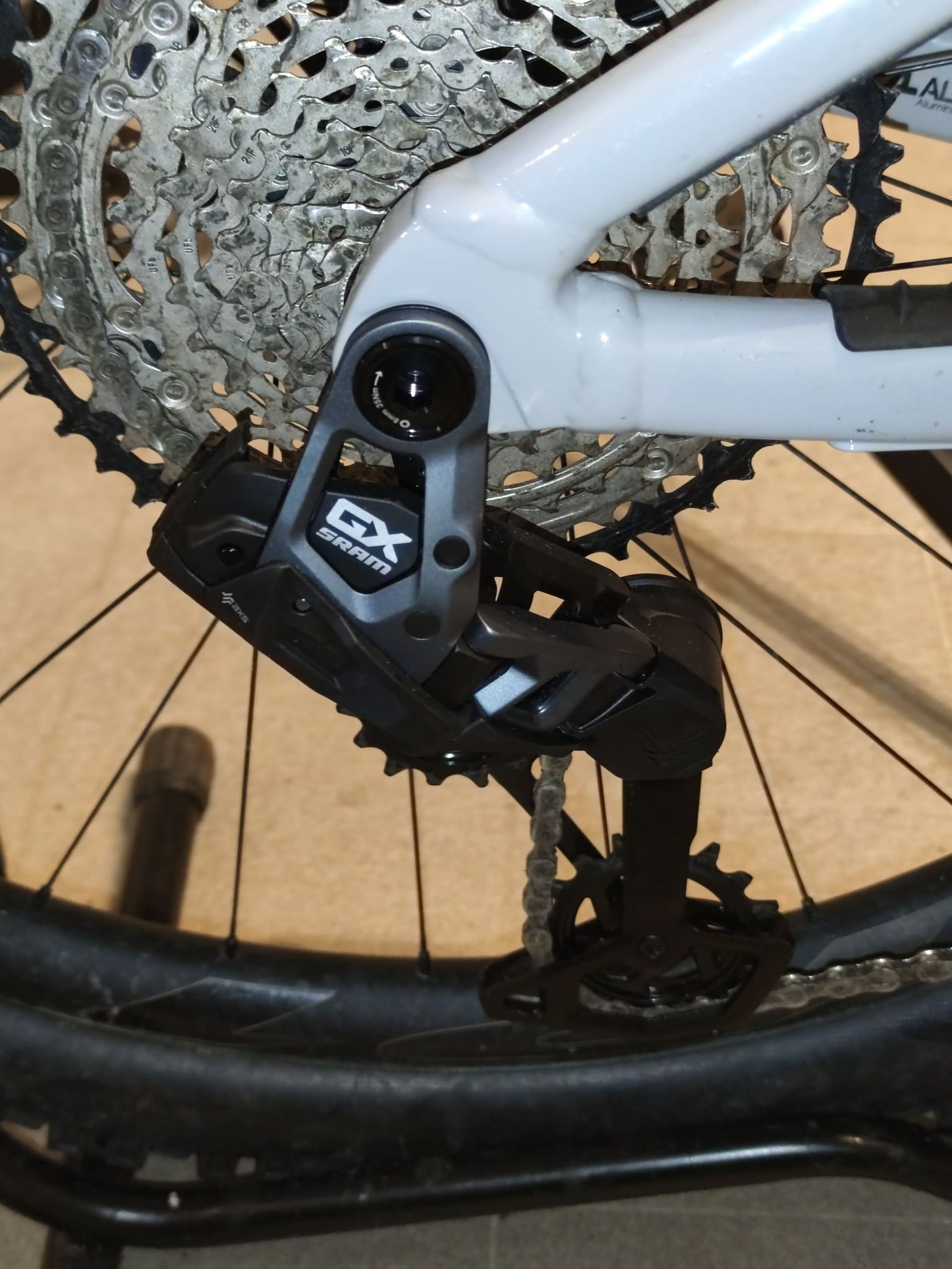

It works
Just need to put a 2.5mm spacer between casette and freehub body.

Agree, the t type mech works fine with a regular 12 speed cassette, chain ring and chain. You might have to space the cassette away from the wheel a little, I didn't need to as the micro adjust in the mech was enough to put the mech in the right place.
I'm using my t type mech with a garbaruk 12 speed cassette (on a shimano microspline hub) , and sram gx Eagle chain,it all works fine. Maybe the shifting isn't quite a smooth a a full t type setup, but it's pretty good still.

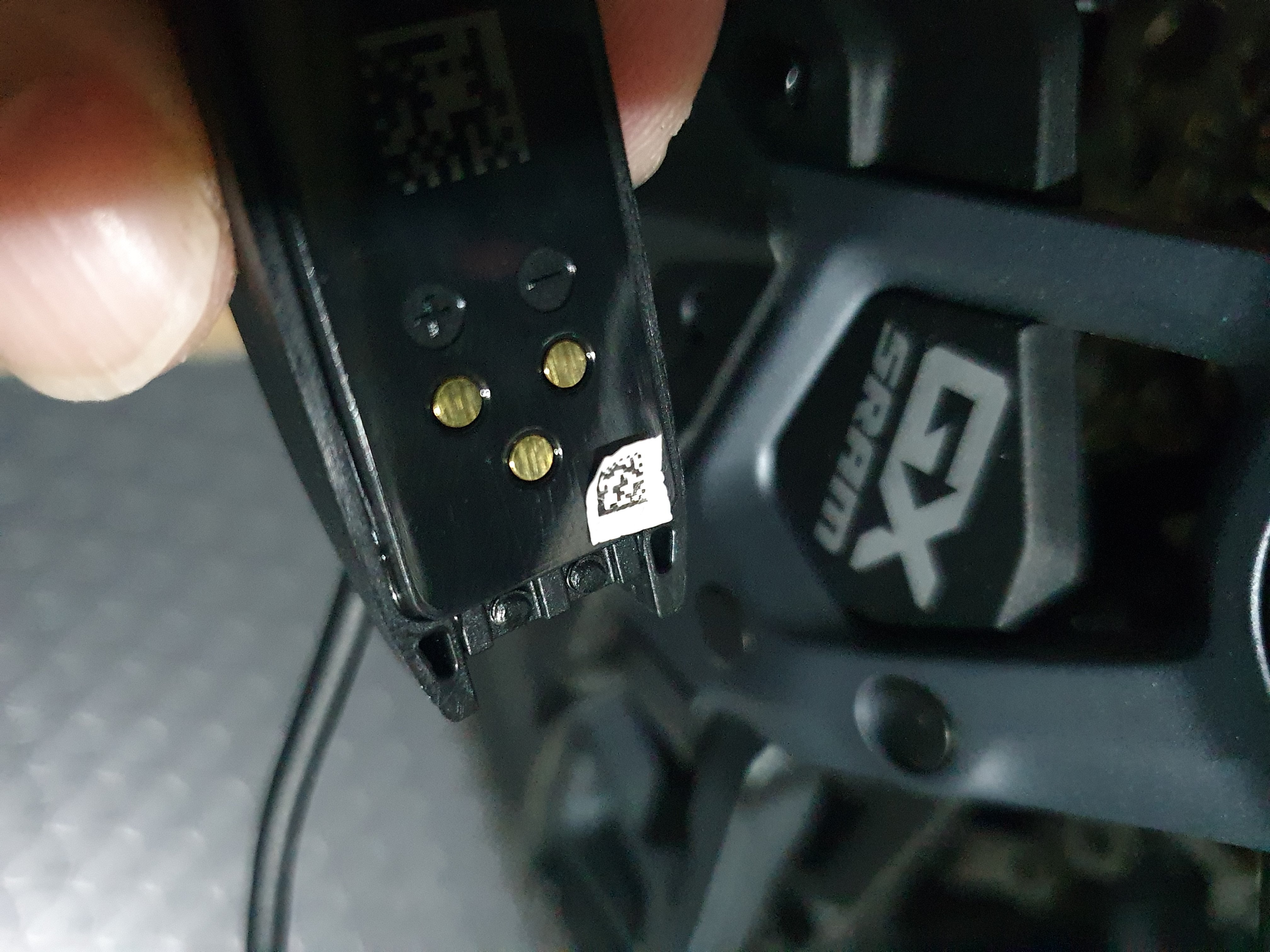

Ran into a rider with Sram gx transmission today that was walking out of the woods. He was complaining that somehow he kept having battery issues. I was stumped so when I got home I did a little research and found this video that explains his issues….. didn’t know where to post it so here it is.
That issue happens on the old (none t type) gx axs derailluer too, and that has a vertical battery, so it's nothing to do with the battery orientation, but it is definitely true that the pogo pins go bad and cause a poor connection.

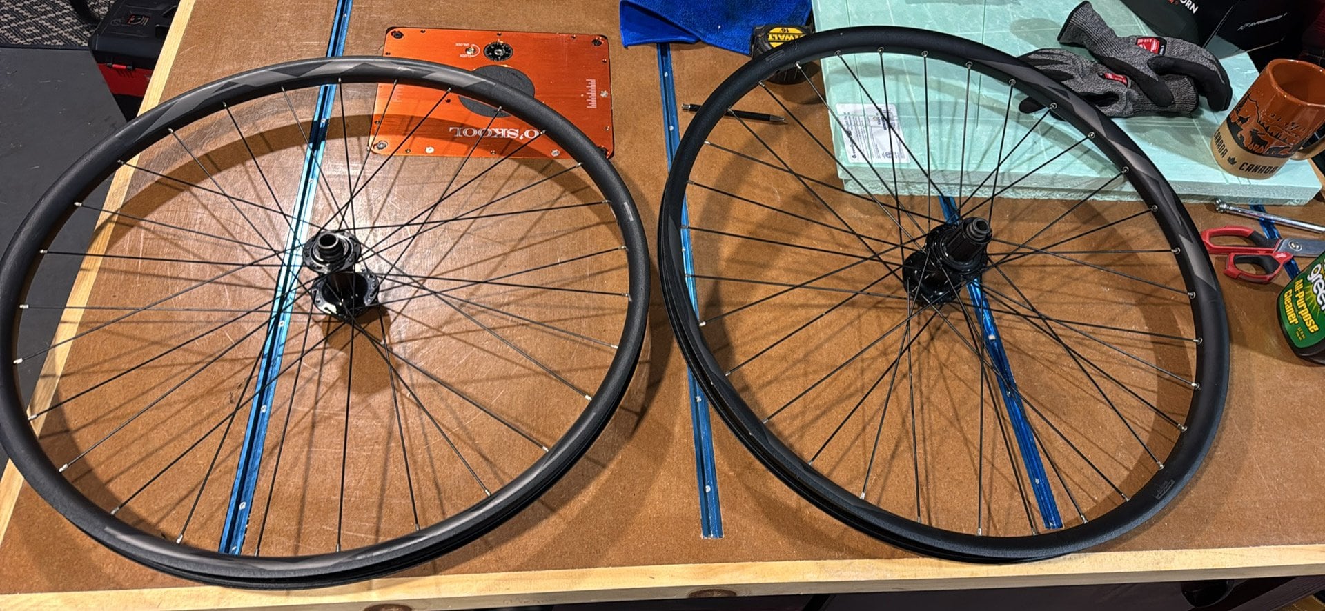

Has anyone tried this, or something similar?
  • I have two bikes, one with GX T-type, the other with GX mechanical 12-spd.
  • I would like to be able to swap wheels between the two bikes (one is 27.5", the other 29")
  • Thinking I try the 2.5mm spacer behind the cassette on the mech GX wheel. It sounds like that will work with the Transmission, so the question is, will I be able to tune in the shifting on the mechanical GX bike, with the cassette moved outboard 2.5mm?
  • Both bikes have the same rotors and brakes- I used to swap wheels before upgrading one bike to T-type.
Maybe I found a solution my ebike has a sticker right where the seal is i removed it.
In case anyone else was wondering- the T-Type cassette bottoms out against the UDH when installing the wheel with the GX mechnical drivetrain. I think I have read elsewhere that you can modify the UDH to make it work, but so far it looks like a no-go.

For anyone that’s interested, I finally got round to testing the GX T-Type mech with a Shimano 10/51 cassette and a Shimano 12 speed chain and T-Type Bosch 36 toothed chainring on a 2021 Trek Rail.
By following the exact same setup as the full T-Type system on the AXS app I can confirm that it does work, the only change I had to make was adjust the microshift down to down, after that all gears changed well, the only gripe I have is that the Shimano chain is quite noisy on the SRAM chainring so I "wouldn’t" recommend running it with the SRAM chainring and Shimano chain (edited to keep everyone happy)
Late update here- using a belt sander, I removed about 2mm off the inside face of the UDH, to provide clearance for the chain, and reset the limit screws & cable tension. With these mods, the mechanical GX derailuer/shifter & chain shift great on a GX T-type cassette.
Next I put the original wheel with the mech GX cassette back on. I installed a 2.5mm spacer behind the cassette, to get the same chainline as the transmission. Basically full mech GX with a modified chainline. This worked well too, though oddly not as well as the mixed set-up. My take-away is that most of the shifting benefits come from the t-type cassete, so I'll probably run them on both wheels.

I've done some experimenting, mainly because I wanted to be able to swap my 27.5" wheel w/transmission cassette between my two bikes (one with transmission, the other with mechanical GX). The one combination I didn't really try was transmission chain on the mechanical cassette, so not sure I can be of any help to you. What I can say is that the 12psd mechanical shifter/derailleur work GREAT with the transmission cassette. Far better than with the mechanical cassette. This was testing with the non-transmission chain. I think most all of the improved shifting & ability to shift under load, comes from the t-type cassette.
To get the T-type cassette to work with a derailleur hanger, you have to take 2.5mm off the inside face of the UDH. This is not the surface the axle sits against, so nothing is compromised. It took 2 minutes with a belt sander.
I'm going to run this set up on my other bike (GX mechanical shifter/derailleur, transmission cassette & chain). Then wheel swaps will be no problem.
