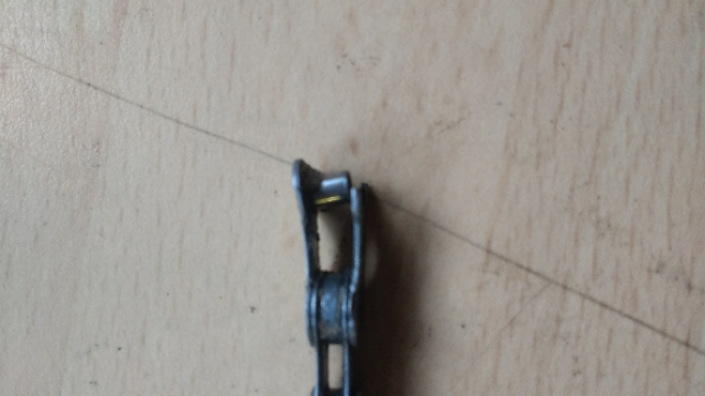

i just fitted the new xt m0802 brakes, they are xt levers and saint calipers first ride with them this morning they are very very powerful but i need to relearn my braking technique after three months of trying to stop with the horrid sram brakes
keep the recipt when you buy that chain mine broke on the first ride, if that is what KMC think an ebike chain is they should maybe think again

and it is triple durable my ass
It was this chain you had issues with and not the EL one?
