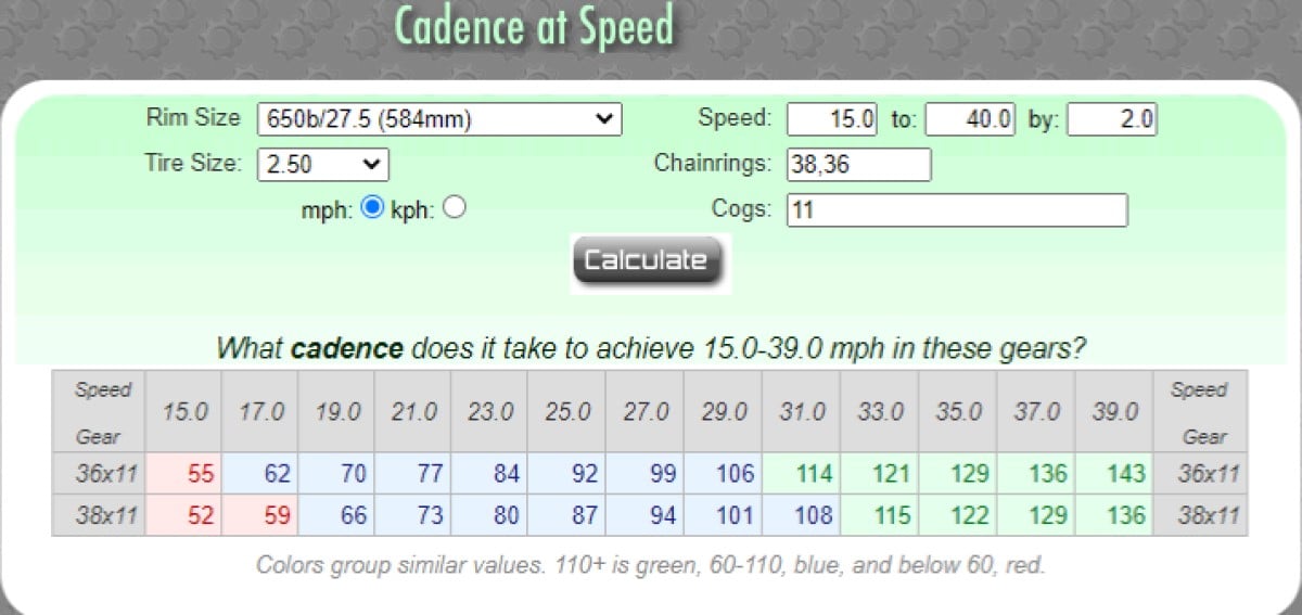

Don't worry. Anyone wearing out a decent quality cassette in 200 miles isn't maintaining/cleaning their drivetrain regularly enough or shifting gears smoothly (probably both).
I ran a 38t ring on a derestricted E Hardtail with slick tyres to commute on for a while. It's not a great difference from a 36T but It did mean I used the 11 and 13t sprockets a little less and could pedal to at a slightly higher speed.
This shows you the difference in cadence required to attain the same speed (above restriction limit) between using a 36 or 38t chainring
As you can see a 38T wouldn't be of any real benefit unless your bike is derestricted
