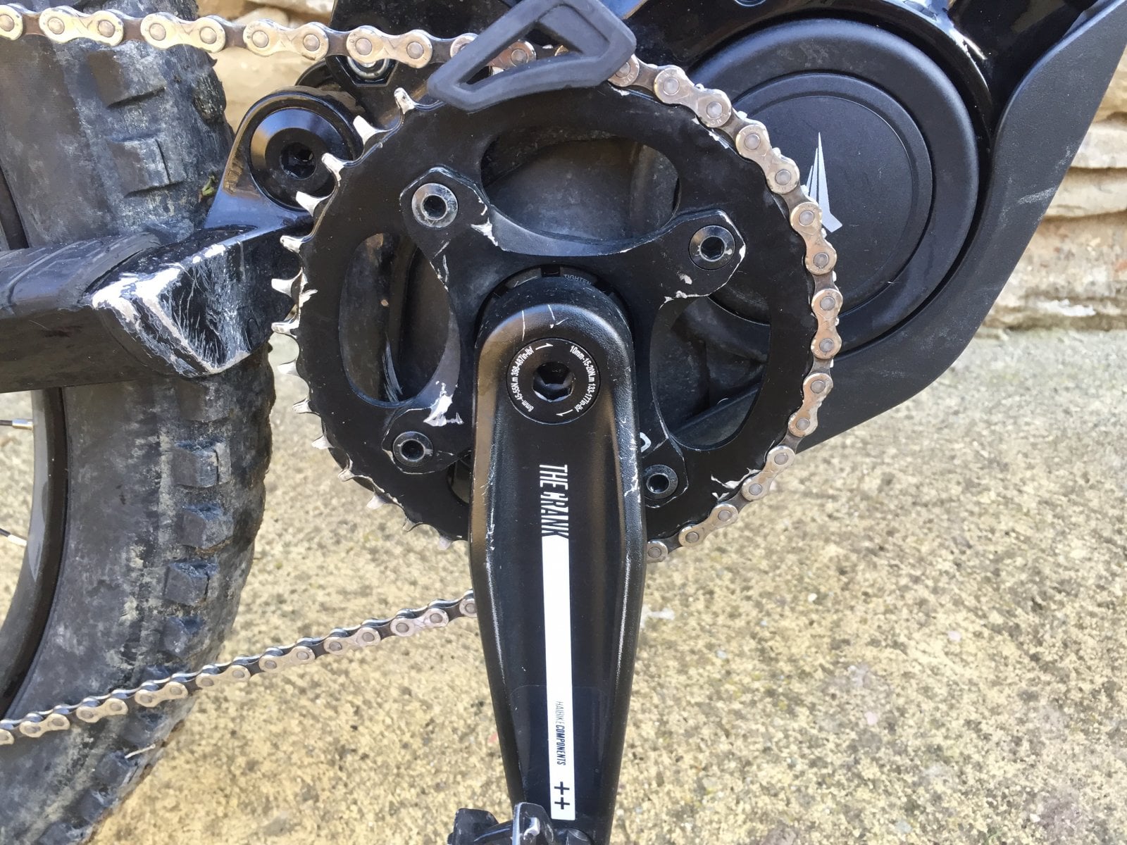

It's a Haibike allmtn 2.5 and the groupset is Deore M5100 11x1. The crank is labelled Haibike. There is no spec because Haibike refuse to tell me and there is nothing on the website for this model. The motor is a Yamaha PM-X2.
At first, I assumed the chainring would also be Deore, but when I looked on the Shimano website there was no M5100 38T.
I have asked Haibike, because none of the Italian dealers I have asked has responded, but if past experience is anything to go by they won't be very helpful.

"Deore groupset" on any Emtb doesn't include cranks unless it's a Shimano motor. and then it would be STEPS or XT STEPS cranks arms. not Deore.
The chainring isn't fittted to the cranks. it's fitted to the motor and the chainring is 4bolt 104 bcd (Deore is 96 asymetric).
Asymetric rings aren't used on Ebike motors as the spider turns independently of the crank arms so all the *claimed* benefits of asymetric design are lost.
your Yamaha if it has a 4 bolt spider with chainring bolts more than likely uses a 104bcd patern too too.
but measure it.

Try this one...it has BCD of 104....so measure yours to ensure a fit. The BCD is from the centre of one bolt to the centre of the other bolt diagonally opposite ..in mm.
FSA E-Bike chainring for Haibike with Yamaha from MJ 2016 | Bikester.co.uk
