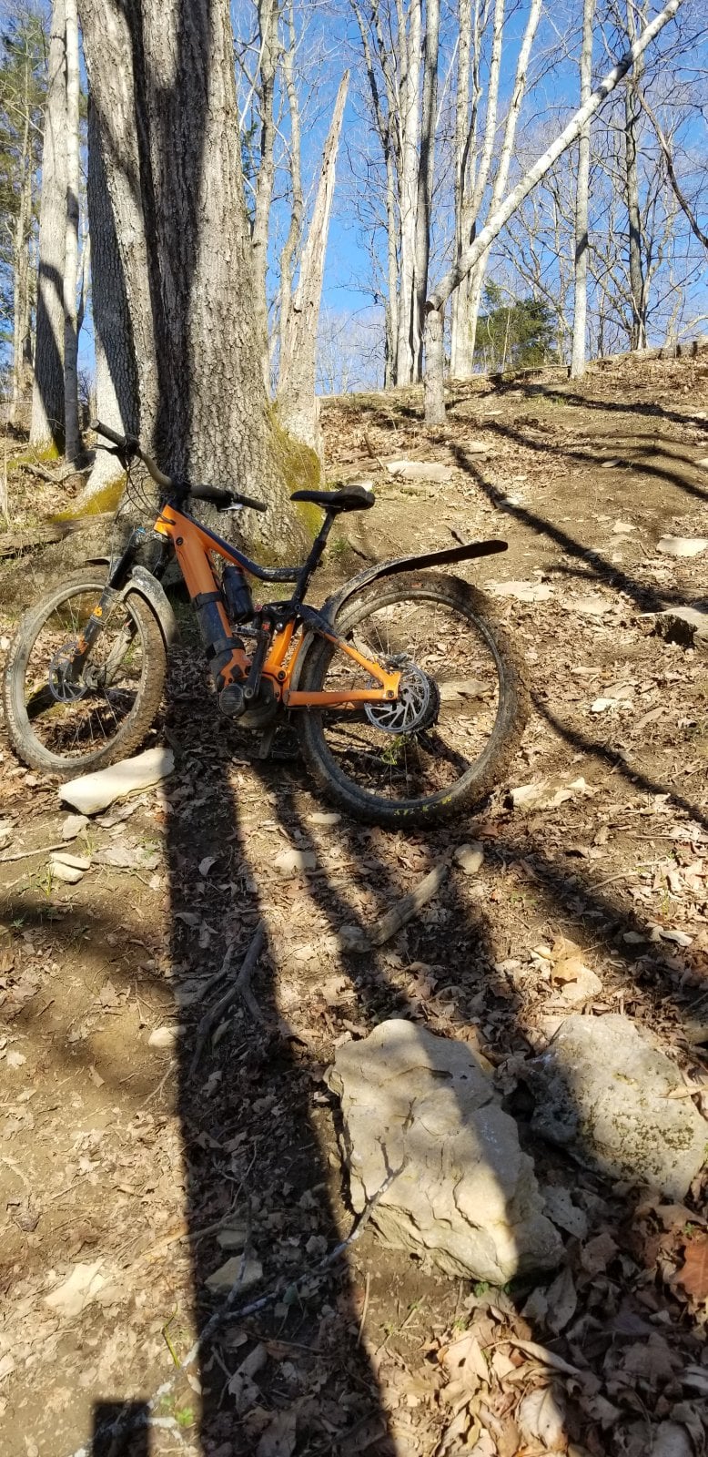

The worst climb in the daily ride. Almost never clean it. It's about 300 feet up, these are the last 50 feet, which are of course the worst. The cassette today is a deore 10 speed 11-42 with the 11 tooth cog removed, and a spacer used to shift the drive line away from the muddy rear tire. Prevention is the best medicine and I find this keeps the chain clean for giving up a gear I dont use in the mud. I use the limit screw as stated above somewhere, to keep the shifter from indexing off the 9th gear.
