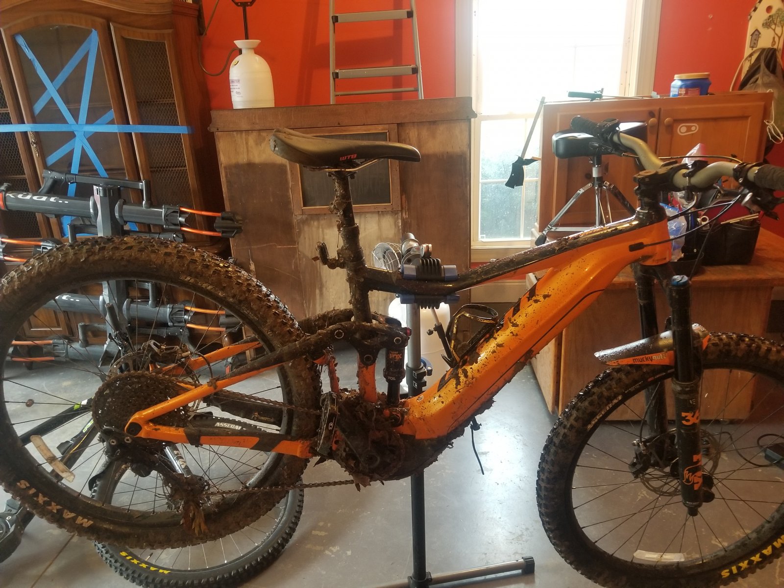

It's now a 10 speed, and I doubt I'll ever go back. So far, so simple. I know time will tell, but this is the first time I have felt good about this bike in at least a month.
^ Fantastic!
I hope this is the end of your drivetrain shifting woes. (y)
Now, it might pay to make one last check... do you have the correct chain length?
On my Trance with a 36T chainring and an 11-42T 10 speed cassette - my appointed chain length is 120 links. After shifting to my largest cog (42T), the derailleur cage is drawn and facing forward BUT has a bit more give to allow for suspension movement.
I'm just concerned that with your larger 11-46T 10 speed cassette, a chain length of 118 links (you previously mentioned) might not be long enough.
It looks OK judging by your latest pic above, but the only way to be really sure is to (after cleaning it first :eek:):
• shift to your 46T cog
• take the top pivot bolts off your rear shock to allow your rear suspension to depress fully.
• your derailleur cage should be as full forward as possible but with still a slight kink, meaning your chain still has a small amount of 'give.'
• if your chain is fully stretched, and prevents your rear suspension from depressing fully - then your chain is too short.
If your chain is too short, there is a chance you could snap that chain if you happen to be on the largest cog (46T in your case), should your rear suspension bottom out. Whether the chain snaps or not, the above condition may bend or stress other things that could spell alignment grief.

I did let all the air out of the shock, and collapsed the suspension in 1st gear, to check chain length.
It's all looks good with a little left in the derailleur to spare.
I'm running a 34t chain ring...
I might check it again based on your chain length requirement. I've been wrong before.

I checked it again (chain length) and 118 links is ok. Counted them twice to be sure I can still count... I can.
I let all the air out of the shock and completely collapsed the suspension in first gear.
I can reach down and still pull up the derailleur creating easily about an inch of slack, while sitting on the bike, in first gear, with suspension completely collapsed.

I did add the extra 1" of chain when splitting the new shimano 10 sp chain and at 120 links it's better I think. The shifting seems easier at the trigger and smoother with less of a clunk on up shifts.Thanks for the heads up grandpa.
My next experiment, hehe, will be an 8 speed attempt for under $100 USD.
Sram shifter 8 speed $18
Zee FR derailleur $45
Sunrace CSM680 11-40T $22
Haven't picked out my chain yet, but 8 speed chains are cheap, so even if I have to buy 2 for the required length, it will be less than most 10 or 11 speed chains.
I know this is controversial, and I've read reports of the zee making the stretch to 40T easy, and some who said it couldn't. I will know first hand soon enough.
The sram 8 and 9 speed shifters are said to have the correct ratio to make any shimano 10 speed clutched derailleur compatible with 8 or 9 speed cassettes.
I'll be back.
