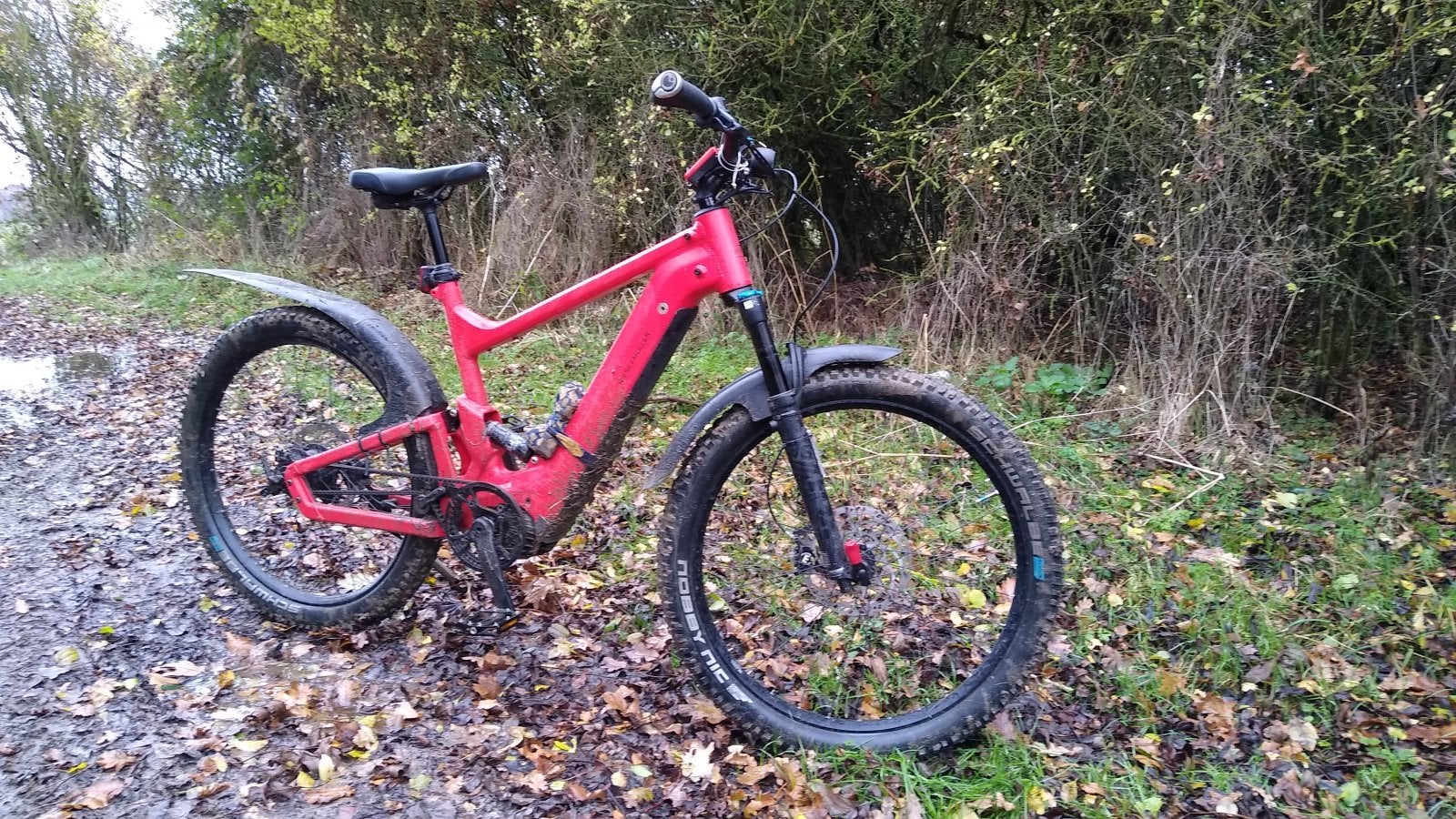

100% in favour of Gearboxes.....and belts ..... Swapped my Focus Jam 2 with chain and derailleur for a Ries & Muller Delight Mountain
With Electric change Rollhof gearbox and belt drive ....
cleaning after a winter ride is simple ...no oiling , no chain wear etc Beautiful gear changes ....The downsides are Extra weight in the wrong place , if you lose battery power you cant change gear.. and replacement belt costs £80+ But should last for multi thousands of miles
The Rollhof is not the best for MTBs but all that is available in a production MTB.
The integrated motor/gearbox systems are taking an age to come to market but they should solve these small problems The REVONTE would be my choice.
With Electric change Rollhof gearbox and belt drive .... View attachment 87721
