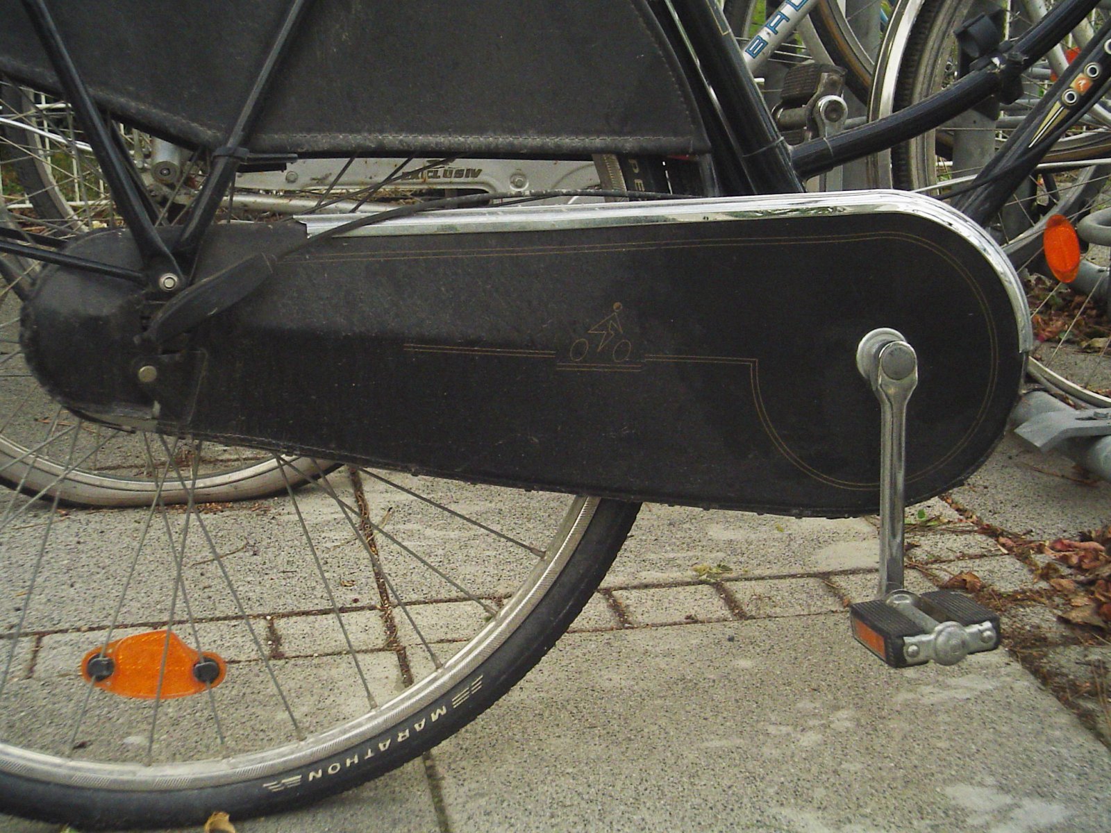

I guess for many, the humble chain and derailleur with it's open cogs and chains wizzing around don't really fit with our more modern day view of all that stuff being hidden away - for reliability, durability, clean lines ..
Who wants to see all the inner workings ! :) However, the chain and derailleur is light and extremely efficient - unlike gearboxes.
Generally, the chainring is designed to turn at the same rate as the cranks. There are exceptions, like the Bosch Gen 2, where the tiny ring is geared to turn at a different rate. This could possibly have been done differently and used with a custom cassette to remove the leser toothed gears - but then as the tiny ring is a high wear item due to - having only a few teeth - all it would have done is move the point of failure.

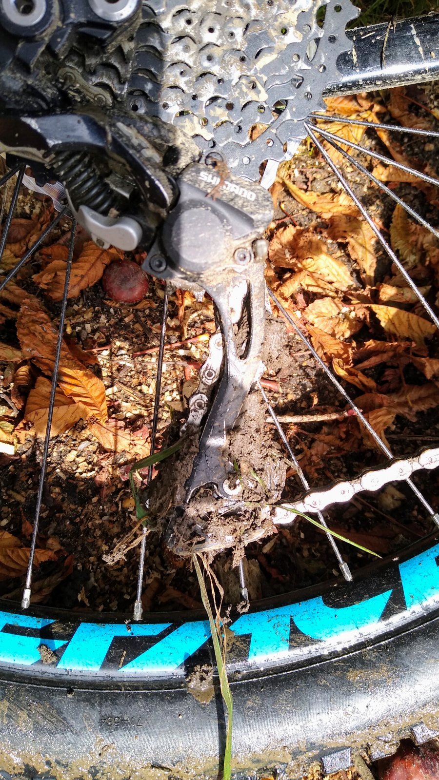

Not sure if this crash was caused by the derailleur, chain, or chainguide, but this type of crash would be much less likely to happen on a gearbox bike.
The single speed chains on a gearbox are more reliable than geared chains designed to flex and shift, there is no exposed derailleur to blow up, and you would also likely have more clearance on the front sprocket to minimize damage to it. Very unfortunate crash and doesn't look like the rider did anything wrong to cause it. But maybe his mechanic missed something. Regardless, another reason I'm all for gearboxes.

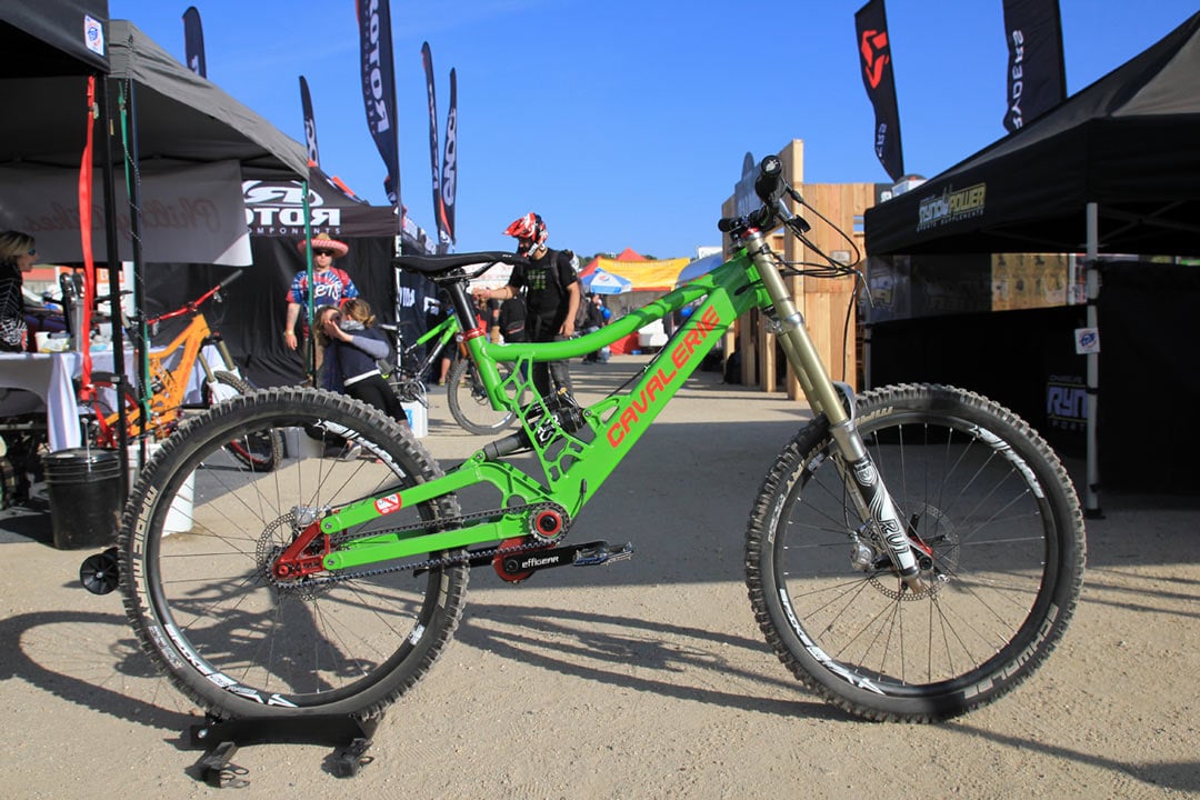

Checkout Allen Millyard legend motorbike builder BUT youve gotta see the downhill pedal bike he built ,single sided swing arm ( rear triangle ) enclosed chain gearbox that can be switched to 1st by one button if you fall off .
