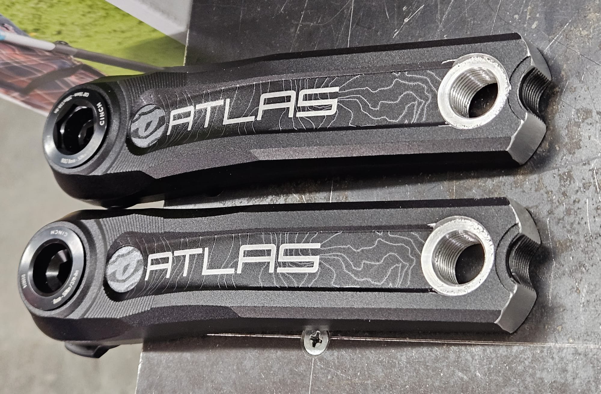

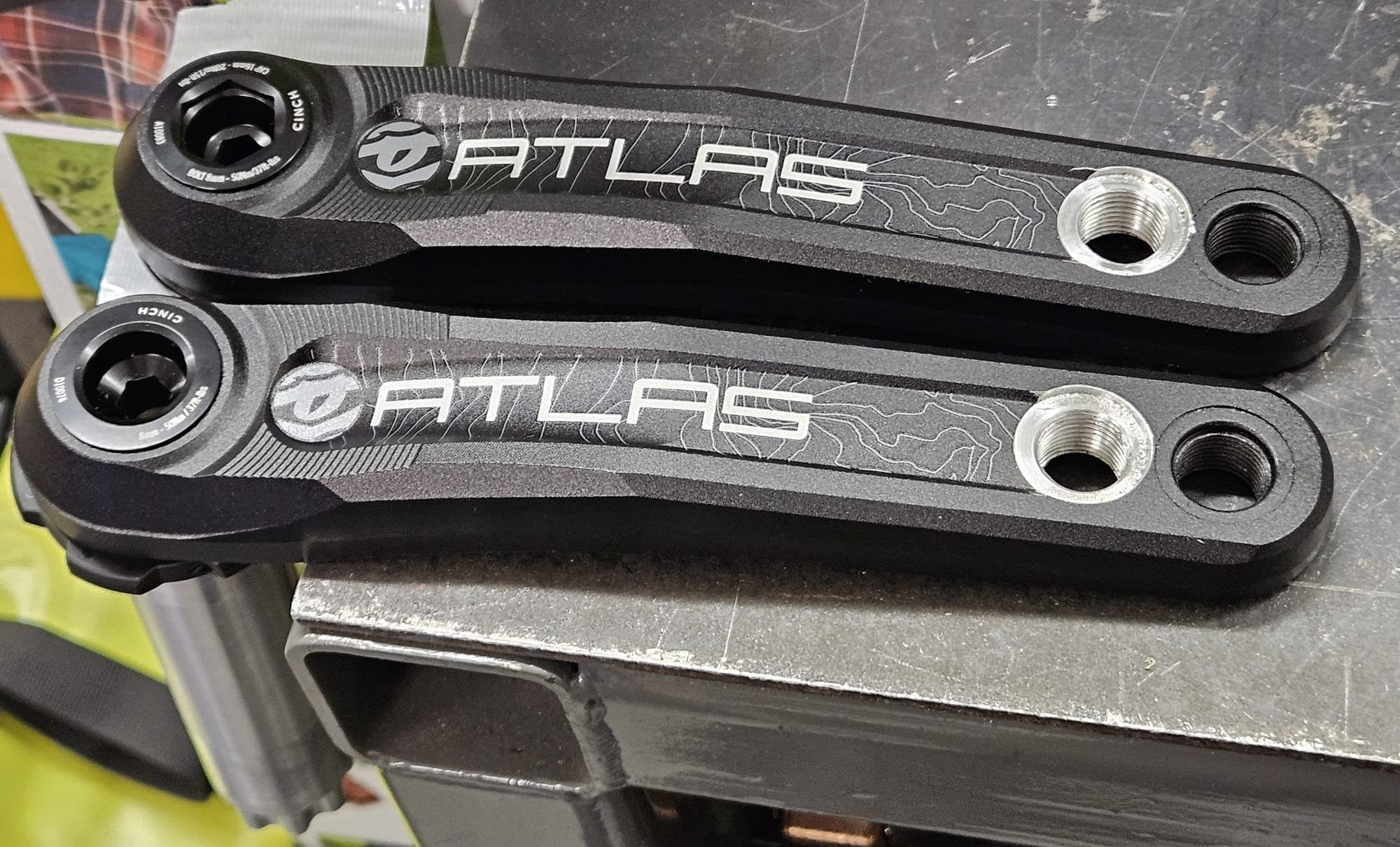

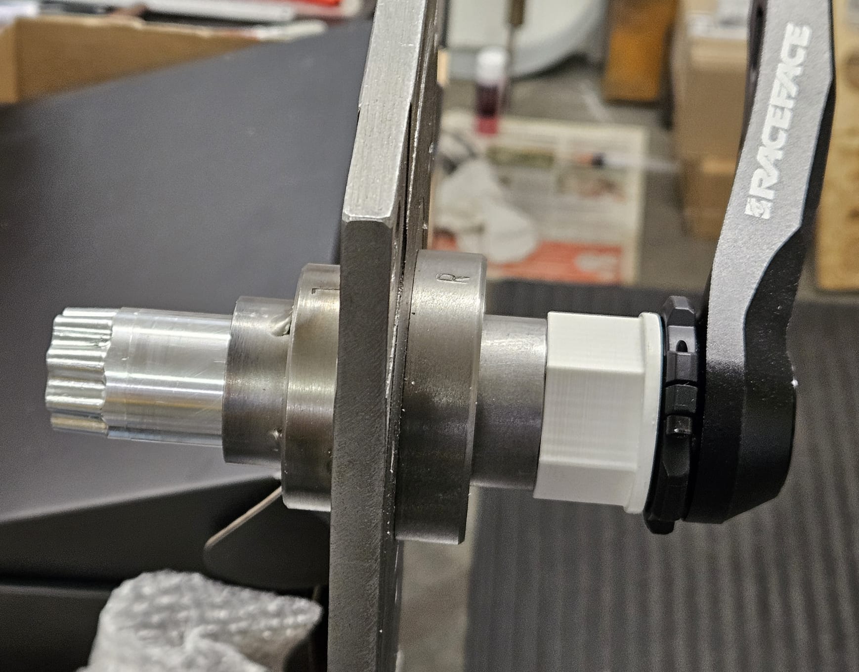

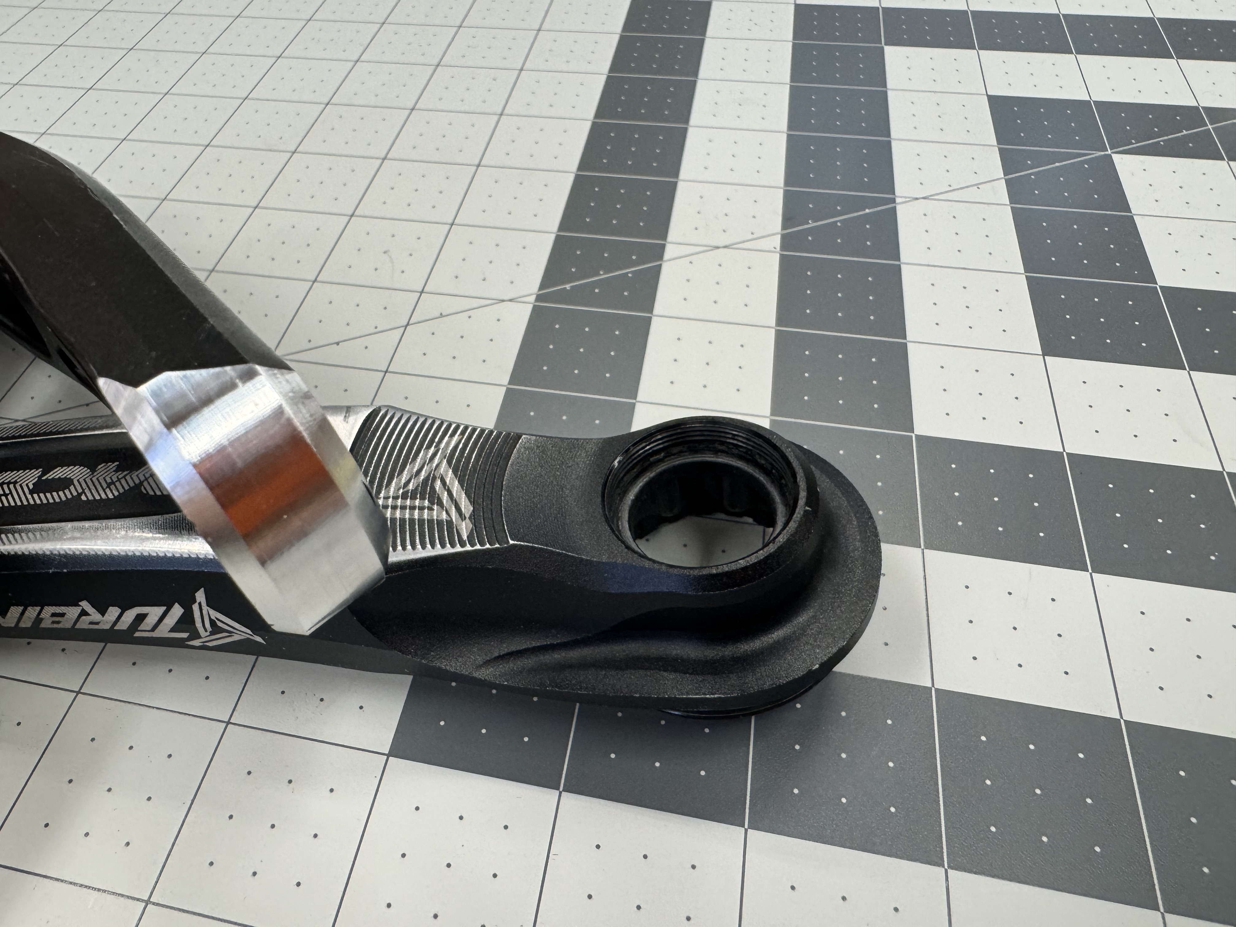

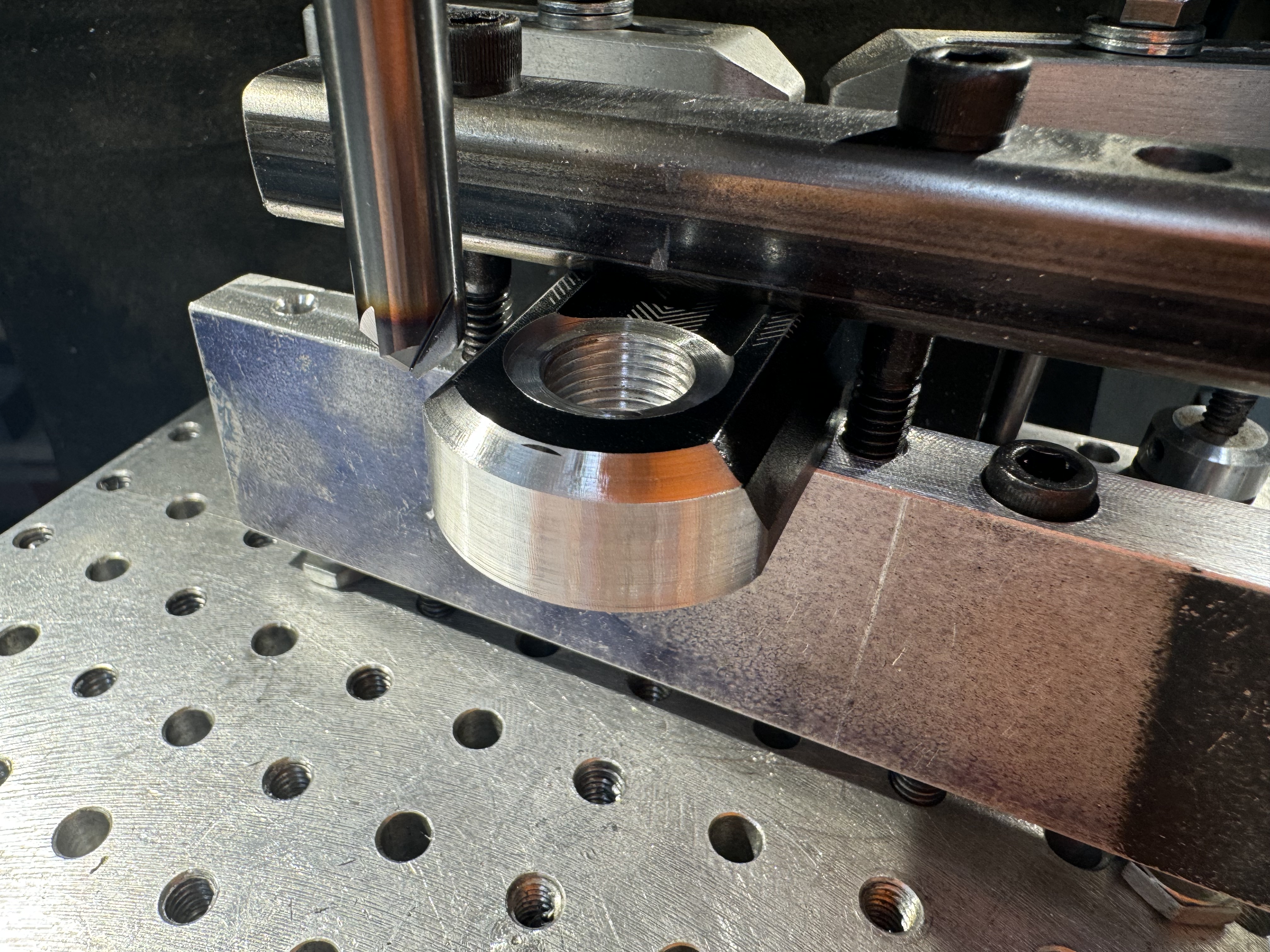

Was in contact to US and UK for shortening cranks but I thought maybe there is someone inside EU or even Finland. Found a leanbiker who has done shortenings for years. Followed the instuctions on here and now I have 150mm Atlas cranks on my Rocky Mountain. It's great. 182cm height, 84cm inside leg. Had 155mm FSA ISIS cranks on the previous bike and I definitely like the 150mm more. It's really necessary for Powerplay as the power delivery is so lazy compared to Bosch gen4 that you really don't want to stop pedaling. Just feels nicer to pedal even without the massive clearance benefit. 165mm original cranks on A50.
Cost total was 500€ for the Cranks, new BB, 30mm lockring, drilling and install.
Drilling cost and postage inside Finland 100€.
Contact detail for Teppo for Finnish and possibly other European customers so you can ship back and forth without taxes. [email protected]

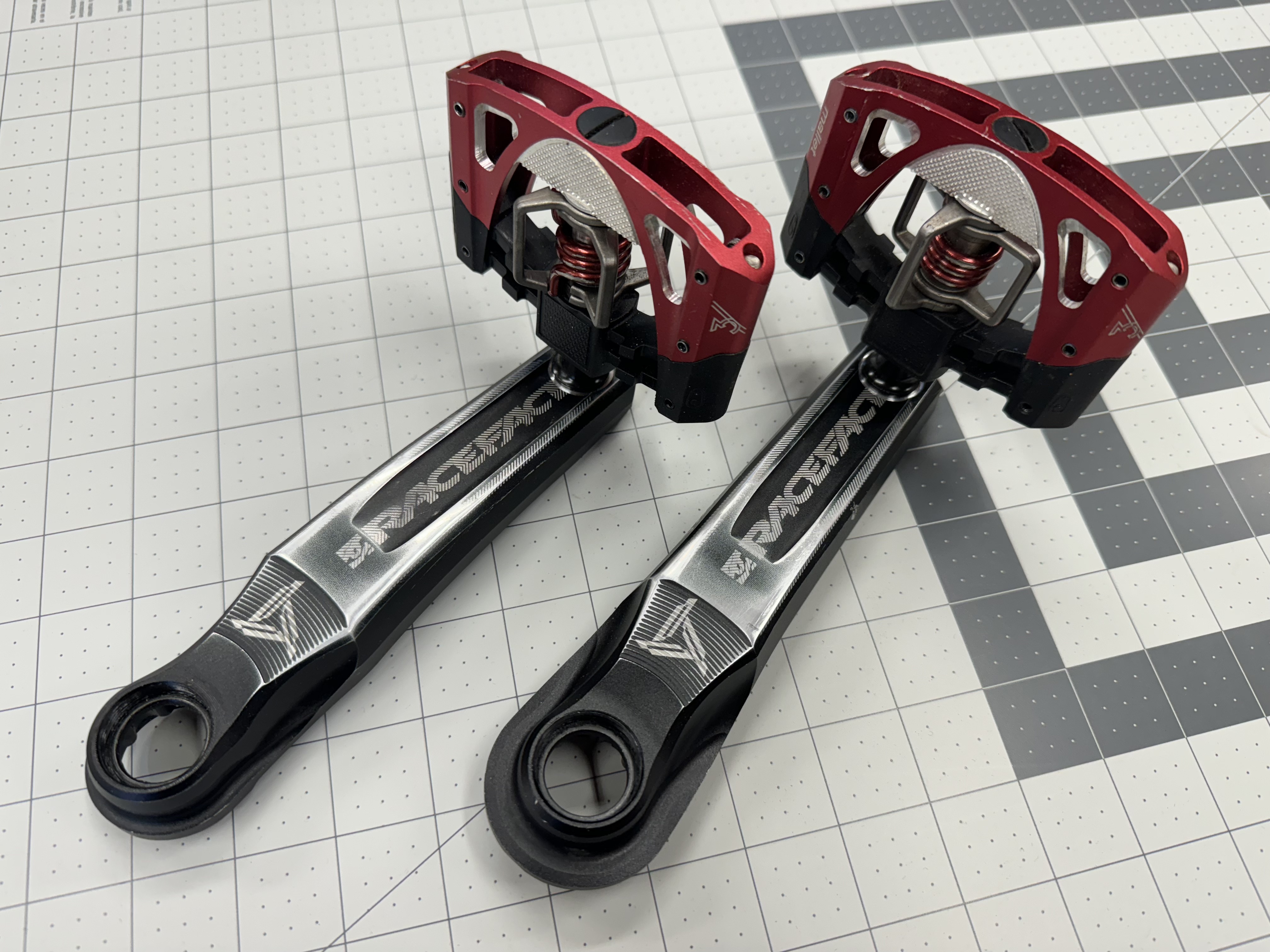

Are you saying this tool?
Bad Mechanic
Dec 17, 2021
87
35
Kensington, MD
No. The Race Face cranks with a normal crank arm bolt on one side, and a self extracting crank arm bolt on the other side. When you loosen a self extracting crank arm bolt it removes the crank arm from the spindle.
