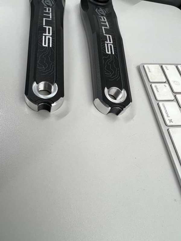

Yes you can machine them depending on which crank arms you have, Atlas have enough material to go to 155mm from the stock length but I think 150 will be risky. If you want 150mm you would need to start with 165's.

The solution for situation 1 is simplest. Buy a set of Atlas cranks in your preferred length. Shortest you can go is 165mm. If you buy the longer 175mm you can drill them down to 155. You can also drill Turbine cranks shorter, if you prefer that route. 170 to 150 is possible and 175 to 155 as well. Turbine is sold out everywhere so might not be the easiest option. Turbine does not come shorter than 170.

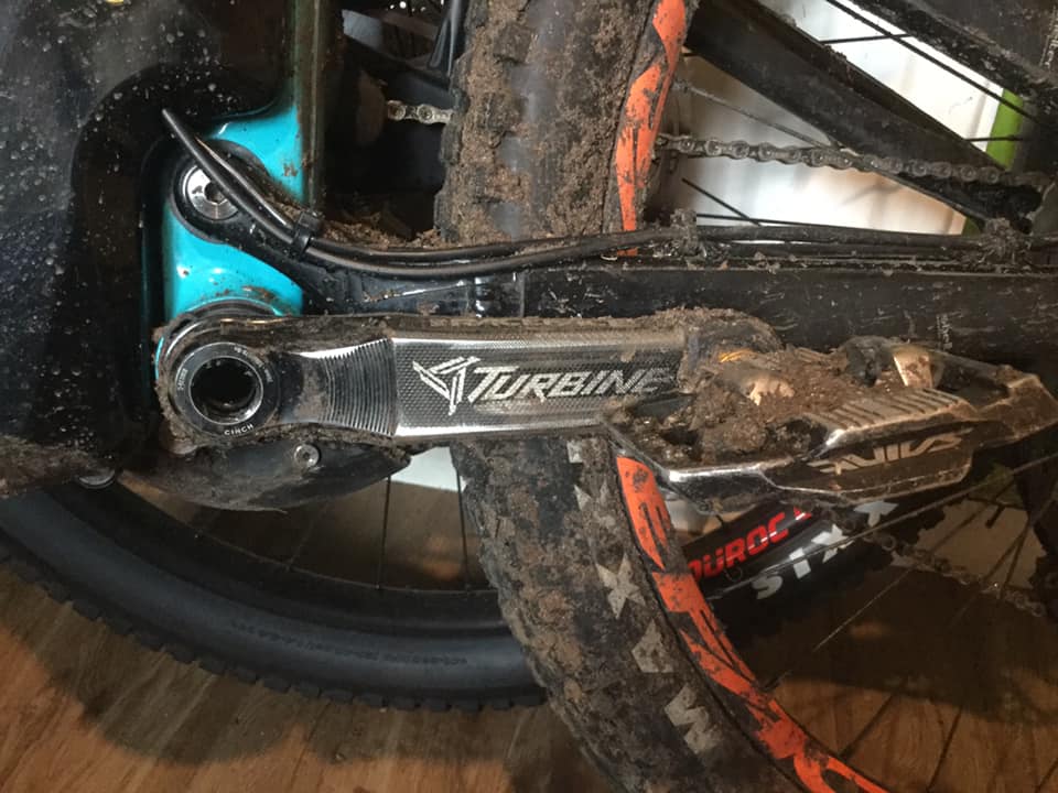

Atlas cranks drilled from 175 to 155 by Norman:
Turbine cranks drilled from 170 to 150 by Andy:
According to Andy, drilling 175 Turbine to 155 is also possible.

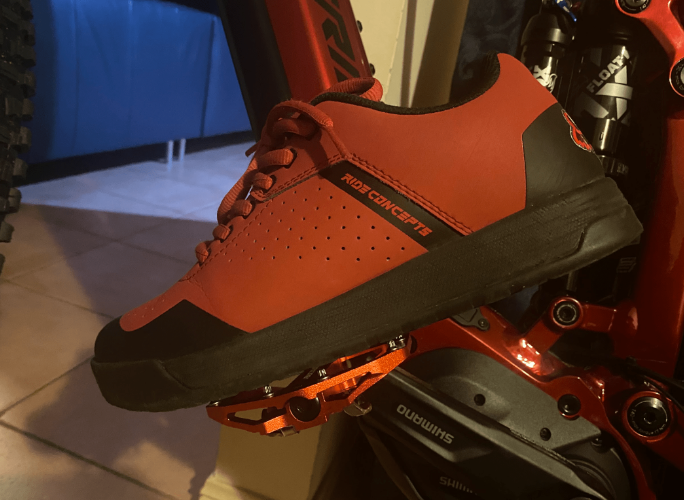

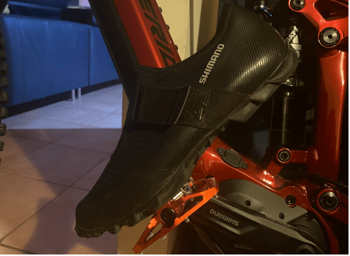

Got myself measured up using the old skinny box between the legs measurement, and it recommended 155mm cranks. I really wanted to stick with Shimano cranks on my EP6 motor so I got the 160mm.
Took it for a ride up some technical climbs, and it nearly reduced rock strikes to zero, compared with the 170mm cranks. Very, very happy.
Also added double sided pedals, so I can go flats or clipless. This also worked really well, so I can go the shops in normal shoes, and lend the Ebike to my analogue buddies when they get tired.
With clipless
With flats

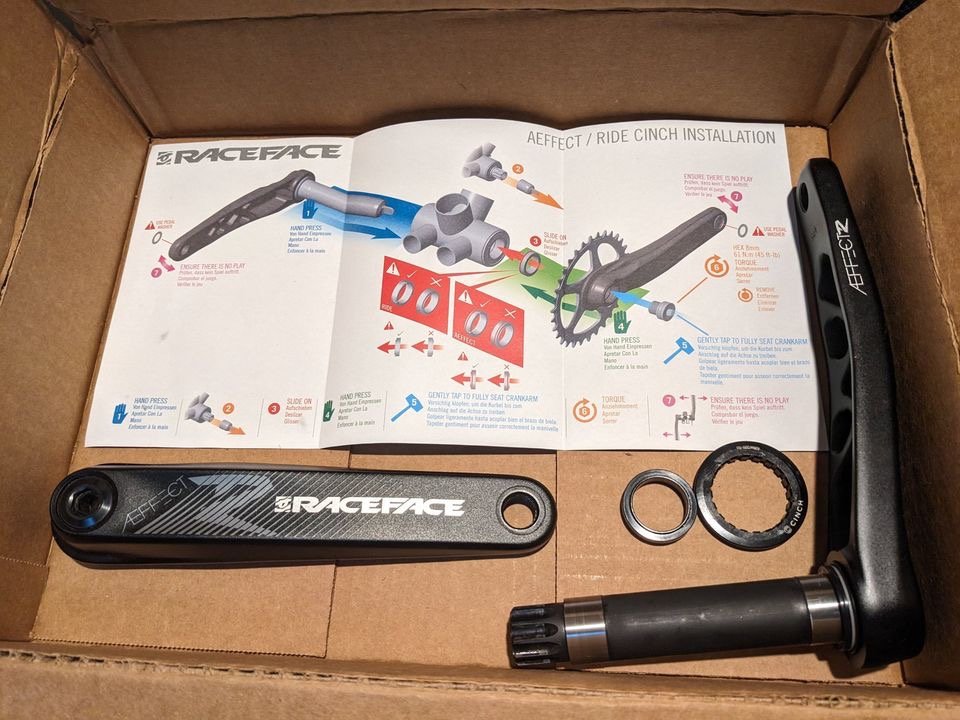

Great thread everyone! I have a found a used set of 175 Aeffect Rs locally which I could machine myself down to 155mm. My A70 has 170 Aeffects on it now. Are Aeffect spindles removable or permanently attached to one crank? If they are removable It seems like I could just use my original spindle with the newly machined crank arms. If they are not removable what do I need to check regarding the spindle specs on the used set? Used set I am considering shown below. I do not yet know the spindle specs. Thanks.
I'm pretty sure the spindle is permanently attached to the left crankarm, and from looking at the picture I can tell it's too short. You need the ~150mm long spindle, which are only available for the Atlas and Turbine cranksets.
Thanks BM. I see now that the those options are presented specifically because they can be used with a variety of spindle lengths.
