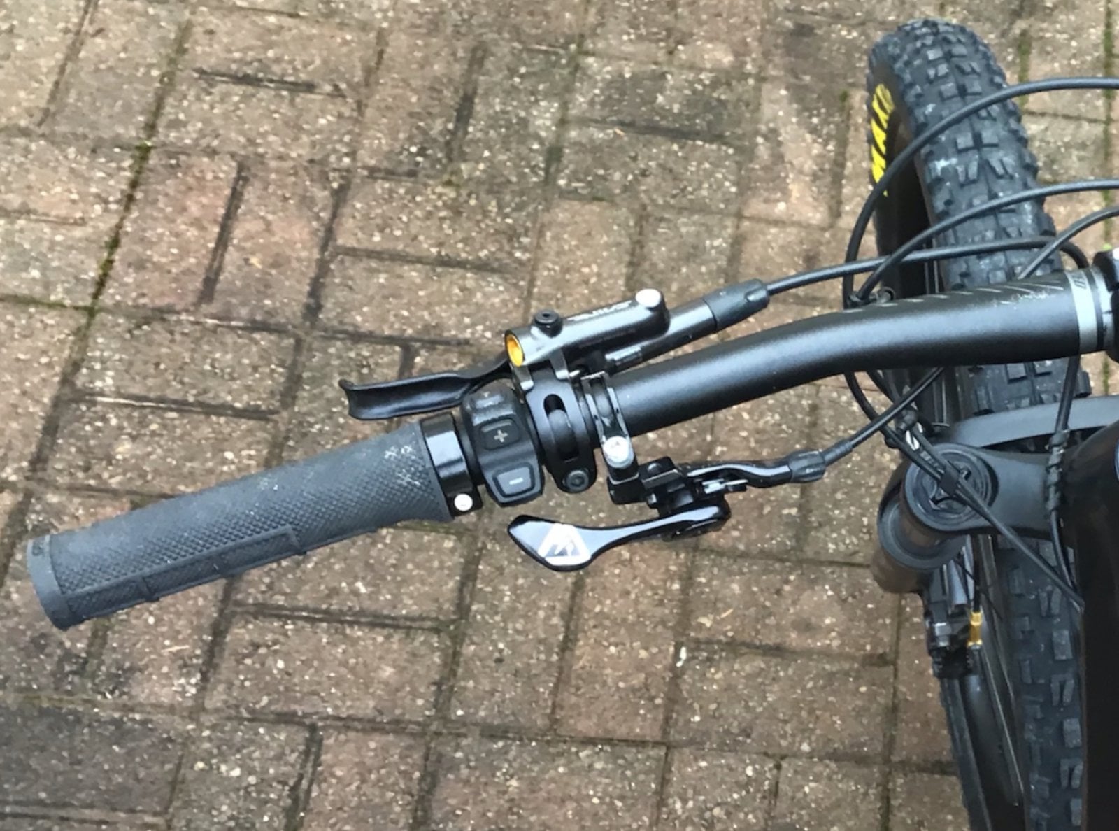

For those here that have changed/upgraded their brakes - has anyone had any issues running the Levo (I have a '19 Expert) handlebar remote between the brake lever clamp and the grip?
I'm looking at a set of XT M8020's, but the clamp position doesn't look like it would allow for enough space to fit the handlebar remote next to the grip, when positioning the lever in a normal place for one-finger braking.
Kiwi in Wales
Short cranks rule!🏴󠁧󠁢󠁷󠁬󠁳󠁿
Jan 24, 2018
1,241
1,589
Carmarthen, Wales
Here you go, is this what you are looking for?
Ok, they are not XT’s but Saints but they have a very similar clamp.
Hope this helps.

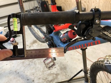

Hope this helps.
Hey man, thanks for posting the pic. The clamps do look pretty similar. My current brake setup (Code R's) has the lever approx 90mm from the end of the grip. Do you think that brake position would be achievable?
