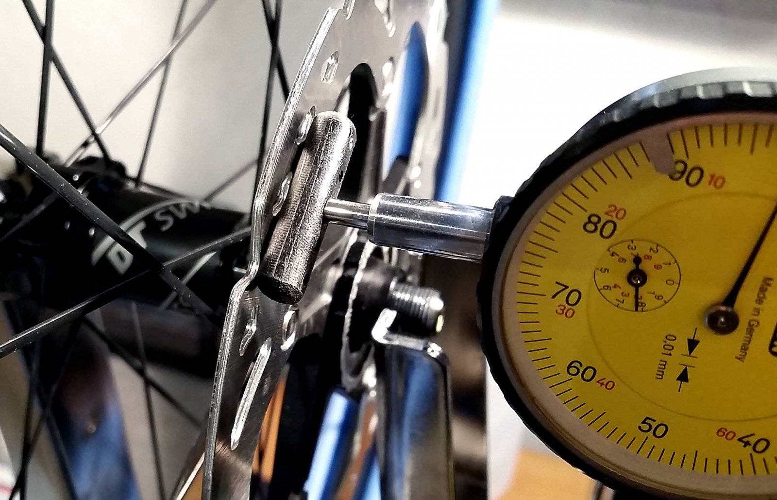

Thomas
Aug 29, 2018
248
255
Europe
I heard that brake 'cable' diameter might be an issue when routing it through frame holes, if replacing the original SRAM ones. I am talking about TL 2017-2018
Well you heard it wrong. Replacing existing Sram setup is really straight forward, whether you go with Shimano or Magura.
With this little helper, you just attach old and new cable and you have the new one in the frame in matter of minutes.
RockShox Reverb Stealth Barb Connector | Seatpost - Accessories Shop
My only gripe with Magura is, that you practically have to be a surgeon, to setup the brake pads not to rub.
The tolerances left and right are so small, that you can maybe fit 2 papers on both sides. Compared to Sram and Shimano this is just ridiculous. Maybe this is a trade off, for other benefits that Magura offers.

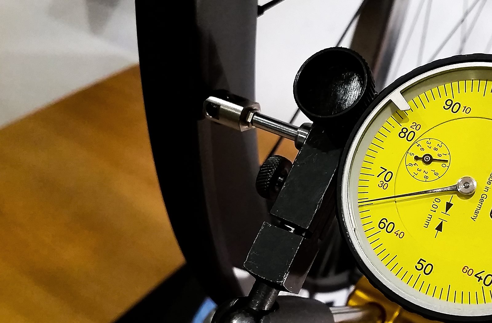

Also the problem is, that with 6 bolt setup, you are not getting perfectly straight Rotor. Well when looking with naked eye you do, but when I put the wheel on this machine, where I can measure 0.01mm tolerance, I get 0.2mm on new Rotor in some segments of the rotor.
This would be totally acceptable for Sram and Shimano, but really on the limit with Magura. So At the end I had to bend and straighten the new Rotor..
I'm just "little" too paranoid and "too" picky, because even if you have some small rubbing, you want here this when riding this beast.
