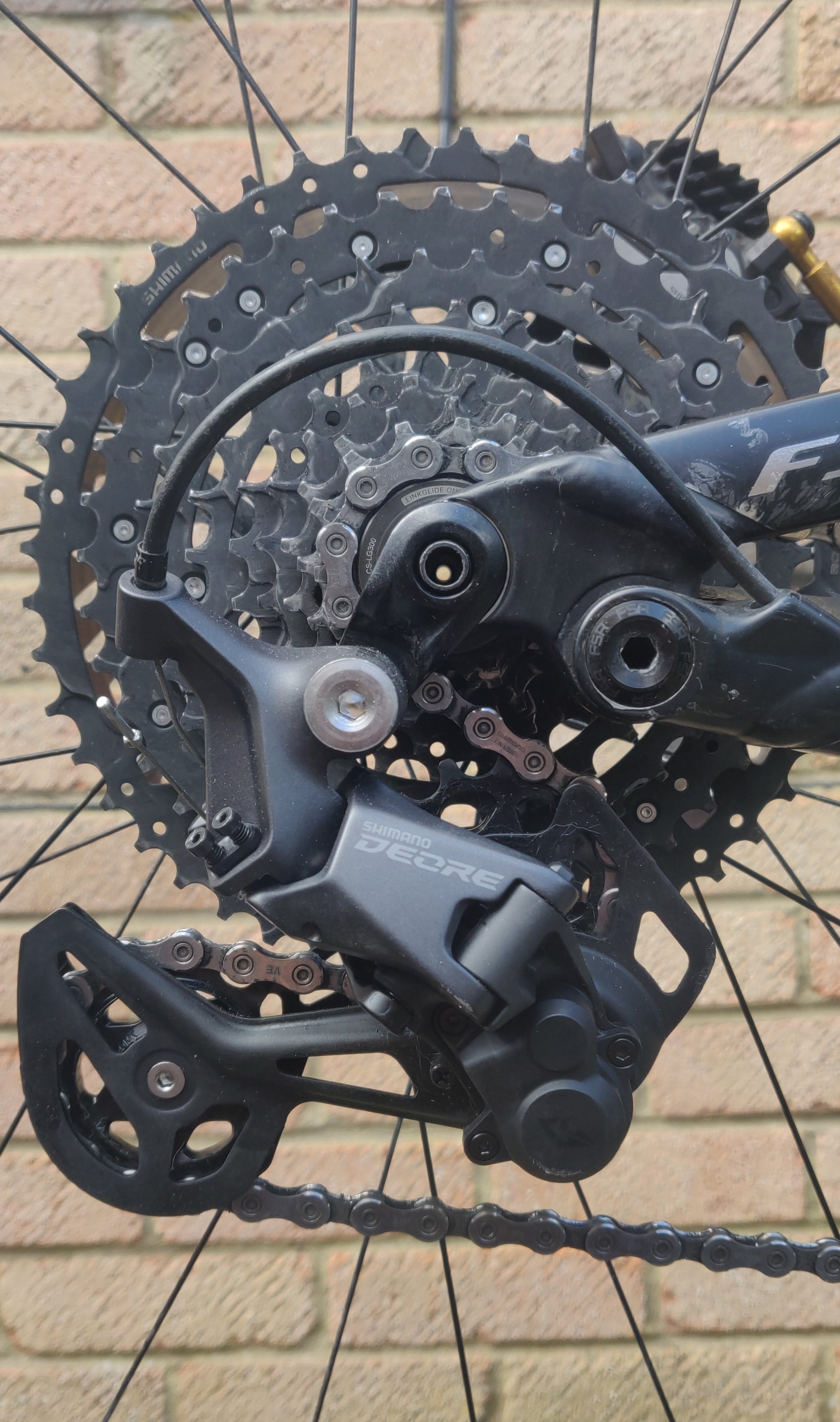

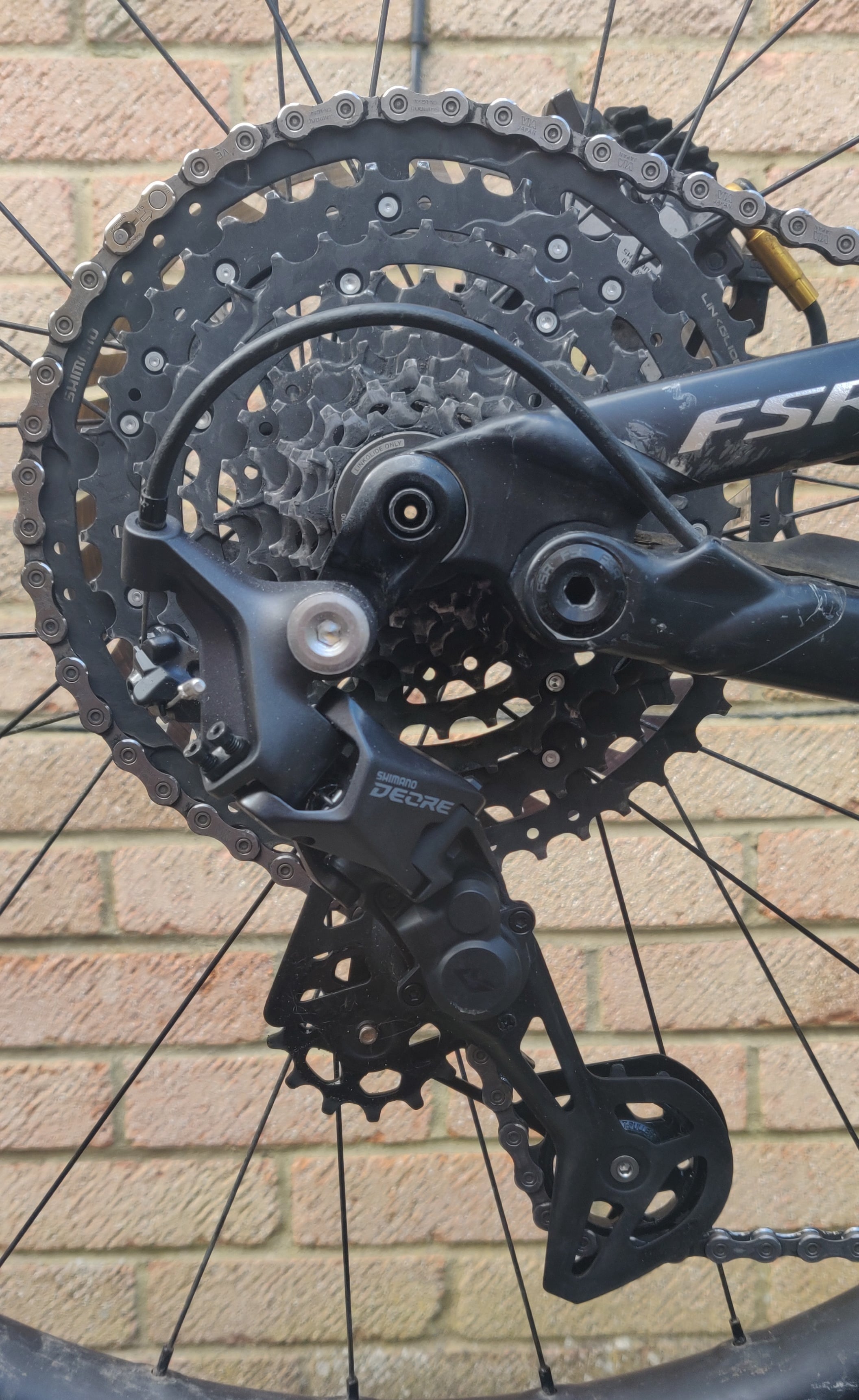

Seeing as I have many times suggested using the deore short cage 10 speed linkglide derailleur with the cues 10 speed 11/48 cassette, I'm finally able to fit it to my bike and take some pics.
Designed for a max of 43t cassette, but fits the 48 fine.
Smallest cog. Good chain wrap.
Biggest cog. Not overstretched.
