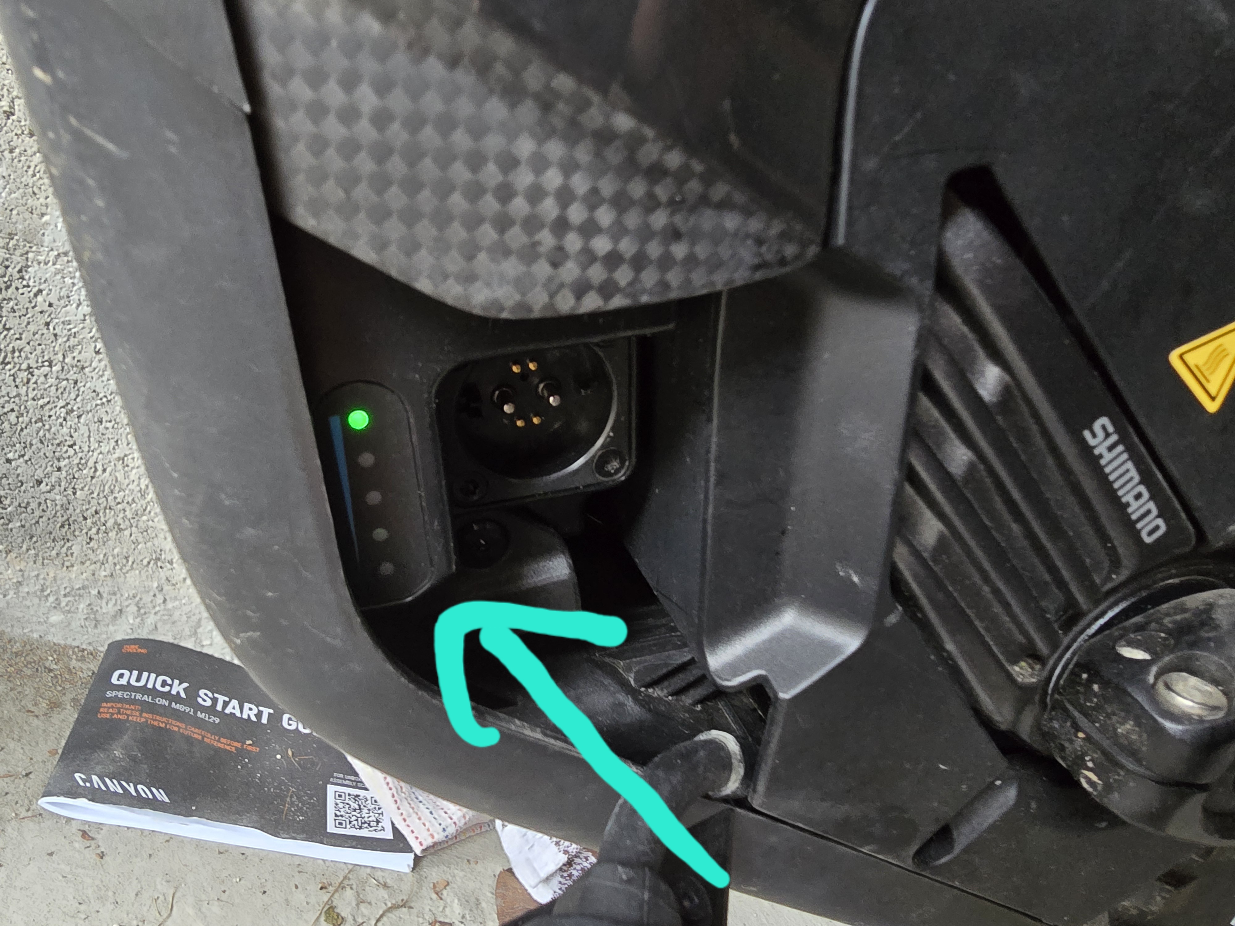

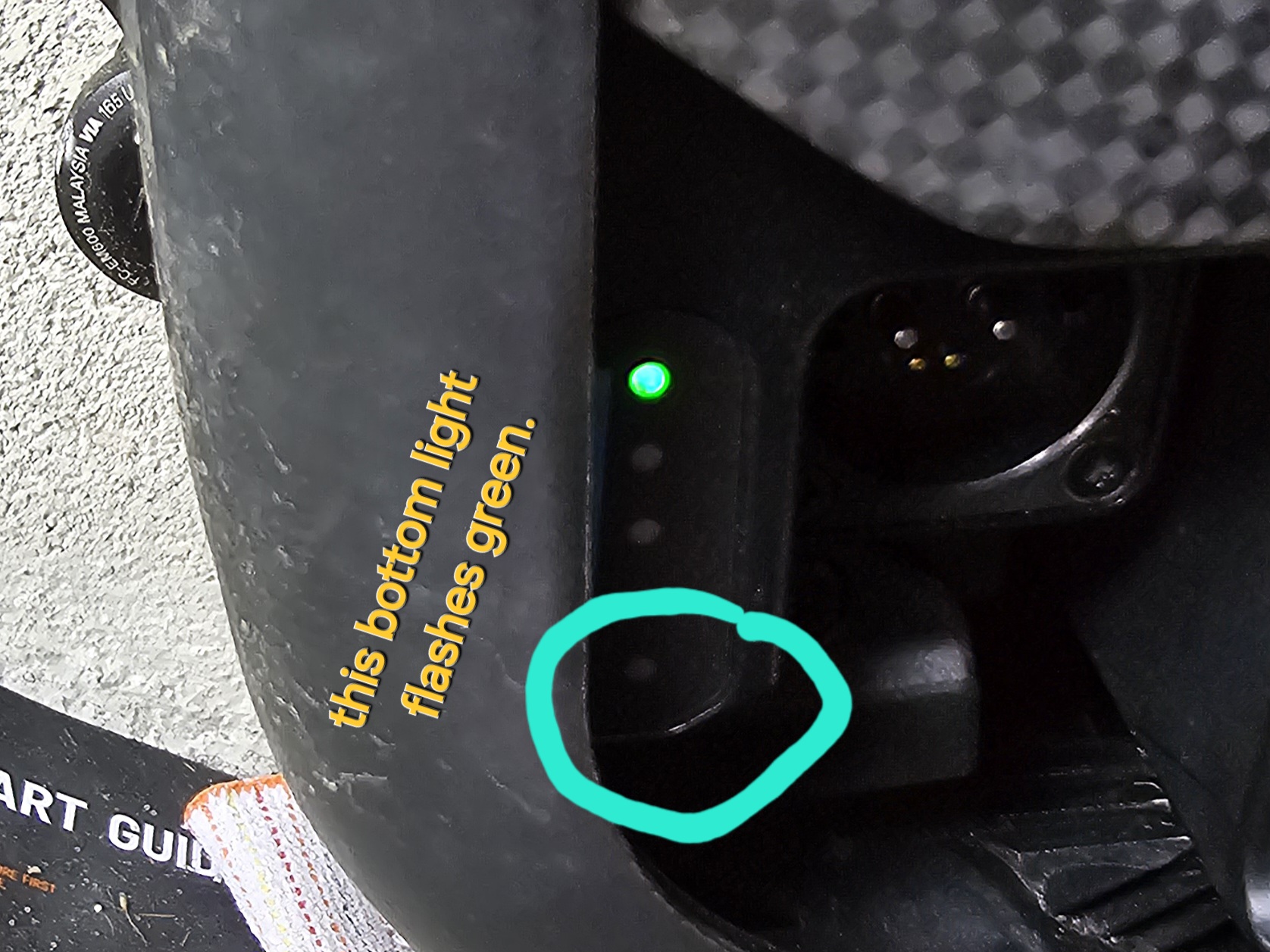

Hi all
I have a canyon spectral on CF 7 2023 model. I was riding the other day and the motor stopped working and also the control panel.
I have tried.taking out the battery, recharging but it's not working.
I have two green lights. One constant and the other flashing in green.
I assume the warranty will be good, just a pain to get to the authorised dealer.
Anyone aware of the issue and an easy home reset?

I’m having the same exact problem. My bike shuts off while riding and the battery led lights look just like yours. Did you ever find out the issue?
