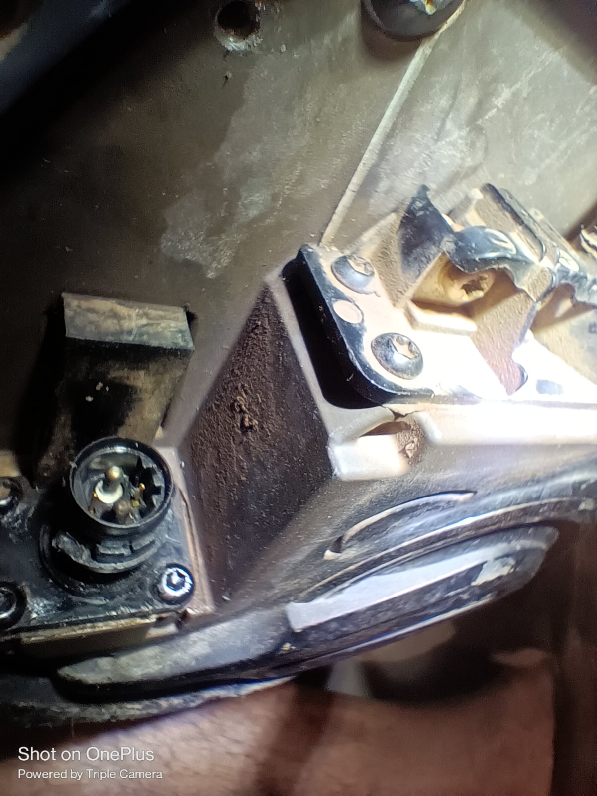

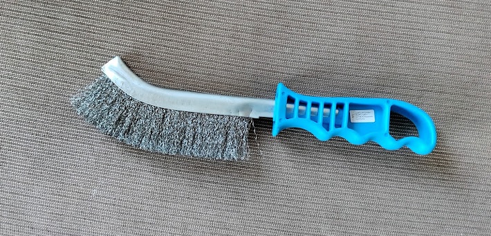

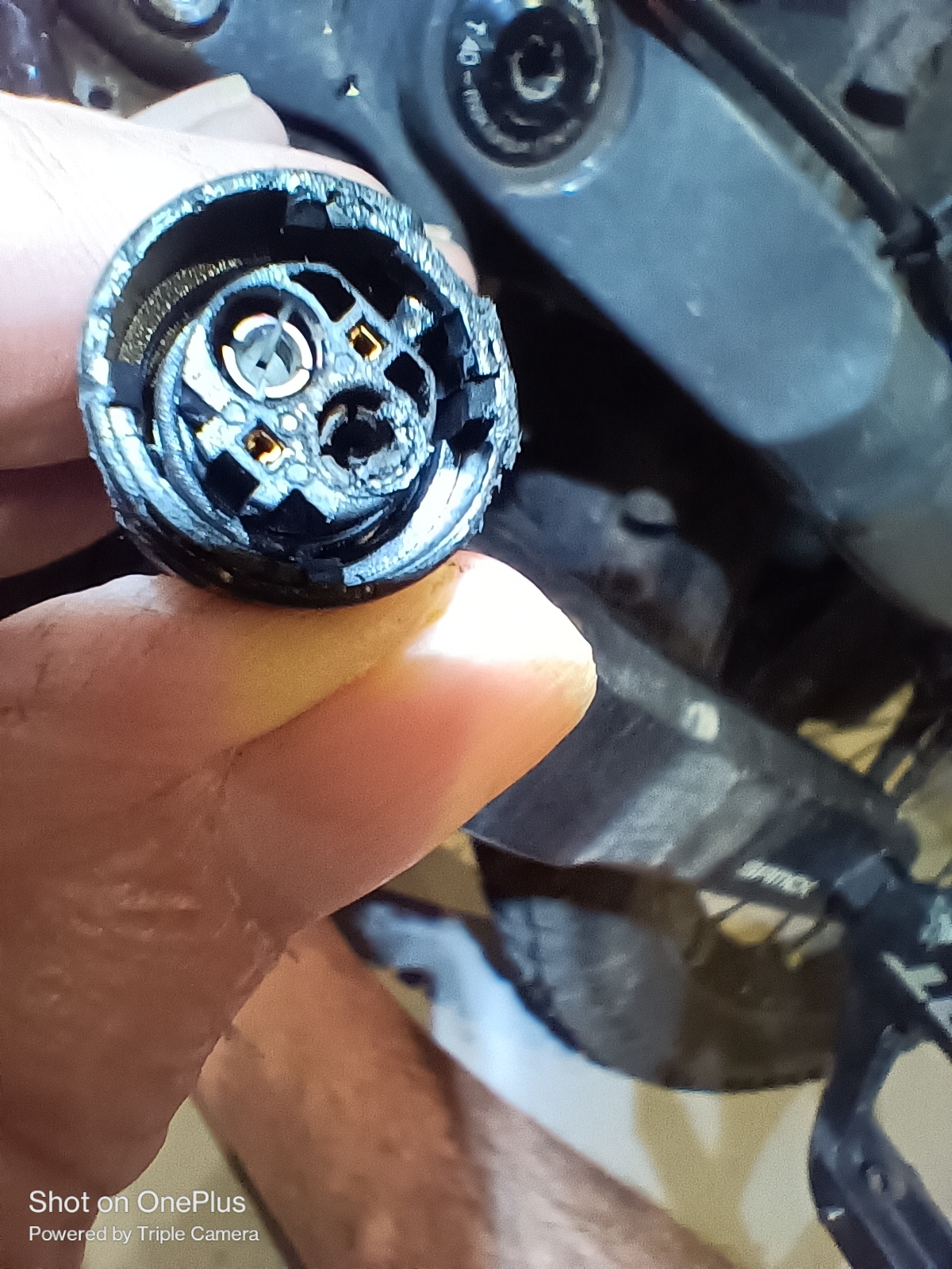

probably the connectors between the battery and the battery holder. After I got my new motor I still got a couple of E010 errors, but preceded by the error E020 which means there are connections problems between the battery and motor.
I got one of these and it's one of the best investments I have made for my bike:
Nowadays I always clean the contacts of the battery support before every ride and I have never again had any E010 errors.
