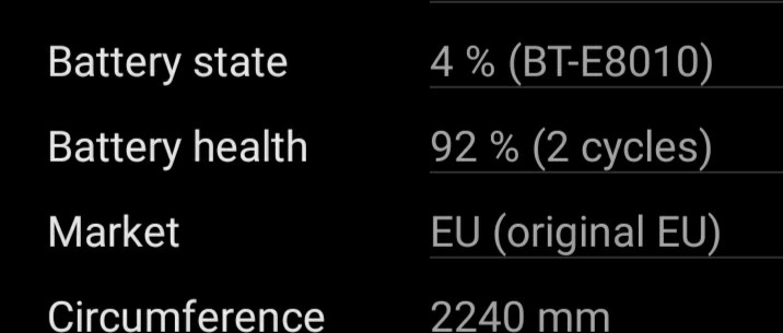

I've bought a brand new BT-E8010 battery due to the degradation of my previous one, but it seems the new one is going to be the World's fastest degrading accu ever. Here are the battery info from STUnlocker read yesterday just after my ride:
It dropped 8% of health just after 2 cycles! During these two charging cycles I did 88 km with 3187 m elevation up and 90% of this was ECO, 10% Trial and zero boost.
I use the EC-E6000 charger.
At what values do you think I could return it under warranty?

Shimano is unlikely to warranty the battery at 92% although I would try. If they do agree to warranty it I would use it for as long as possible as the warranty replacement may have the same problem.
I had a warranty replacement bt-e8035 go from 100% to 91% after 4 cycles and 20 days, Shimano refused to warranty it saying that they only replaced the original battery the first time at 20 cycles and 87% health as a courtesy.
I tried again to warranty 4 months later when it declined to 87% health at 20 cycles (same as the first one) and Shimano again refused to warranty it saying it needed to be at 60% health.
The battery is now only 13 months old at 78% health and 76 cycles.

Thanks @nosenada for sharing your experience. I'll go for a ride today and try to deplete the battery in the trial and boost mode and observe the health status change. This is inconceivable to have 8% less range just after two cycles.
I understand a Li-ion reaches its max performance only after a couple of cycles... could it be that it hasn't reached it max capacity yet?
I'm pretty aware of storage charge values, but have conflicting information on what to do to "break in" a powerpack from new. One says never to deplete, and do a couple of regular cycles; the other (a BMS-specialist) says to completely deplete it 2 times, and only the start using it as normal.

The only tip regarding the first time use in the Shimano manual is "The battery cannot be used at the time of purchase. Before riding, be sure to fully charge the battery". Nothing else regarding any special treatment like the two times depleting (mambo-jumbo?). Besides I have no chance to store it properly before it deteriorated the 8% of health. My frustration is high. I'm charging it for the 3 cycle at the moment. Very curious what the STUnlocker will show this time.
