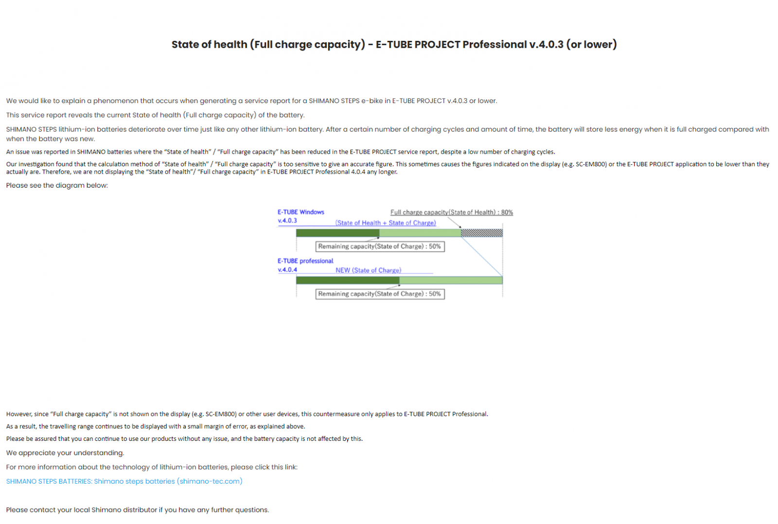

Found this on the Shimano-TEC site...

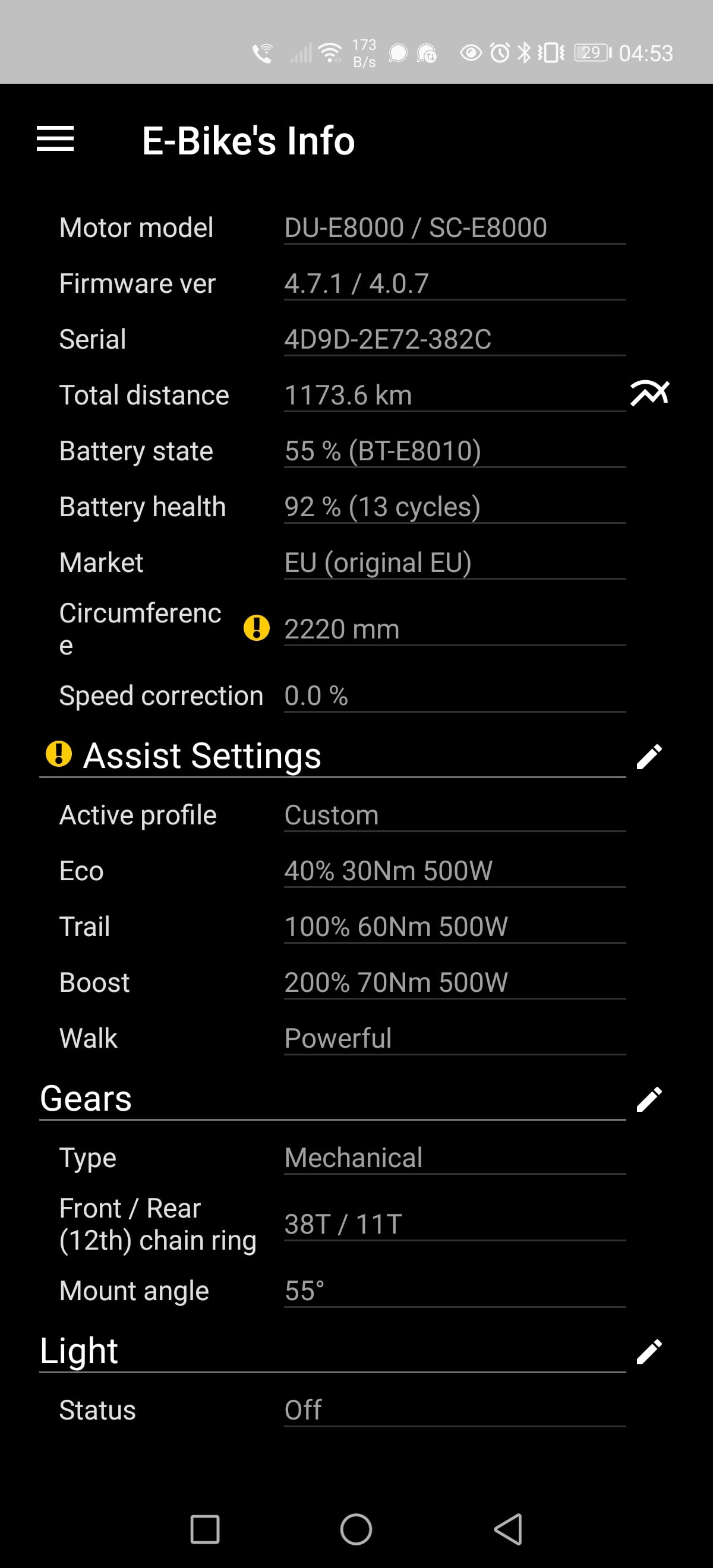

Shimano did not solve problems with degradation of 1st gen batterries so I hope there will be some compatibility between generations and it will give us more life time on batteries. On my 8010 battery I already had 92% after 13 cycles and just 1200km.

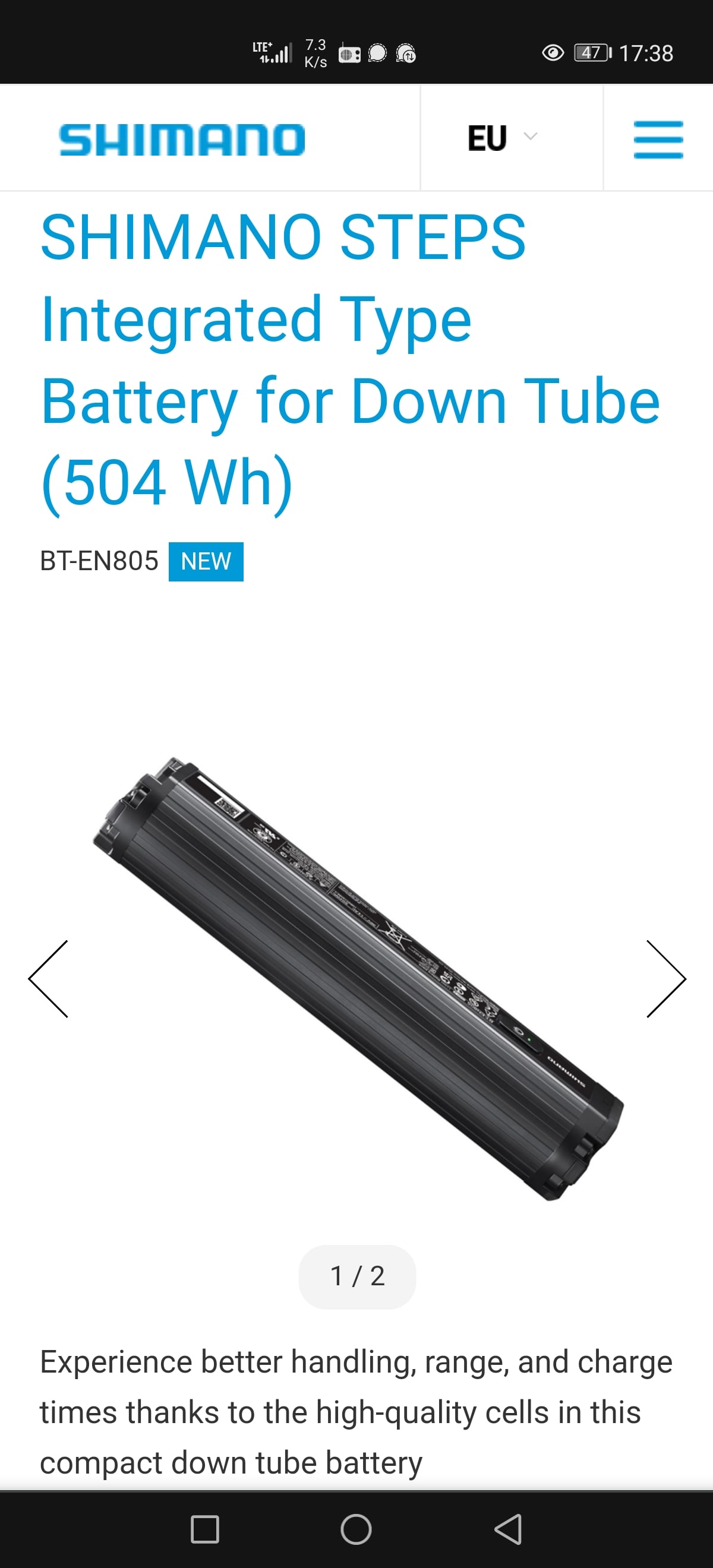

Can anyone confirm that Shitmano have released a new 504wh battery with different cells and bms.

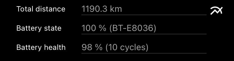

Sorry for the delay… interestingly, I have 96% battery health at 28 cycles and 2840km on the clock.
This indicates that my average range is 100km.
However, on full battery stored in a warm place the bike still indicates theoretical range of 170km in Eco mode. Riding in 0-5° C the battery range is definitely well below 100km… we will see in spring and summer.
