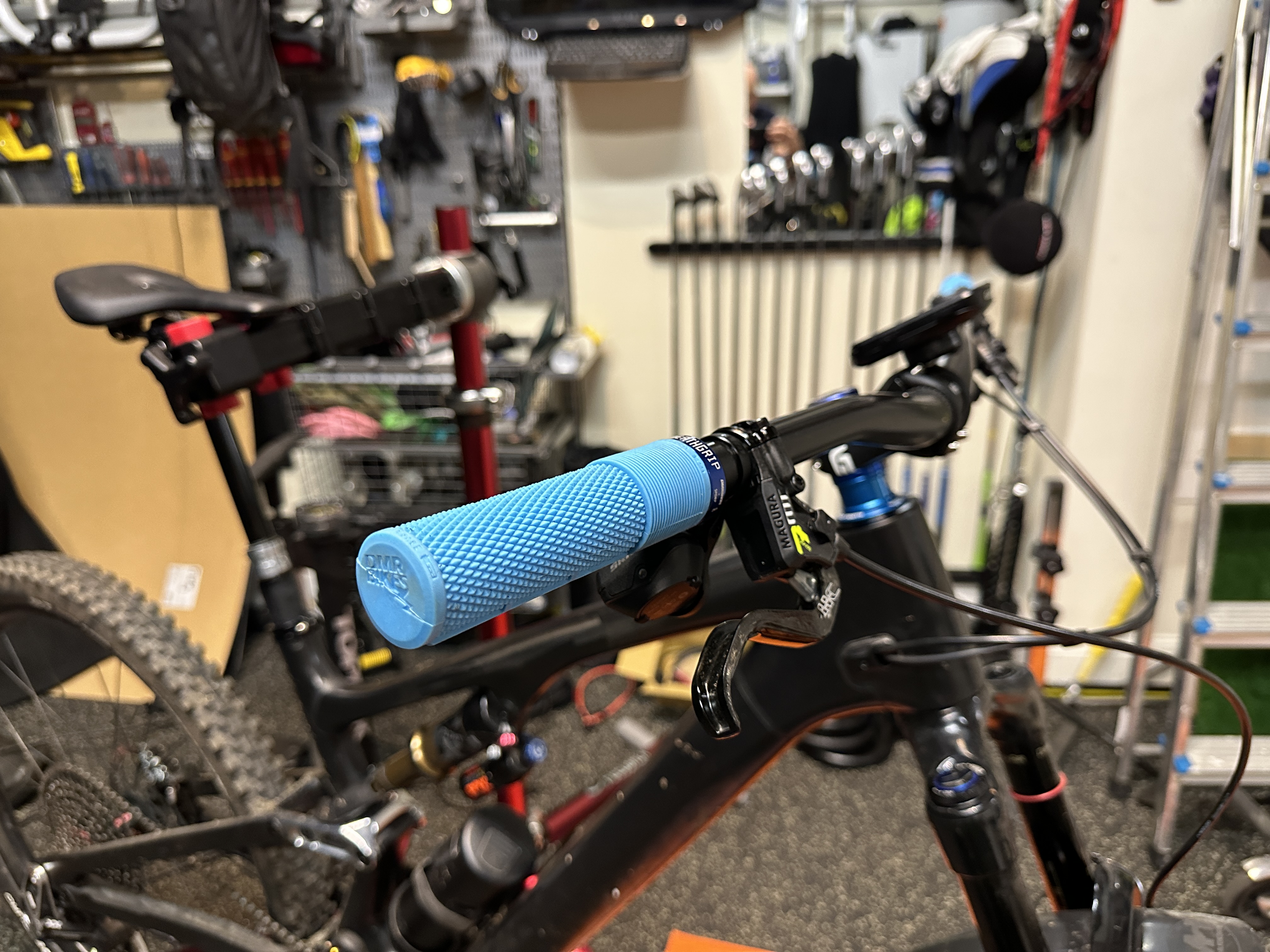

Try rotating your brake levers up a bit, they look very low which might not help
I noticed the brake angle as well. As set up it looks like you’d be rotating your weight forward adding pressure to your hands/wrists, also on any steep downhill your weight should be distributed straight from your palms through to your shoulders with less squeezing of grips and easing stress on hands/wrists (when climbing you can lean more forward as needed, redistribute your weight).

I have a couple of pairs of Ergon grips from my previous bike. Something else to try after the brake levers…

I had the GE1 Factory on until a couple of weeks ago, and have a pair of GS1 Evo in a drawer that I used for a while. Haven’t tried GP1 specifically, but the GS1’s are the same idea.
I’ve changed the brake position for my ride tomorrow and will see how that goes first.
There is a lot more climbing in the ride I have planned, so maybe I won’t be gripping so hard either for extended periods!
