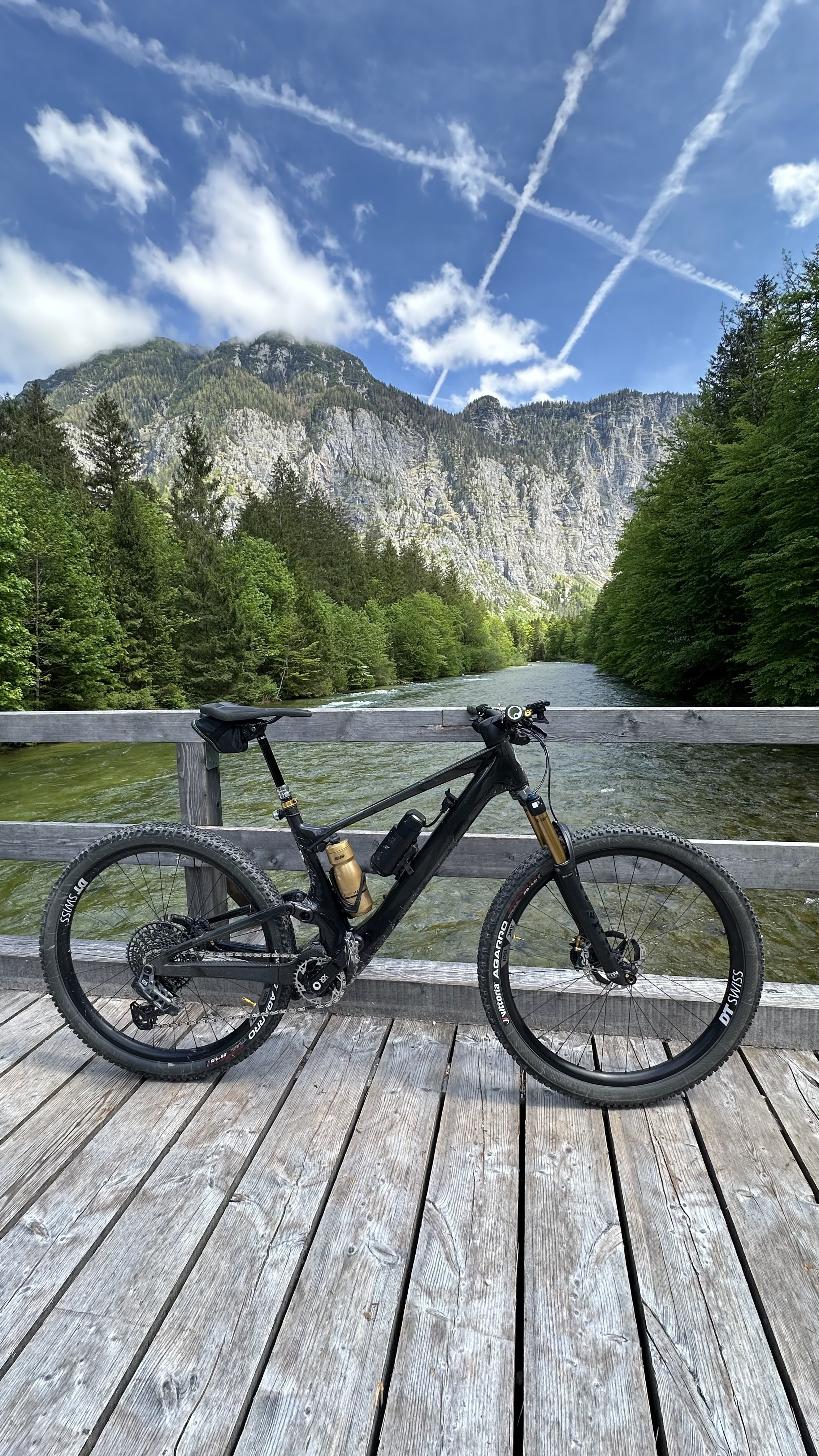

Scott Lumen eRide 910 customized
Tomoooo
Jan 4, 2024
16
12
Slovakia

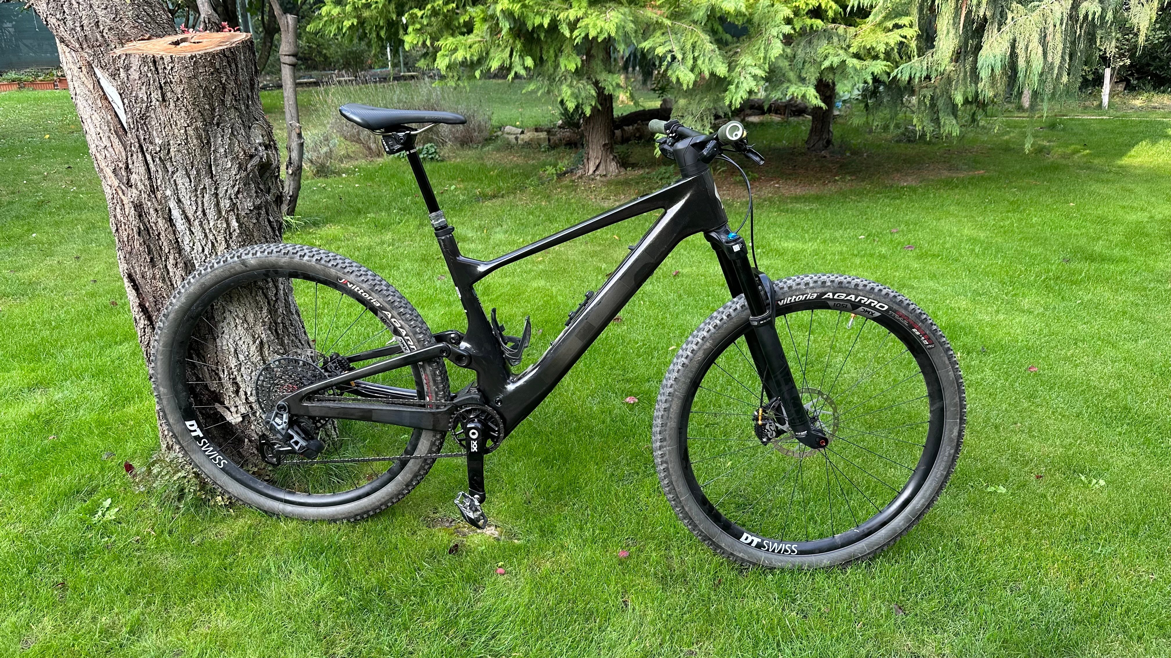

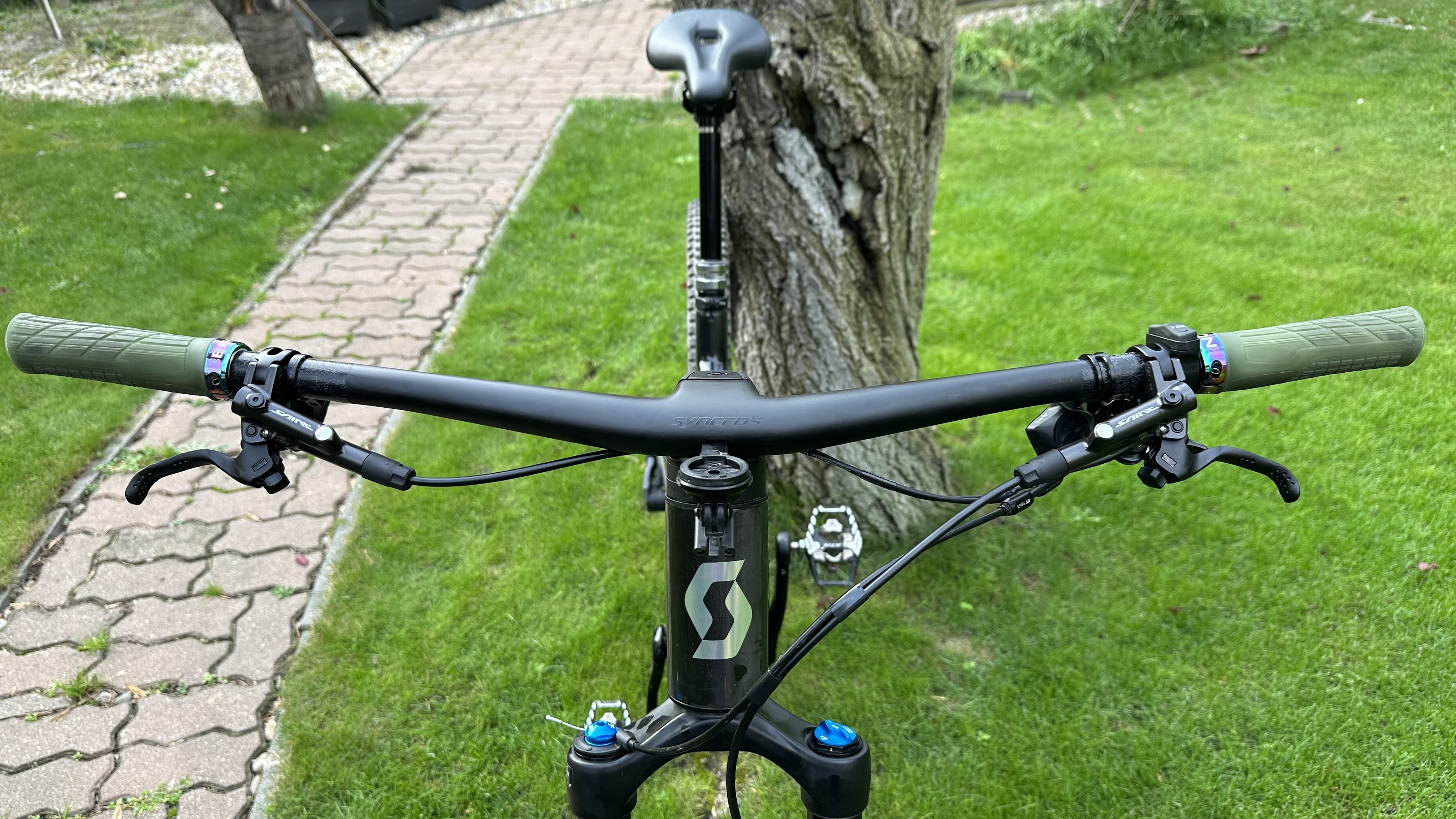

upgrades (latest update as is)
DT Swiss XMC1501 carbon wheels
Vittoria Agarro 29x2.35 tires

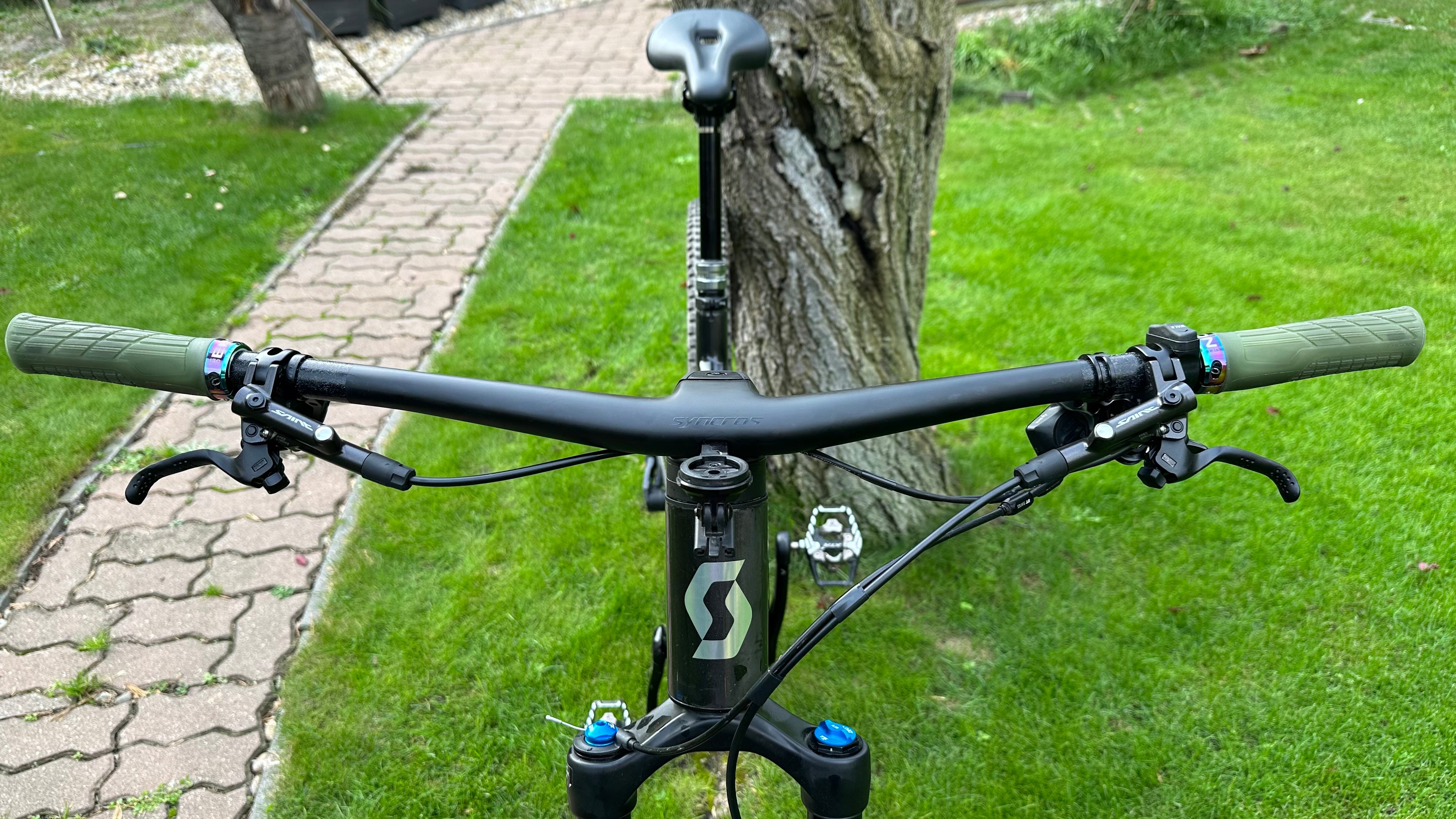

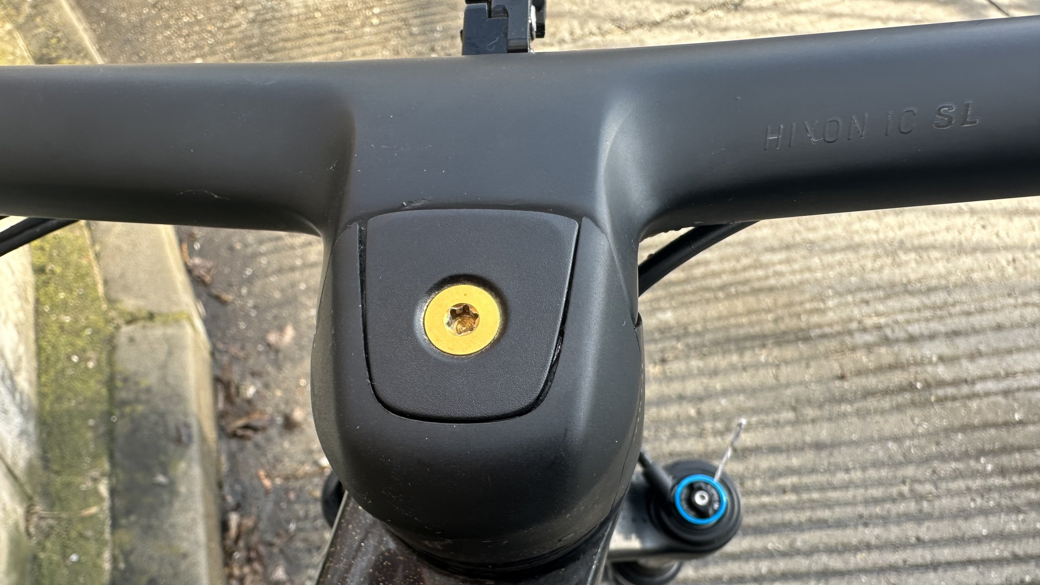

Syncros Hixon integrated carbon handlebars
Shimano Saint Brakes
sram TQ 34t chainring
Sram XX carbon cranks
Sram GX AXS Transmission deraileur
Sram XX cassette and chain

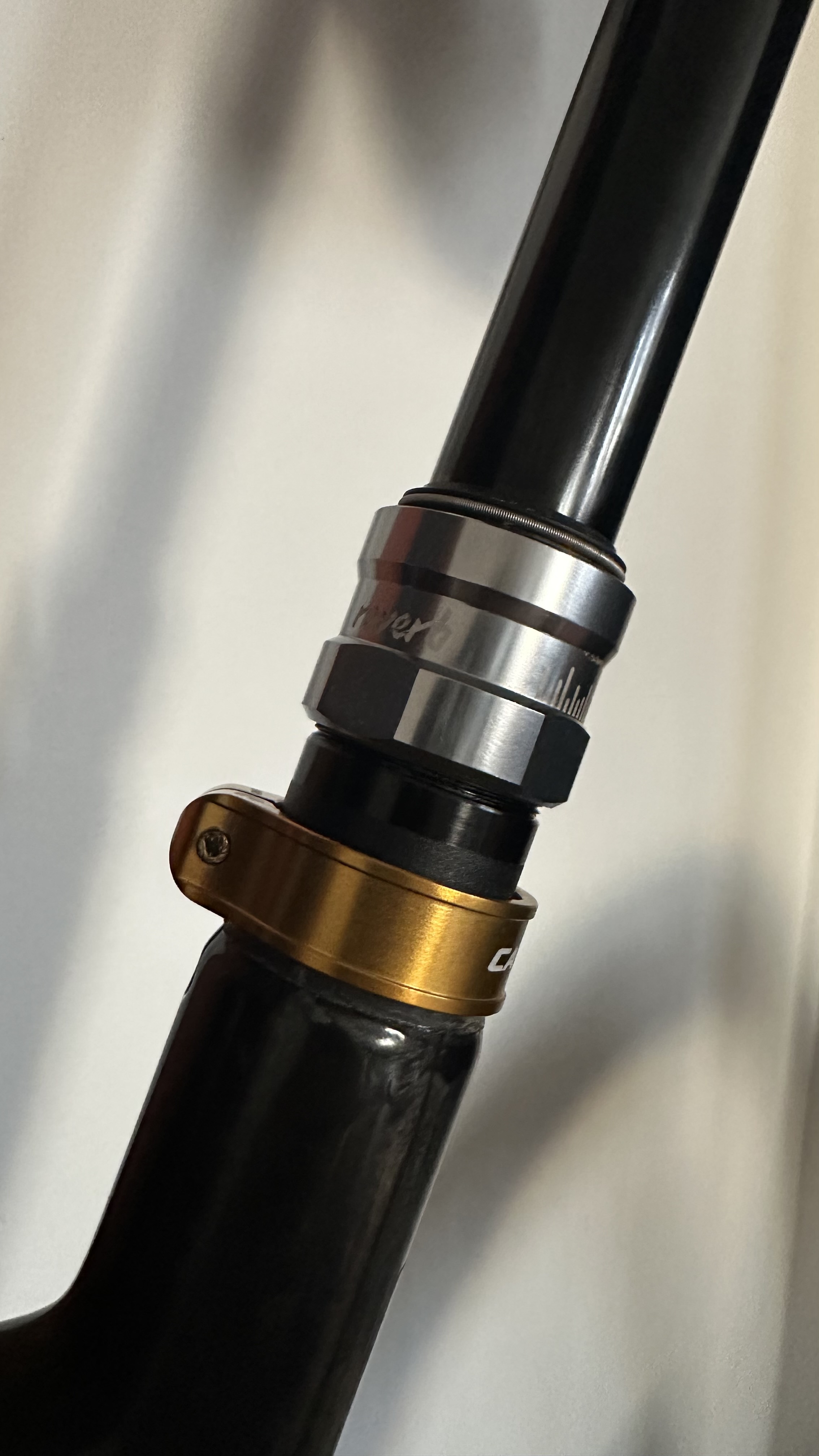

Sram AXS Reverb dropper
SQ lab 60x infinergy seat
DT swiss fork remote
Ergon GE grips
Shimano XTR pedals

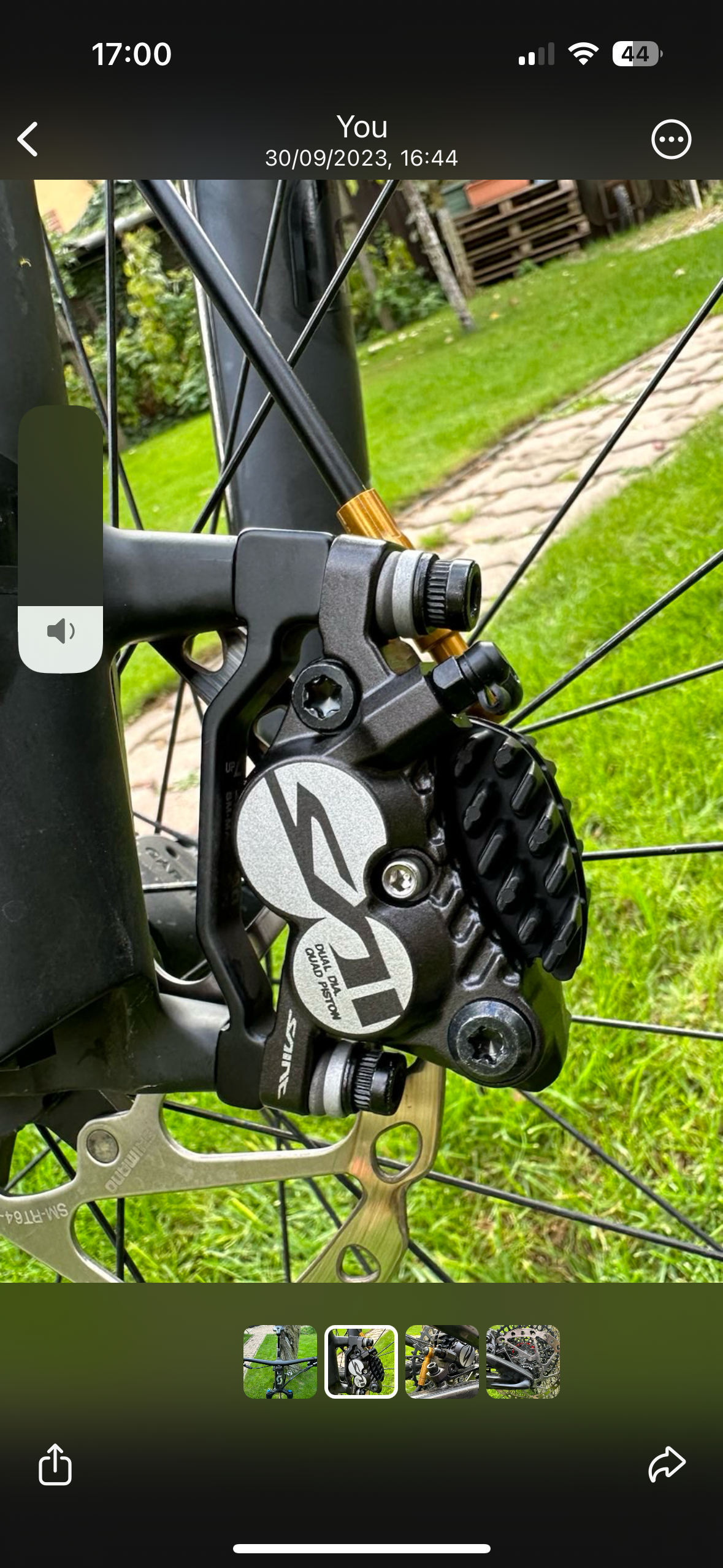

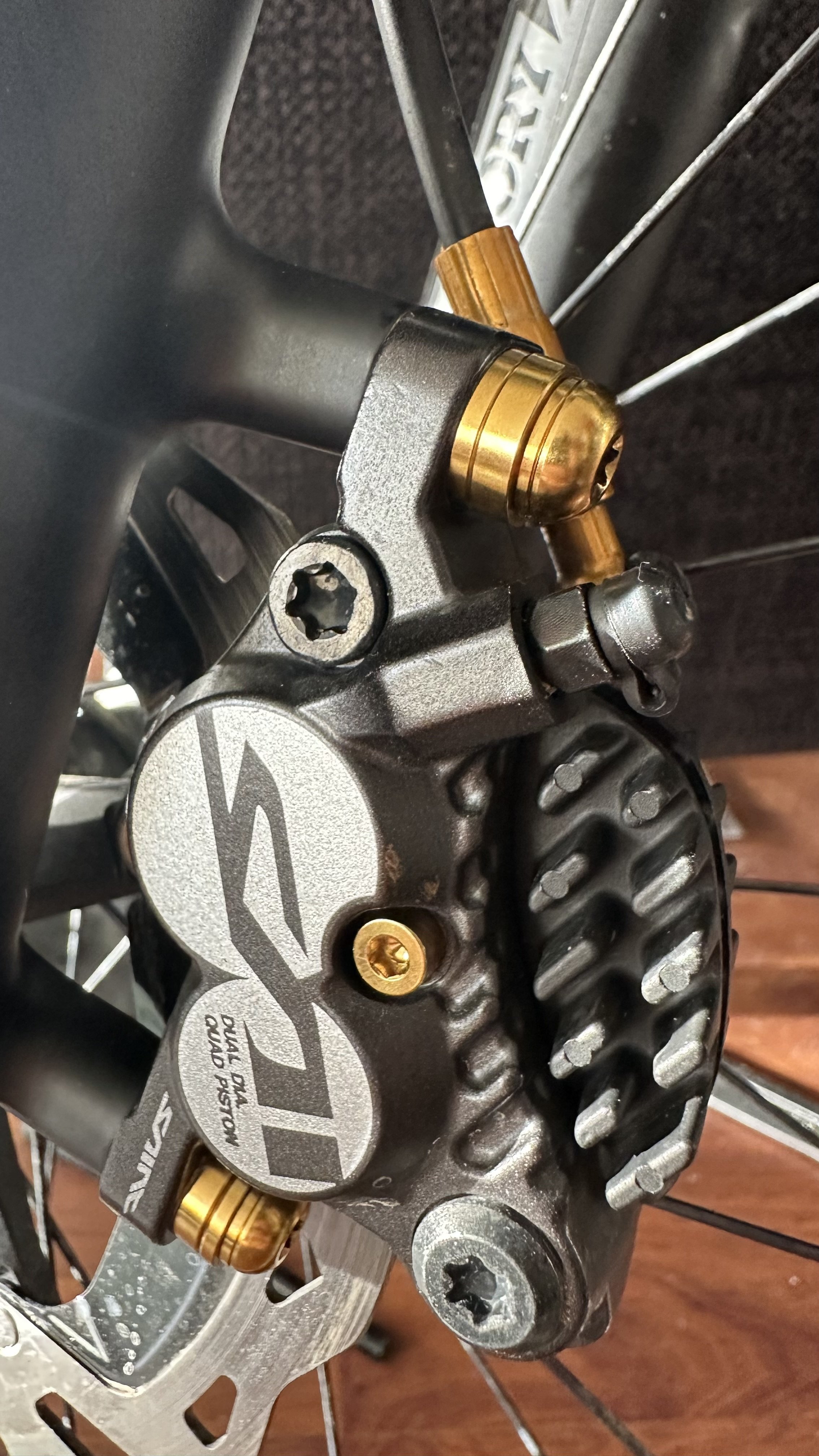

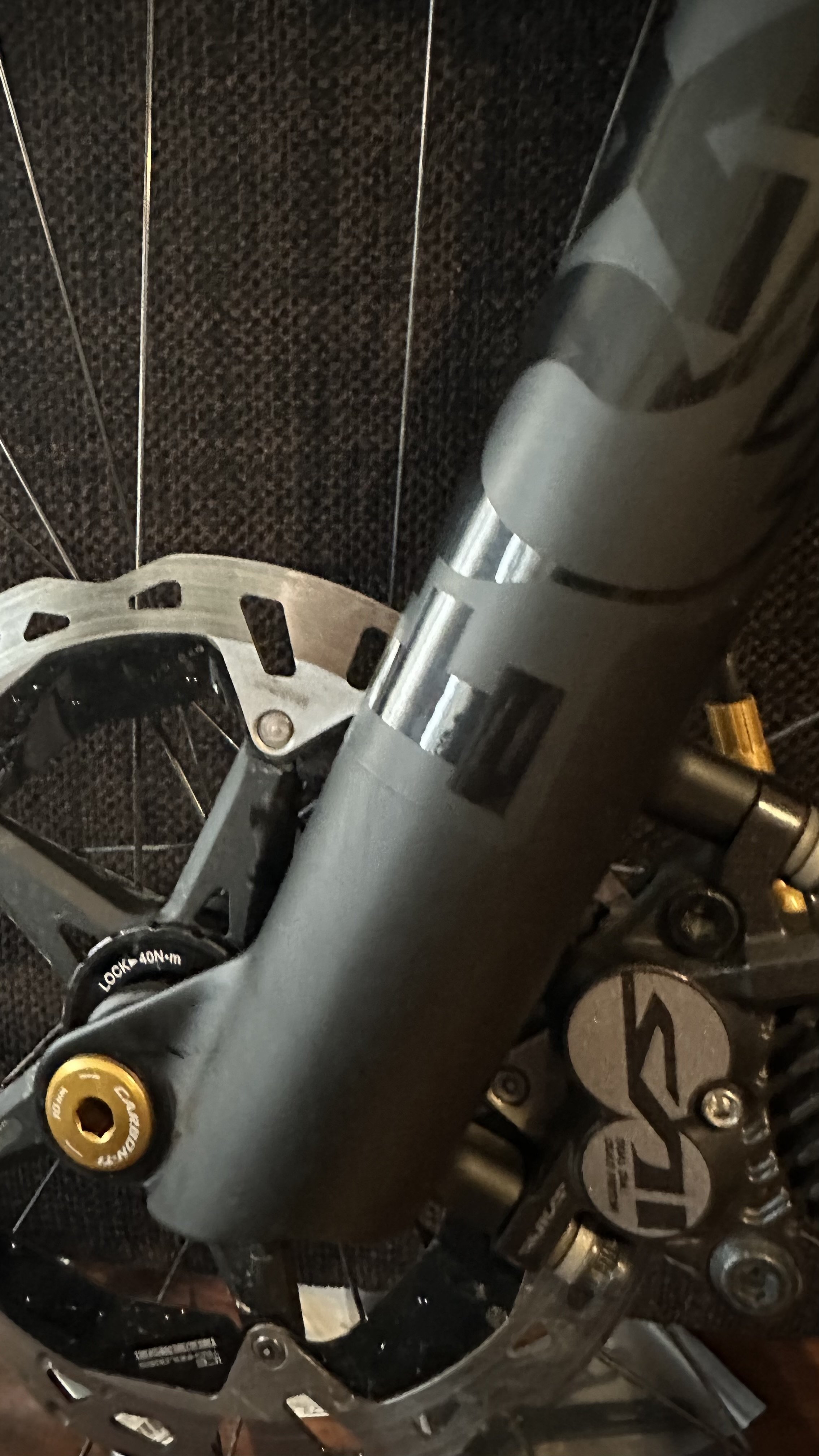

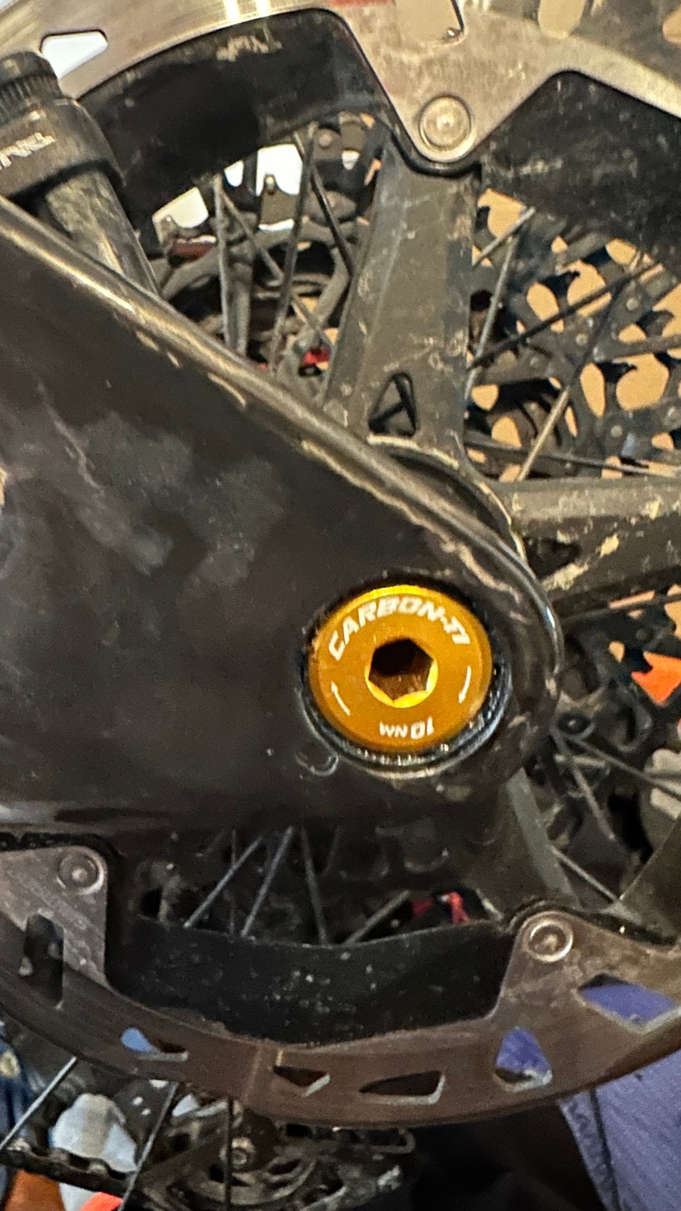

Bolts on callipers, fork, brakes replaced by titanium Better Bolts.
Thru axles front and back Carbon Ti

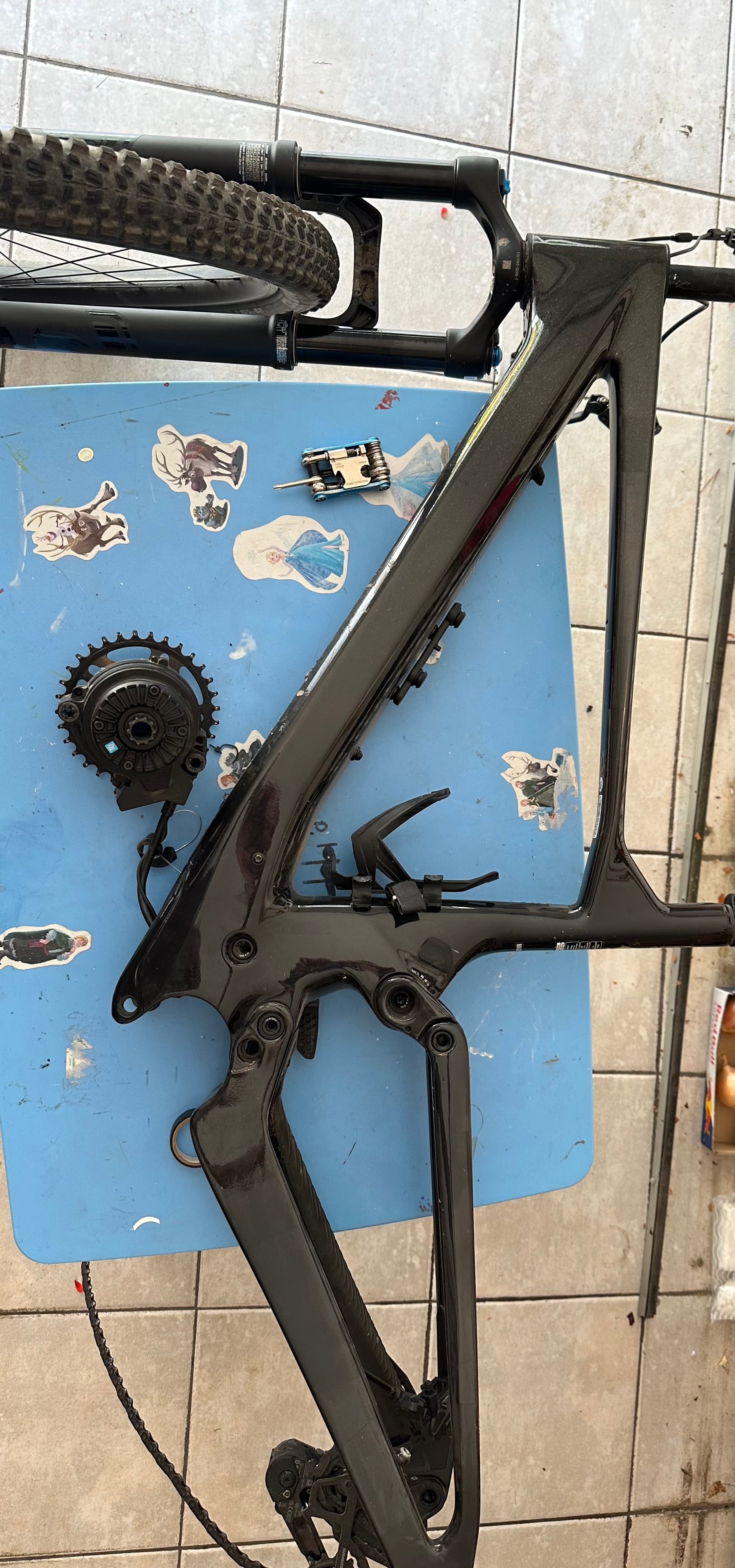

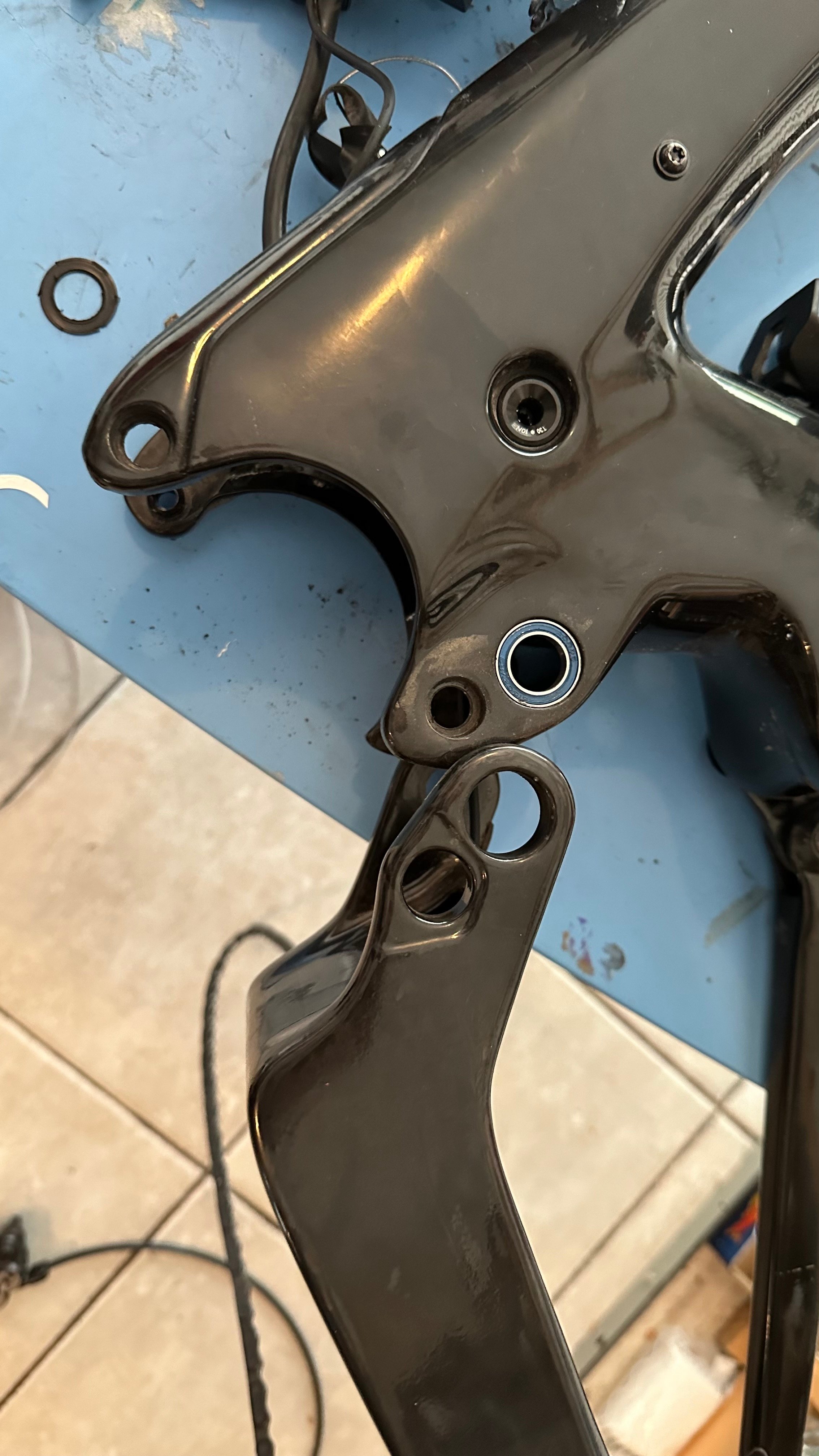

While upgrading, did you remove the motor and battery? I want to replace the brakes but guess I have to remove motor and battery. The hose is very tight and won't move along the battery.
Tomoooo
Jan 4, 2024
16
12
Slovakia
I had to remove the motor and also disassemble the rear triangle, there is such a small gap in the main triangle that I was not able to guide hose through it when rear triangle was joined. But that was maybe just me 😁
No need to remove battery. But headset and motor definitely have to be removed
(Ignore the stickers on the table 😂😂, used a table my niece decorated)

Also maybe to note, at the time when I was replacing the brake hose, I did not have in the down tube dropper and shifting cables as I am running AXS dropper and shifting, so maybe because of that there was more room.
Also the brake hose is at the bottom of the frame attached to the frame with a zip tie.

No need, you pull out the whole motor, you can even leave the cranks there. There is no need to even disconnect the motor. You just put it aside and be careful not to drop it.

I did my upgrades and modifications now as well but wondering....what torque is needed for the motor bolts? Can't find them anywhere, my guess would be about 15 or 20Nm but maybe you know?

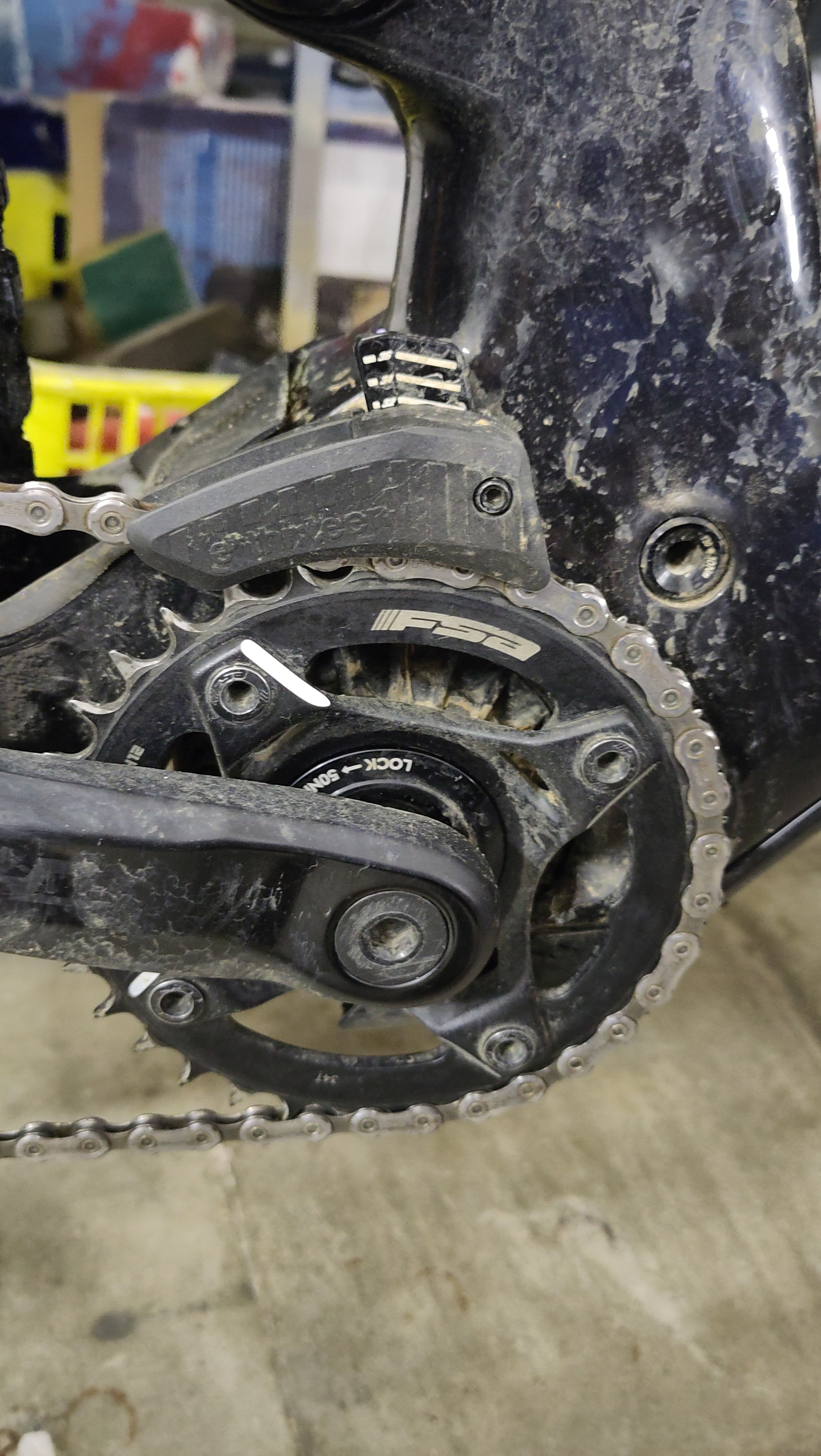

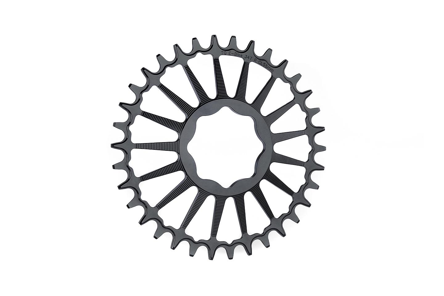

That is sweet. I also have a scott lumen 910 that Im in the process of upgrading. Do those XX cranks fit straight onto the TQ motor?
Tomoooo
Jan 4, 2024
16
12
Slovakia
rocketboy
Aug 24, 2024
ct140dn
Yeah, those are ISIS version
And to remove old cranks tool like this
For the XX cranks it is enough to have 8mm allen key
Brilliant. Thanks very much. You running 150mm forks as well. What model are they?
