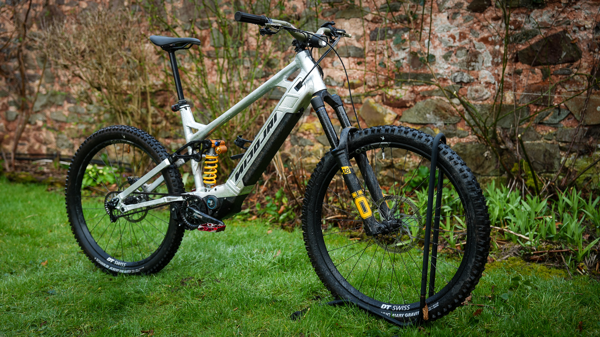

I have tried the Magic Mary Gravity on the front and Albert Gravity on the rear and I really do like them.
Also tried the Shredda Front (hated the tread pattern, too much tram lining due to no centre block) and Shredda Rear, on both rear and front, that works very very well, but obviously massively draggy, but insane levels of grip.
Trying to find the sweet spon on the ebike, I initially thought the Magic Mary Gravity both front and rear would be decent, but wanted to try the Albert Gravity out back first. And considering that the blocks are not too tall on the Albert, it offers suprisingly decent grip levels, even with the current muddy state of the trails.
I'm running 28 psi rear and 25 psi front. I reckon I might have to up it a little bit when it dries out a bit and speeds up, as I had a pretty big rim ding on the rear yesterday landing on a root after a small jump.
The tyres are very nicely damped, grip levels seem high. They turn quite well, although, can feel a little vague on the edge of the tyre (completely different to Conti Kryptotal / Argotal on the edges, which feel more locked in).
I might try them in Finale in a few weeks to see how I get on with faster rolling / rock terrain.
For now they are definitely staying on the bike (I have tried almost every enduro tyre out there over the past few years)
View attachment 154861 View attachment 154862
I agree with Conti's combo, it would be nice if you tried Schwalbe's combo in Finale.
I would get information on how it behaves in rocky and dry terrain.
